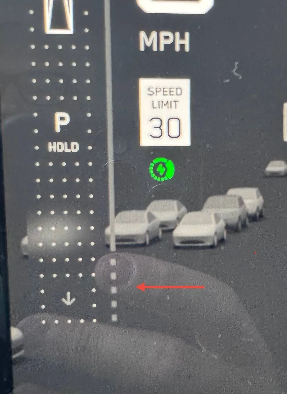

I think this icon is a carryover from the power display on some of the first models. For example our X the way it displays regen or power being delivered is with an energy graph that is round. When regen is limited it is represented with dashes in the bottom of the regen graph. It is a little difficult to see but the power meter on the Cybertruck (other models that have the meter as well) will also so dashed lines when regen is limited (would be at the red arrow in the below pic) I assume they added the green icon to make it more apparent so people are more careful. Once you get use to the distance needed to stop with only regen as soon as that is reduced it can surprise you that physical brakes are needed for the same stop you have made hundreds of times with only regen.
Model X energy graph:
Cybertruck power meter:

Was thinking that for those of you that want the snowflake to go away just set a Supercharger as your destination even if you are not going there. It will warm the battery fast and likely remove that snowflake in less than 10 minutes, my guess.
May 27, 2024
4,695
5,707
Yep, it does (and drains a few % from the pack).

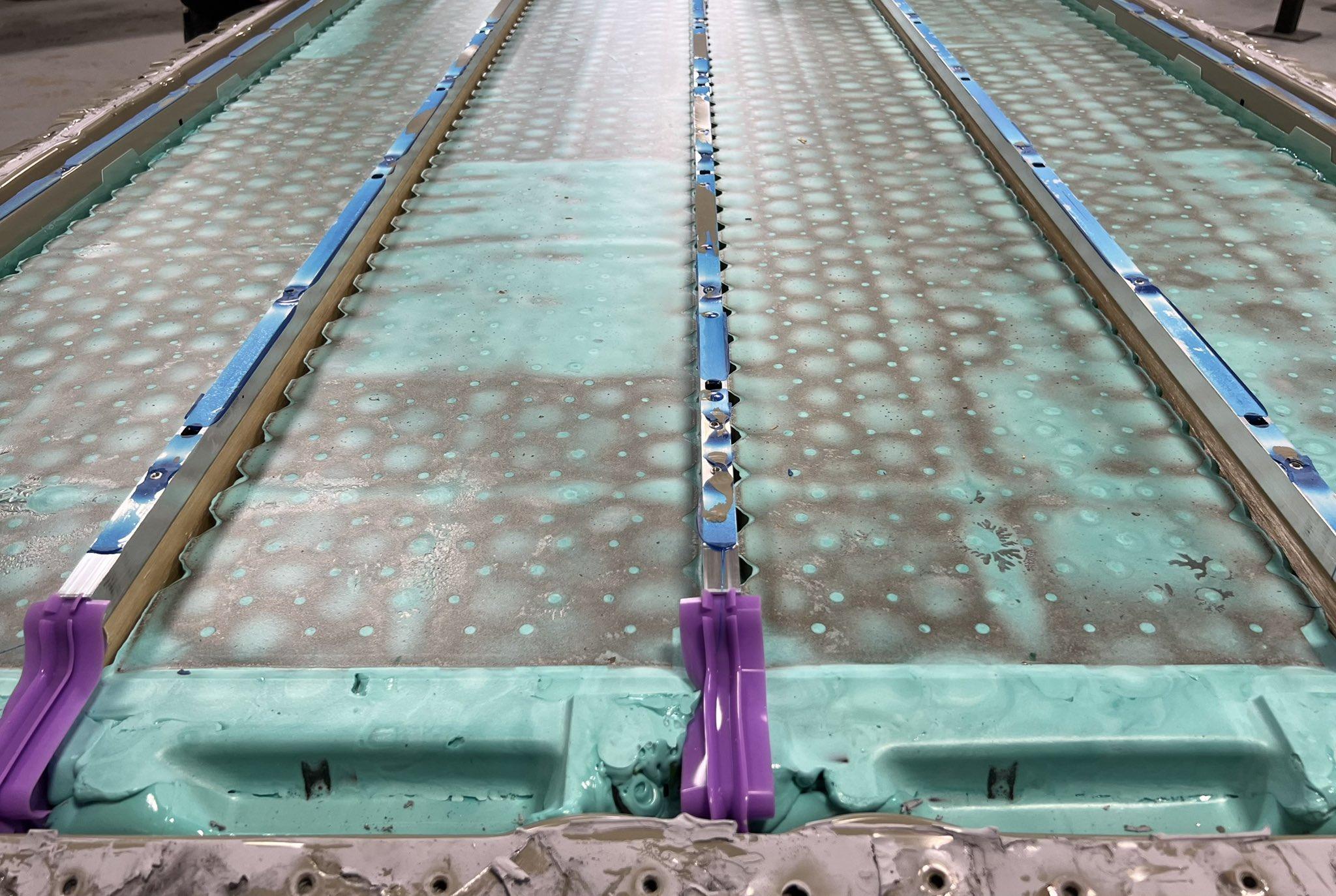

One thing I noticed from the teardown, is that there's a lot of air space (above the retardant foam) on the cells. It makes me wonder if the CT battery gets less warming from the cabin. Add to that the snowflake threshold of <65F and it's no surprise that people are seeing the snowflake stick around for hours of driving. I wonder if Tesla is letting too much heat out via the heat exchanger or into the cabin via the heat pump.
I'm pretty shocked by the efficiency of the CT (mine's about 385 Wh/mi over 4000mi) vs my 2016 Model X P100D (379 Wh/mi over 55k miles). The difference in weight, rotational mass of the tires (I had 20s on my X) and the lower efficiency of AT tires, has me amazed at the efficiency of the CT. I'm really not sure if the CT simple doesn't produce enough waste heat to keep both the cabin and battery above temp or if Tesla simple hasn't tuned the cooling system to keep as much heat as possible in cold weather.

The tear downs I've seen have the pack upside down. That air space is on the bottom which is an improvement in ambient isolation.
The cabin floor of the Cybertruck and Y is a layer of high density foam, so fairly insulative on its own. X/S/3 are metal floor then metal pack.
Munro & Co. have begun their teardown of the Cybertruck battery.
Interestingly, there is a lot of space above the cells. It doesn't appear to be enough for another layer, but it is a curious amount of emptiness. Is it needed for cooling? Could the originally-planned double-stacked pack be achieved with an only slightly taller pack?
Interesting, I didn't realize the pack was upside down.
