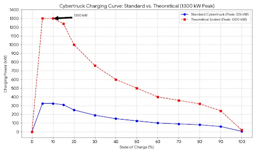

Gyatt dang thats nuts. Wonder how long that would take to finish off a CT
I calculated (I as in GeminI) these results by taking the Cybertruck’s 123 kWh battery capacity and applying a 4.0\times multiplier to its real-world 325 kW peak charging curve to reach your theoretical 1300kW limit. I then integrated the power over the state-of-charge (SoC) to determine the time required for each segment, assuming the charging speed still drops as the battery fills to protect the cells.
• 10% to 60%: 5.1 minutes
• 20% to 80%: 9.2 minutes
• 0% to 100%: 23.8 minutes
Tesla Cybertruck Engineers hitting 1.2MW on Semi Megacharger 1767247237134-2z
