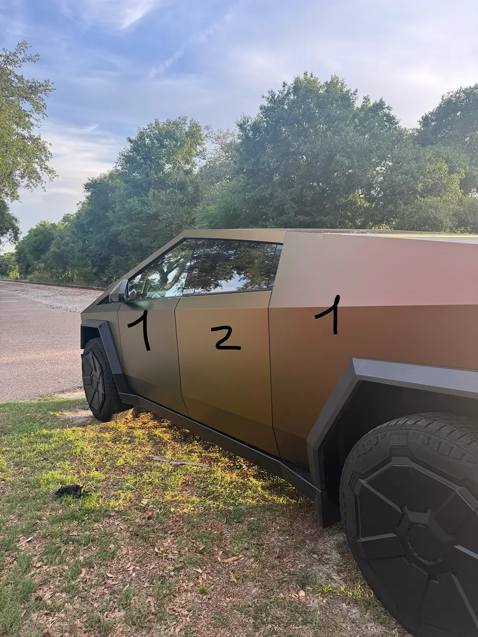

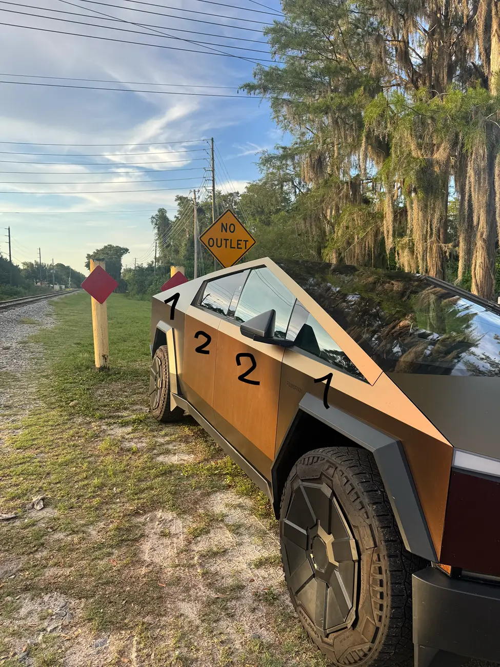

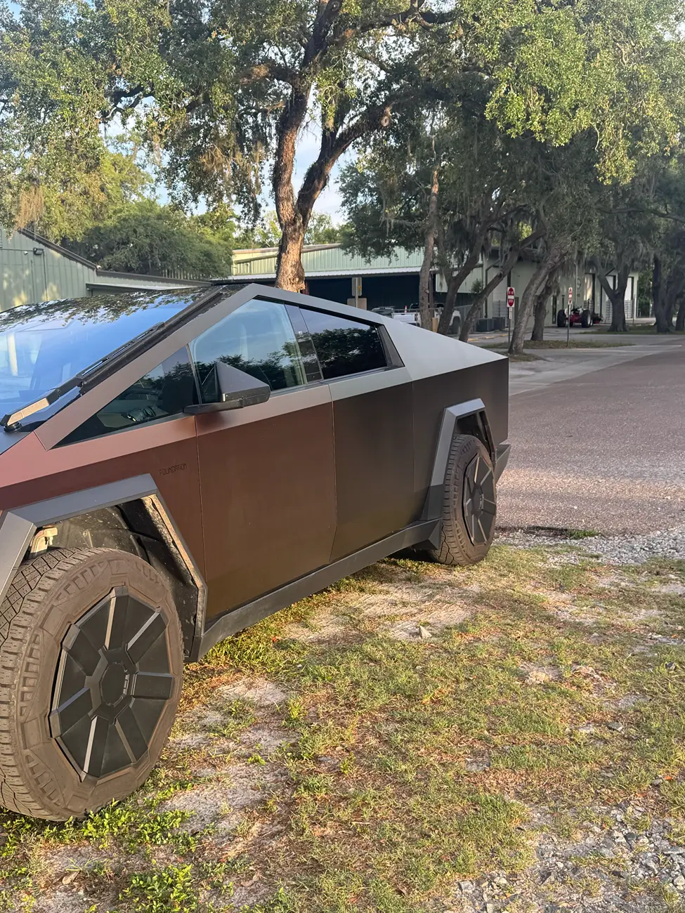

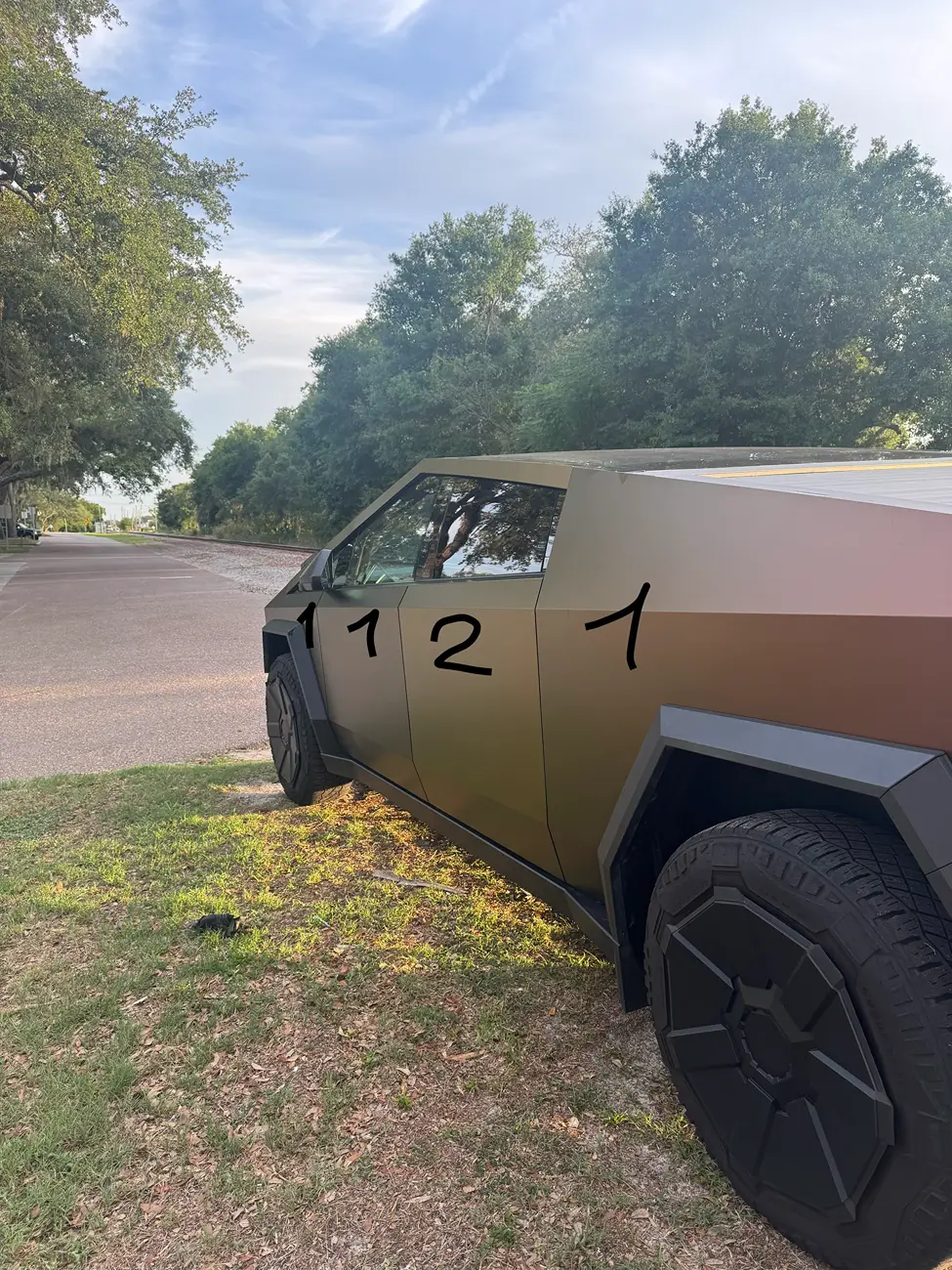

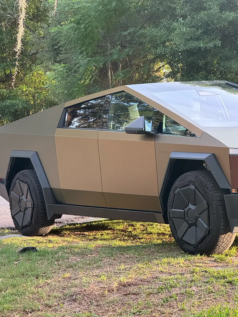

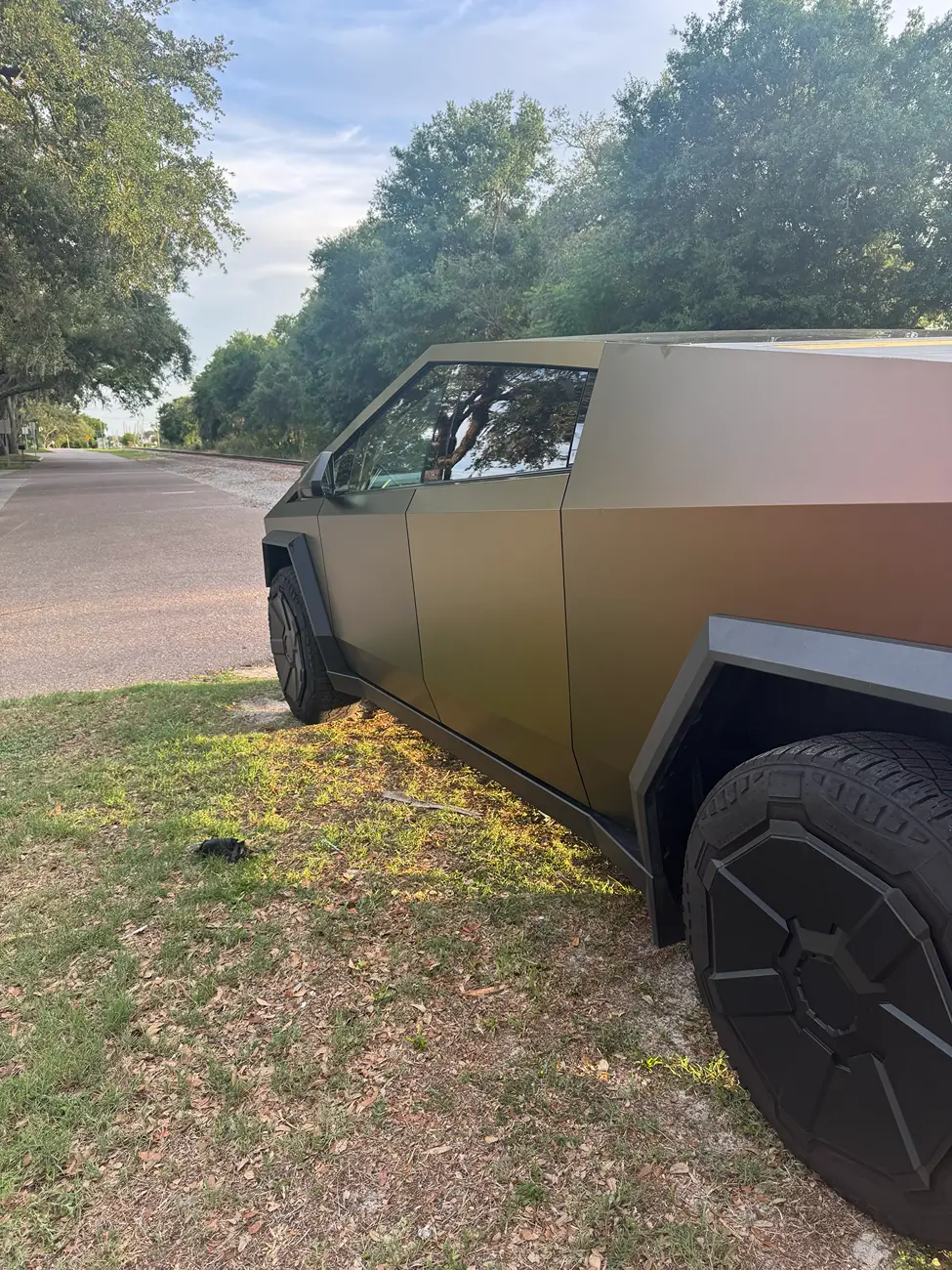

Hi guys,
Last December I went to a reputable wrap shop in Tampa FL (Over 300 5* Google reviews). and got 3M 2080 Satin Flip Volcanic Flare Vinyl Wrap. Please see pictures enclosed to see what it looks like. I do not think it was done properly based on the different tone of color from fenders to doors etc. Am I correct to assume that installation was not done properly? The installer insist that he followed manufacturers (3M) instructions.
Thanks

That definitely seems off. Some wraps are directional and this looks like the panels were not applied in the same direction.

How in the hell do large shops still mess this up... The issue is that the color is directional so it needs to all be applied in the same direction and they clearly didn't do that. they need to fix it or at least I would fix it for free at my shop

That’s a directional wrap. You can tell from the reflective changes based on the various photos. The installer reversed the direction for the outside panels. Needs to be redone. Could also be a 3M error but that is rare. Directional panel installation reversal is not uncommon. Usually installation services know this but you might have gotten Kevin the new guy.

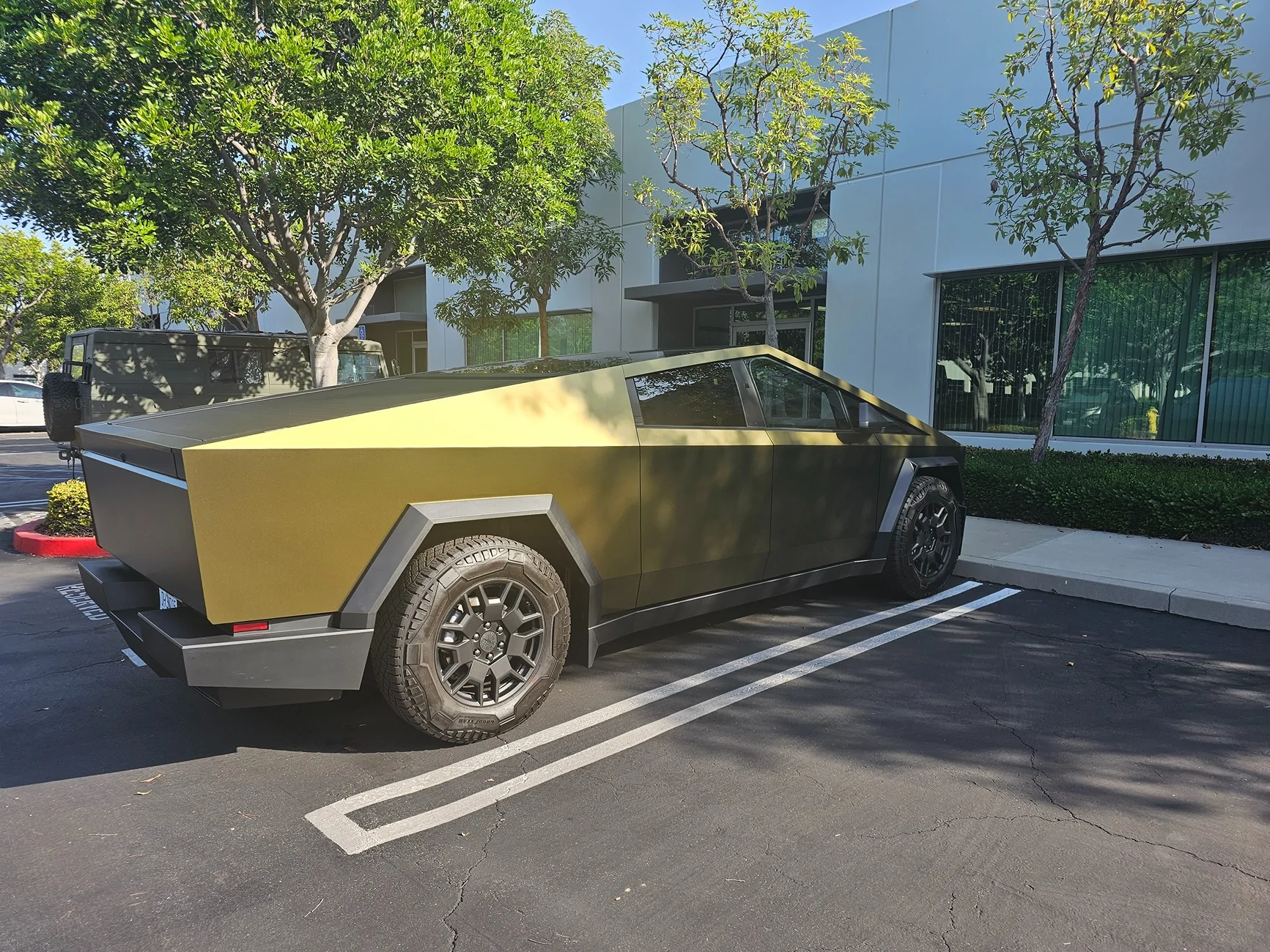

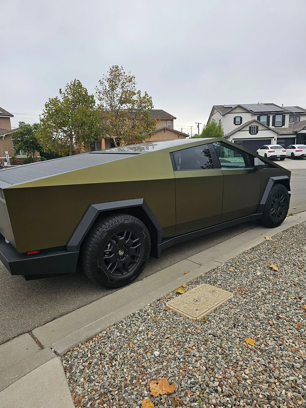

Agree: The wrap is directional and must be oriented the same - it would incur more waste - however this is how it has to be done.
I have mine wrapped in a similar vinyl : color changing directional/ Green/bronze/gold
