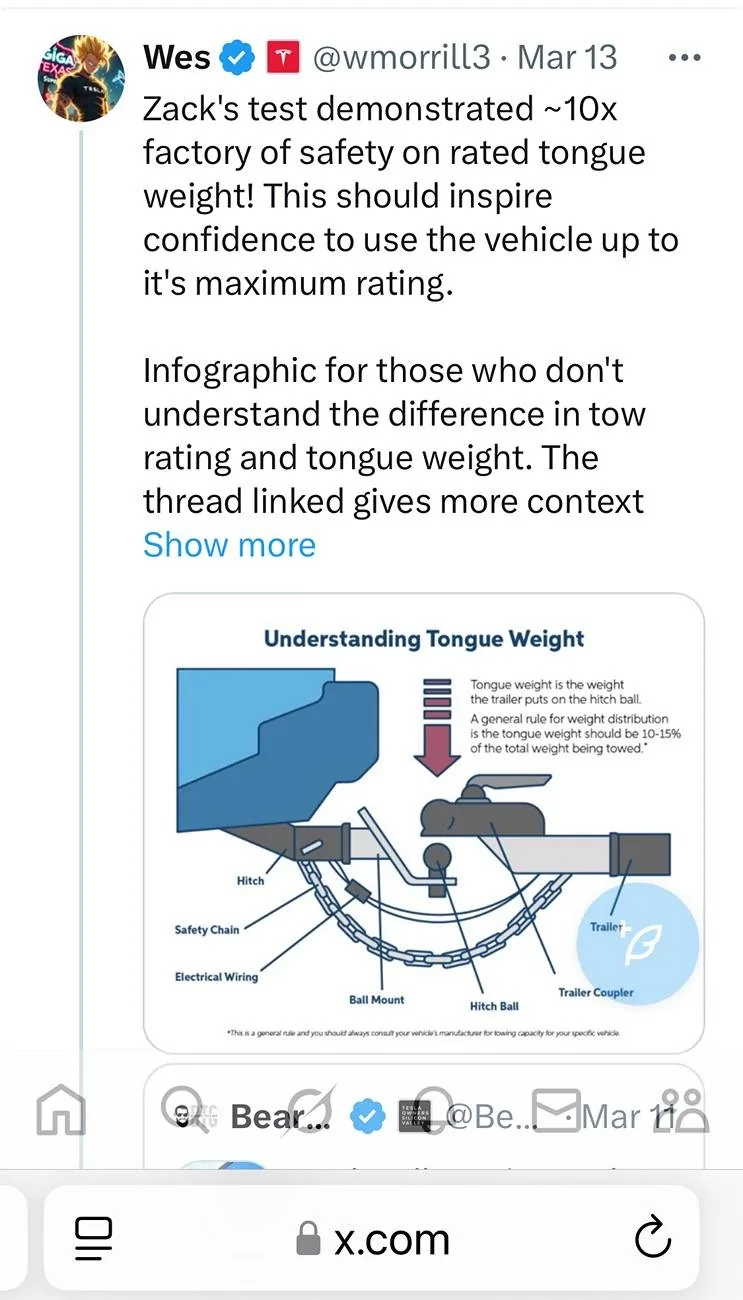

Y'all need to read and understand the following:
Check out the attached image.
What were you saying about “but it did not do "10X" anything” ?
So are you saying Wes is also wrong?
Static load rating is not the same as maximum force it's designed to handle. Loads seen during towing will be potentially much higher than 1,100lbs. Yes Jerry took it beyond that but it did not do "10X" anything

So you are saying Wes is wrong?
Wes isn't wrong, but there is some semantics that @mongo is calling out. I would suggest looking at it this way :
the max tongue weight is specified as 1,100lb, but the regulations require for there to be 5x safety factor which means the hitch should be able to handle some ~6,000lb in testing. In this unscientific test it was able to handle almost twice that, hence demonstrating a 10x safety factor.
So basically the issue issue is @mongo doesn't think the regulatory prescription already includes the safety factor, as opposed to safety factor being anything above the regulatory minimum.

Sorta, the requirement has some safety/ fatigue factor over expected force, but expected force must be greater than 1,100 due to dynamic loading. So failing at 2,200 is definitely not a 2x safety factor, nor is 10,400 a 10x factor.
Yeah. I'm also not a fan of the updated cargo carrier guidance since the pin position is not the lever arm fulcrum; and it ignores the vertical offset of the center of mass.
Yeah, we can argue about that stuff ad-infinitum. I will wait for the field data at this point to demonstrate Tesla's 11k tow rating isn't practically possible.
But that's not what's being discussed, it's the safety factor rating.
My practicality concern is axle loading on a Beast + Range Extender + 11k trailer while lacking weight distribution guidance from Tesla.
