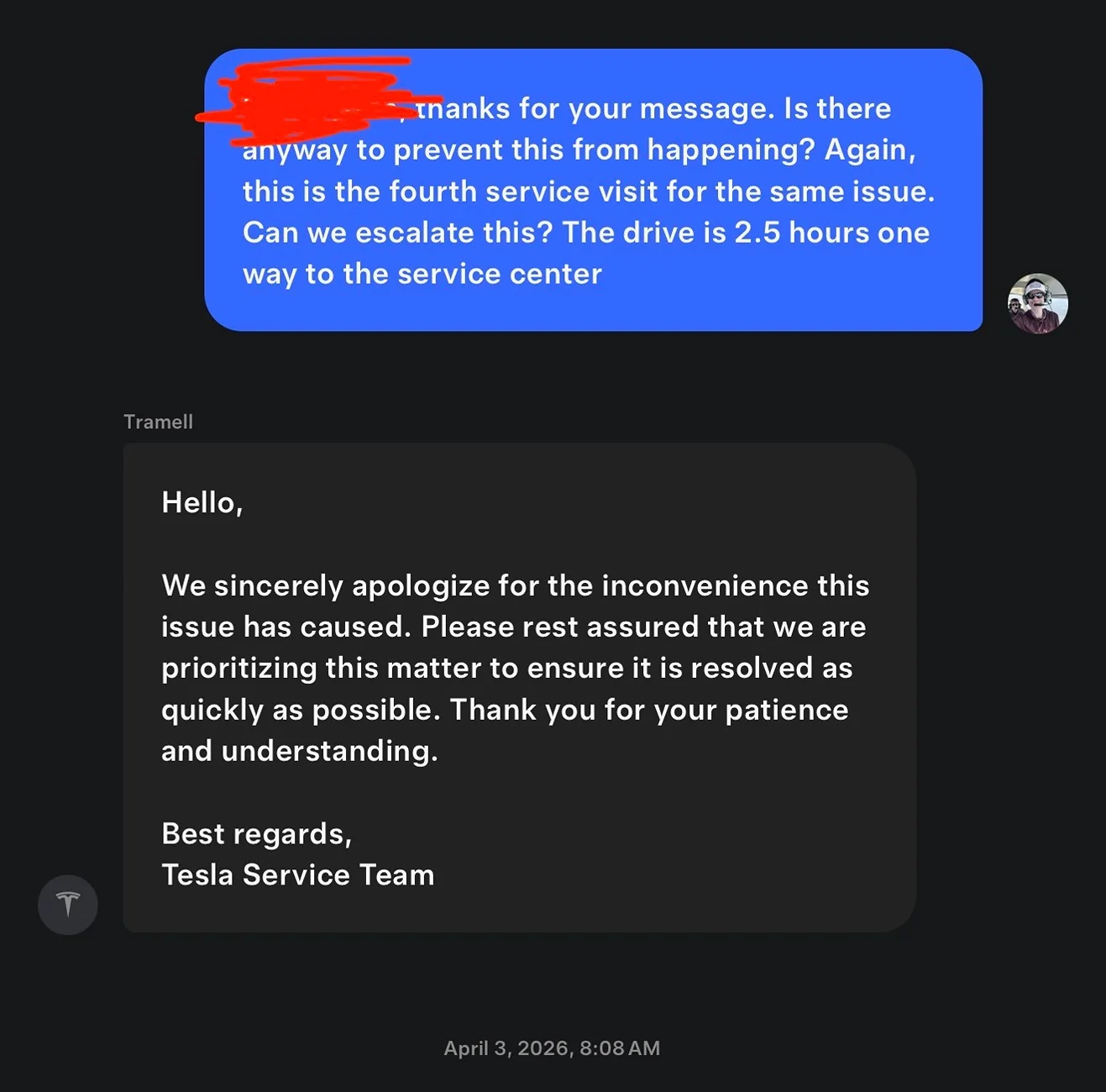

I've been dealing with Frunk opening issues on my 2025 Cyberbeast for about year now. Multiple service center visits. Have another one scheduled (fourth visit) to address it again. The service center is about 2.5 hours away from us.
The Frunk intermittently gets stuck when going to open it (either button or app). It will "hang" for a few seconds and then finally open up. No issues closing. I can hear the latching mechanism trying to do something before it finally opens. Does not happen all the time, and ambient conditions (e.g., temperature, moisture, humidity) don't seem to impact it.
More of nuisance and if the SC was closer, I probably wouldn't care as much. But for a $100k truck, I would like it work as designed. What frustrates me a bit more are the responses I get from the SC.
The latch has been replaced three times.
Any suggestions/advice?

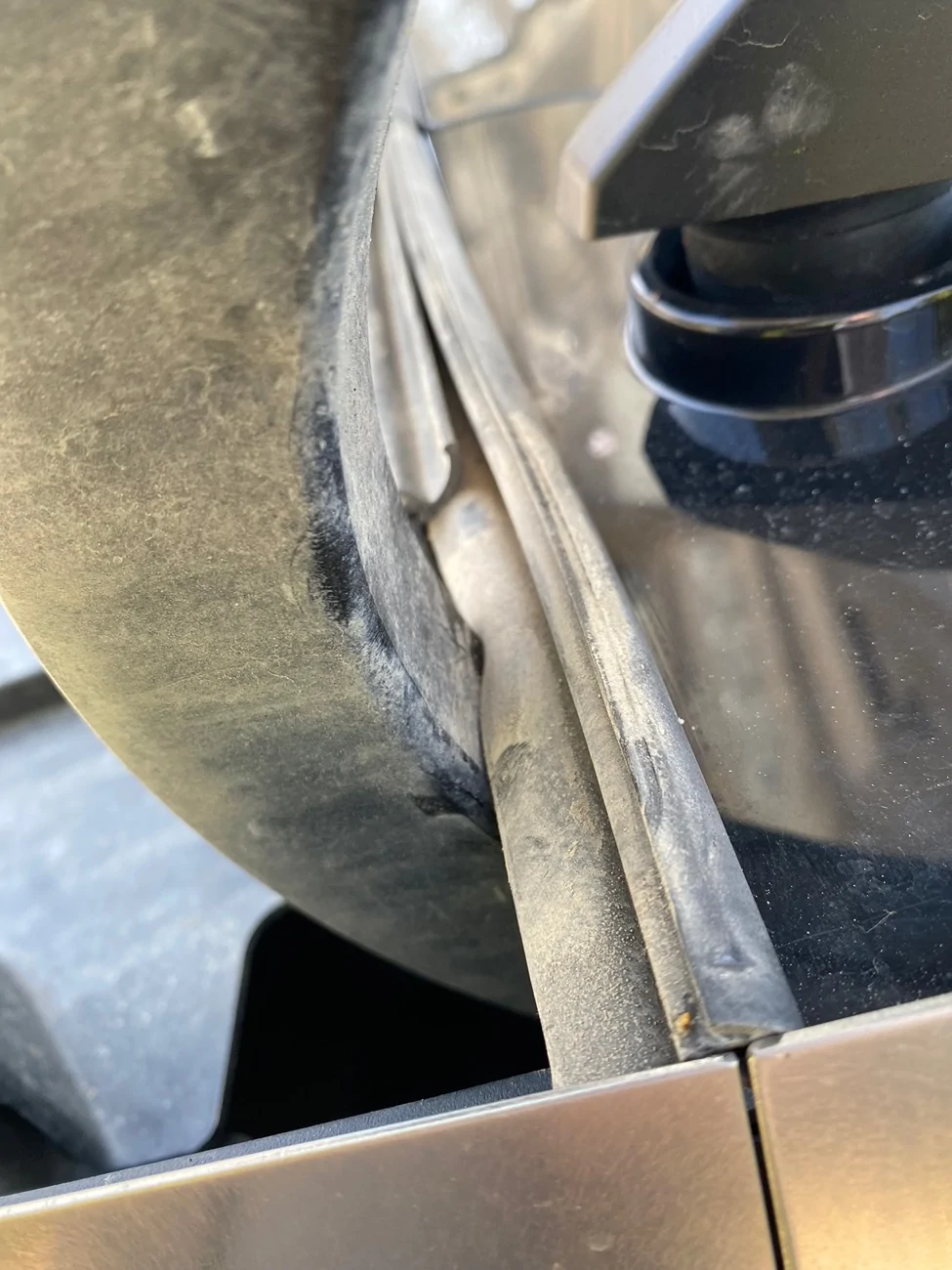

Same issue here! I actually took a picture and a video the other day and have been meaning to post it. I was thinking that it was because the driver side arm was in a little closer. As you can see, it touches the rubber at the bottom of the windshield. Is this normal, are other trucks the same? The arm on the passenger side doesn't touch the rubber so I thought this might be it.
