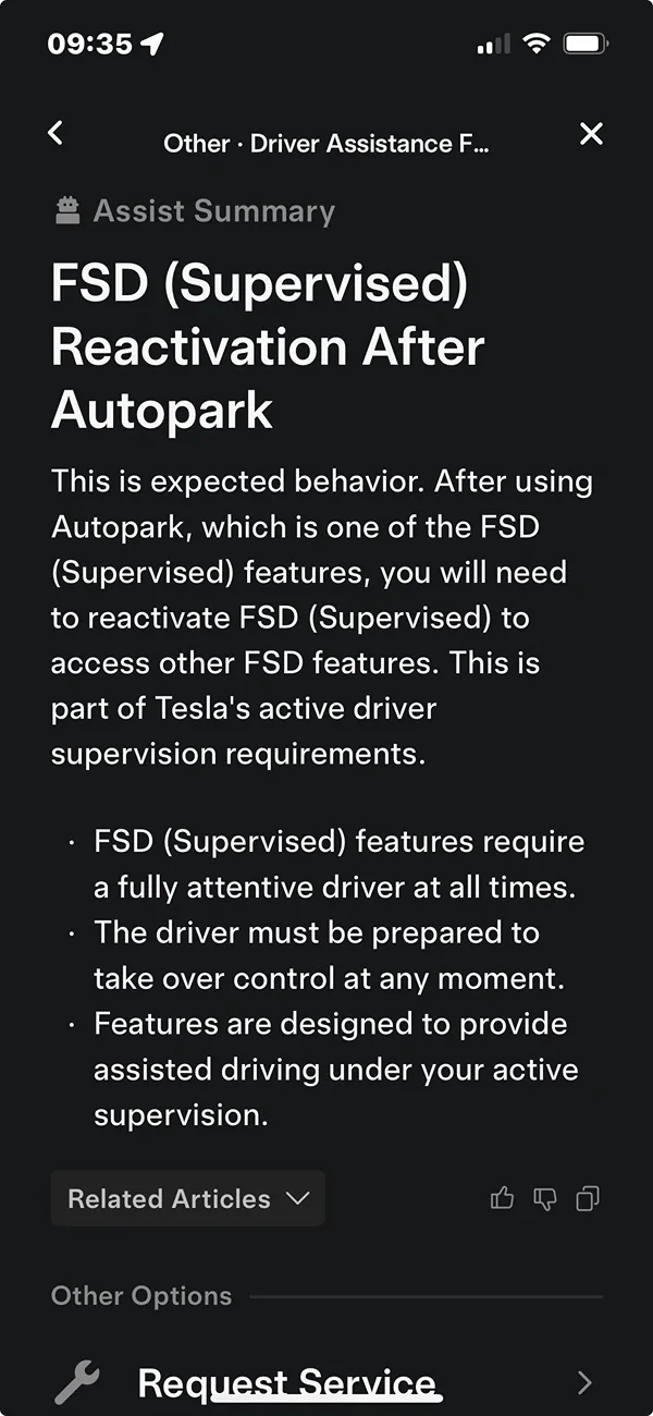

Interestingly I just entered a Service Request regarding this and got the response that this is "expected behavior". I've attached a file showing the screenshot of their response.
I have a 2023 Model Y LR and unless there has been a recent change to its software, I've not had to reset FSD each time after using Auto Park.
