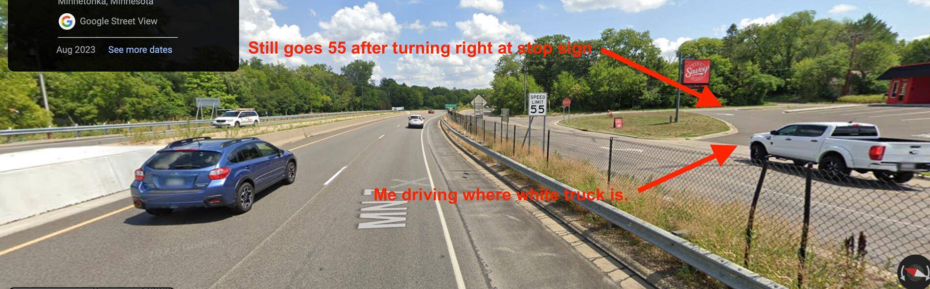

Everyday when I go on a side road (25 mph) the car speeds up to 55. Why? There is a 55 sign from the highway. But it is on the far LEFT side of the road. See pic.
Even when I turn right at the stop sign, car accelerates to 55 on a 25 mph side road. It only adjusts when it sees a 30 MPH sign a block down the road. Stupid.

And for those of you saying the signs is worse, signs are literally supposed to override map data.
