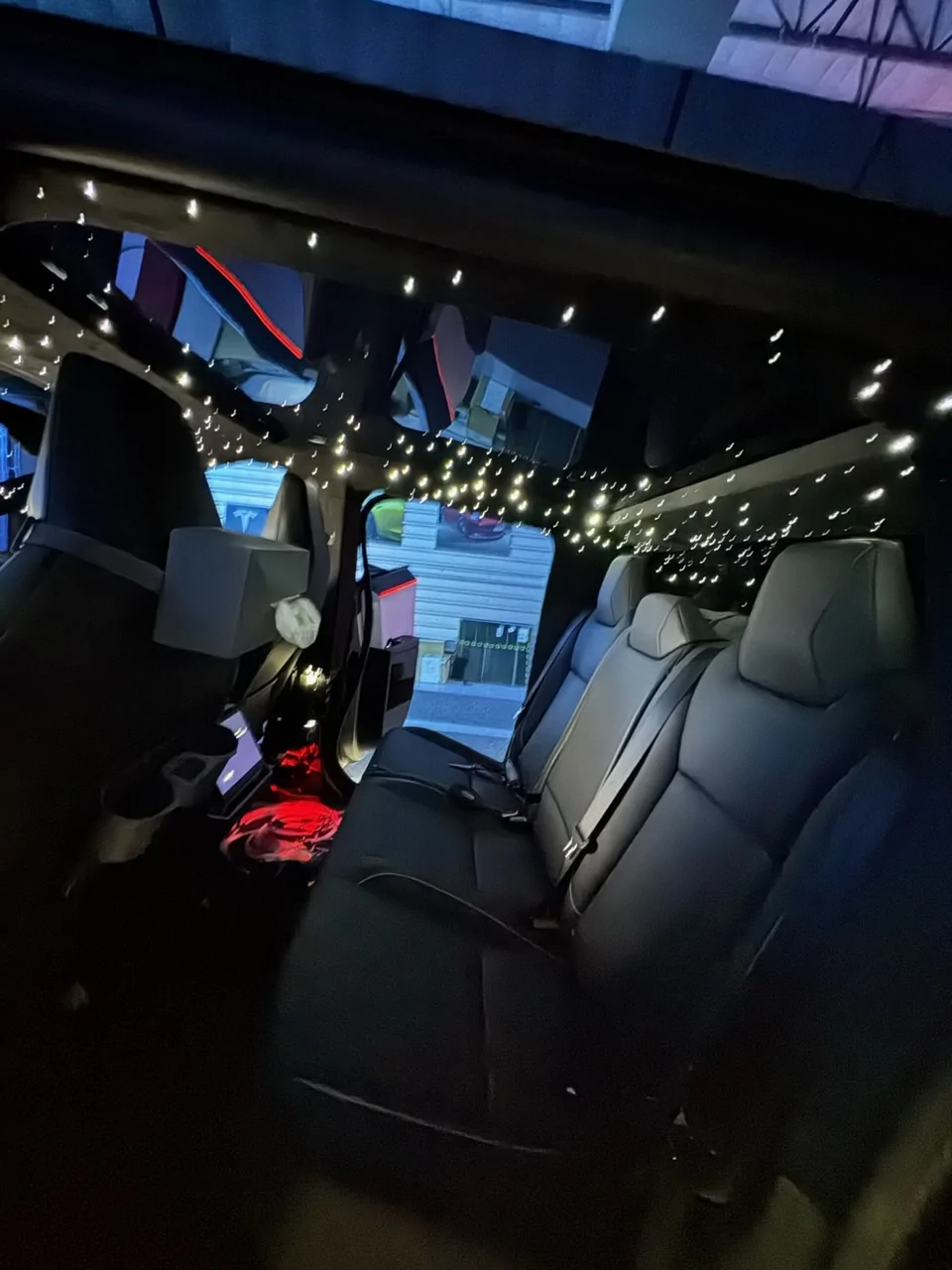

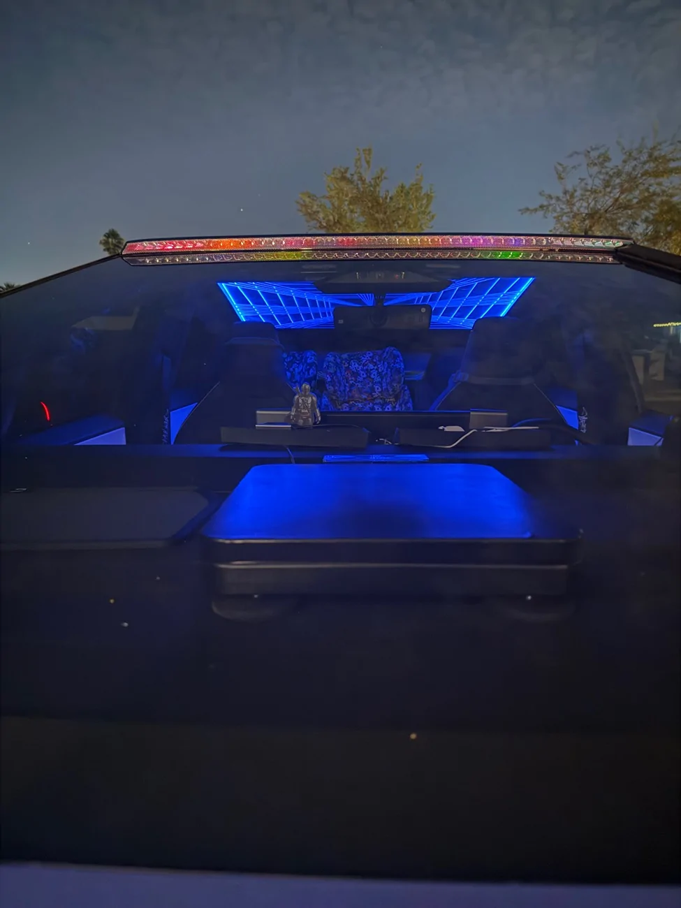

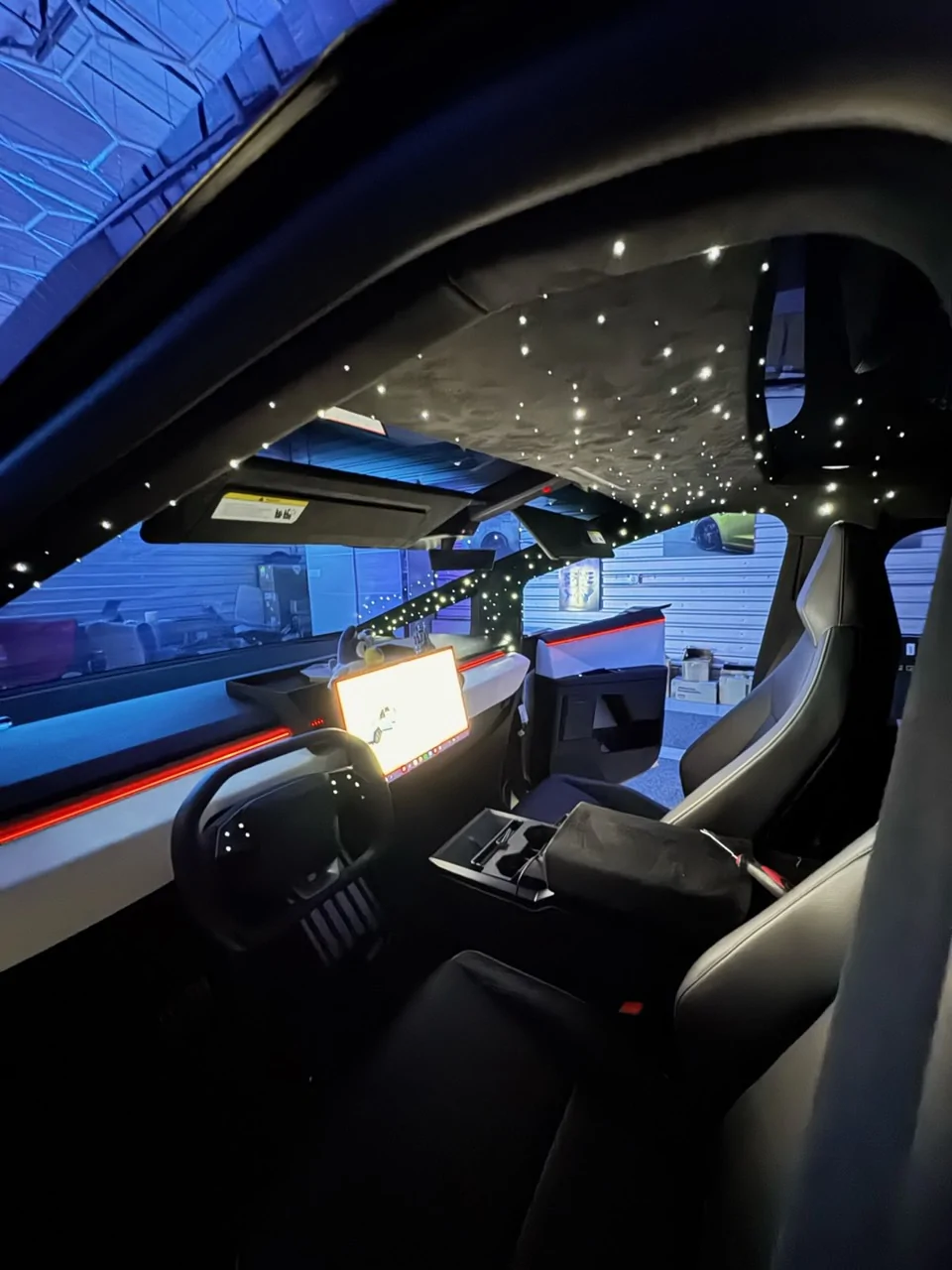

OOOH. never seen the inside of Bandit before. Where were these pics on my lights thread?
What light thread? Link and I’ll post. I have many many lights. It’s about of a hobby.
