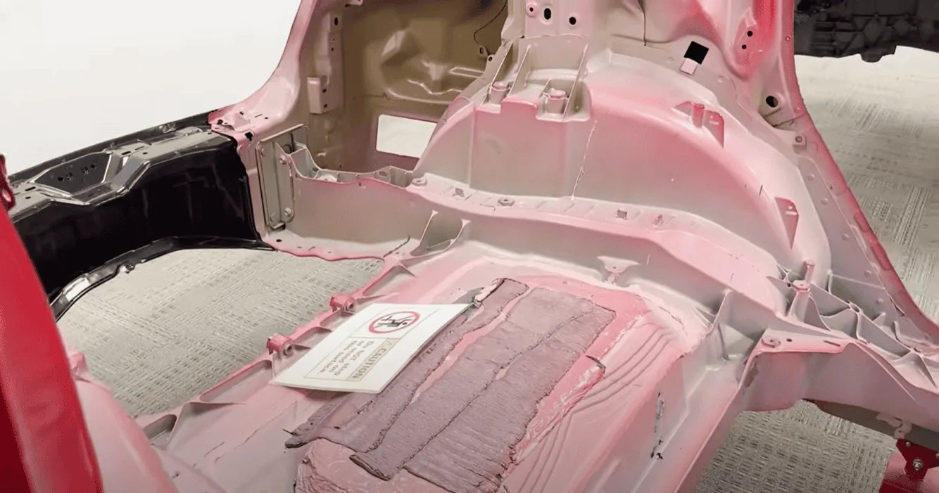

You can see in the model Y gigacast the red overspray on the interior. No one cares about that from any manufacture because it just gets covered up.

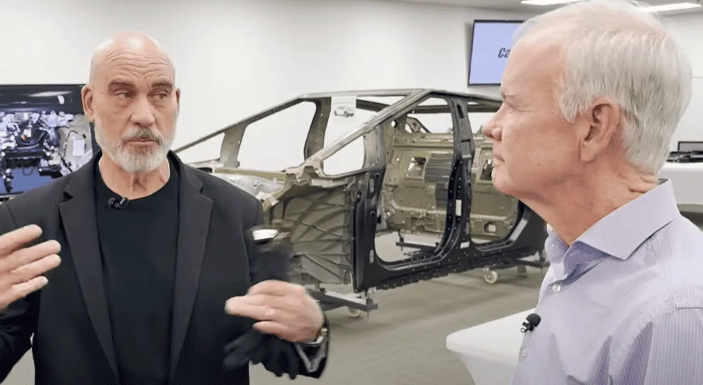

But you can see the ecoat. In the background image below the pillars are powder coated merly for cosmetic purposes. It's what you see when you open the door.
Tesla Cybertruck Full Underbody Powder Coating 1722160690626-cf
Now the entire body is matte black totally covering the ecoat. Why? Just like the model Y and the over spay you'll never see it. Underneath you'll see the battery but that's it. It looks fucking cool though.
