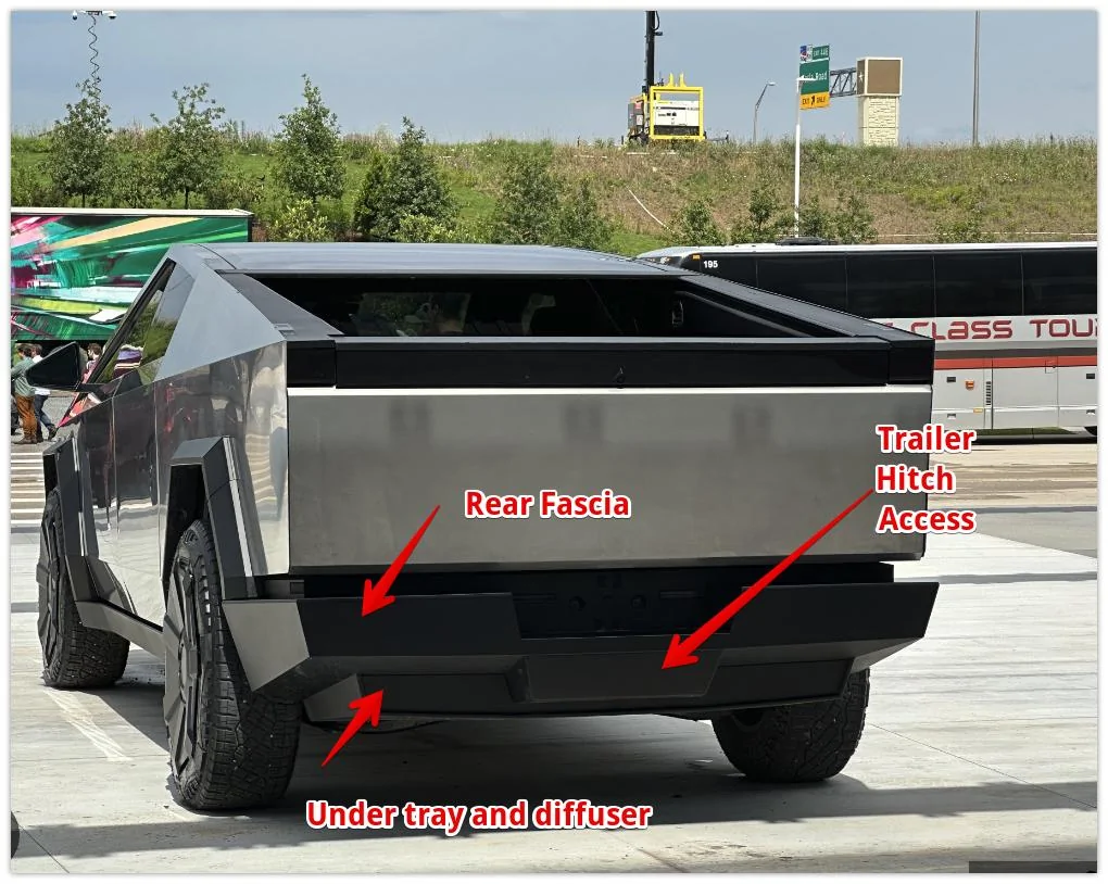

Tesla Cybertruck Mystery of rear underbody… tesla cybertruck rear bumper - Google Search 2023-12-20 16-06-38

The "under tray diffuser" is to reduce drag on the rear by keeping better control of the under vehicle turbulence until airflow separates from the underside if the vehicle. In the rear it's all about trying to keep airflow attached as long as possible, and to make sure the recombining of air doesn't produce unwanted pressure zones or turbulence. This is unlikely to change because of this.
The underbed storage does not go that low, and there is space under there for the yet unannounced wireless charger module for home charging.

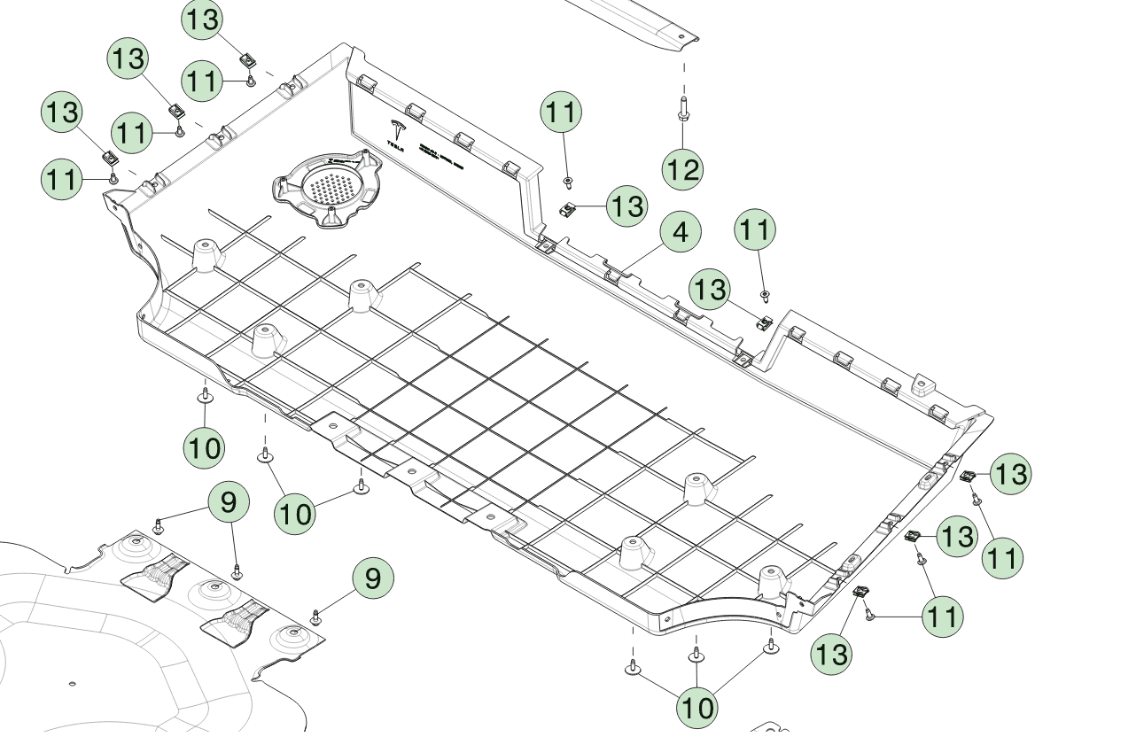

Worth noting the diffuser is not one piece with the rest of the bumper, meaning it shouldn't be that hard for the aftermarket or even Tesla, though unlikely, to come up with a 'diaper delete' for those that are willing to forgo the aero benefit and possibility of a wireless charger in favor of better departure angle and looks.
Tesla Cybertruck Mystery of rear underbody… diffuser
In general I think there is an opportunity to use the rear bumper, the rear defuser, and voids around that whole area, to come up with a enclosed volume that can double as a water tank, for a camper build for example, and integrate 1 or 2 swing out arms for spare wheels, along with a choice of departure angle or aero choices. Or alternatively for use as extra bouyancy for boat mode or water ballast for certain terrain. It's probably the only available partial void to do this with. The front bumper area needs to duct air for the front radiator so is unlikely to have any useable voids.

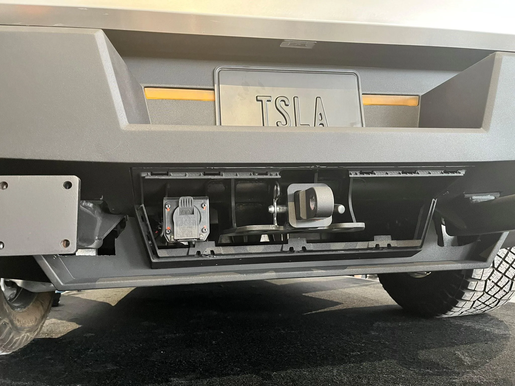

Here's a good look:
isn't that the receiver on the left of the pic though? Looks like removing the under tray doesn't help departure angle because the receiver is hanging down anyway.
The angle of the photo is a bit misleading, makes it seem like they are at the same height when they're not. It's not a night and day difference but it should result in a decent improvement.
Couldn't find a clear photo of the current version in my repertoire but here's one from a quick google search. It's an earlier prototype but it illustrates the point:
