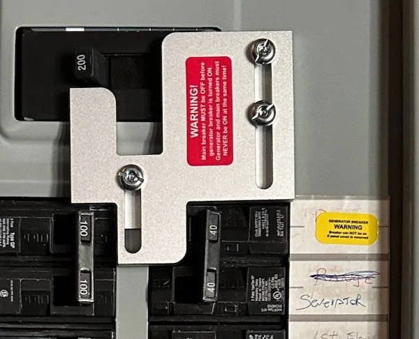

But, if your power source, ie generator or CT, can meet the load of your house, then you don't have to choose your circuits, you can power the whole panel, with an interlock.
Cheaper parts, cheaper install, simpler, almost the same process for the homeowner to turn on and off.
I had a 12000 watt automatic standby generator, that failed after 12yrs. My original plan was to install a PowerShare which was also 12000 watts, but there was no certified installer in my state. I could replace the standby generator, but since my CT is almost the same wattage, 9600 watts, I felt it should have little difficulty in powering my house just using an interlock and a plug from the truckbed outlets.
The electrician installs the little odd-shaped metal piece, called an interlock. You see how you have to switch off the main breaker, 200amp, at the top, to then slide the interlock up. When you do that, the 40-amp breaker on the lower right, then can be switched on. That is connected to the 50amp receptacle that goes to my CT. The main is off, but the panel is safely energized by the CT or portable generator. It's a simple device.
This is virtually the same install that an electrician would do if you asked for an interlock with a 50amp receptacle for a 10000 watt portable generator. It's nice, because it's not Tesla-specific. You can buy a 10000 watt portable generator for $1000 and power your house that way, or use your CT. Same cord and everything. You don't even have to tell him that you want to use your CT. It's nice because you shouldn't be ripped off for such a generic install.
Now, the 40amp breaker is a mistake. It should be a 50amp. The continuous load is 40amp. My electrician must have been confused, or only had a 40. I'll get him to swap a 50 in.

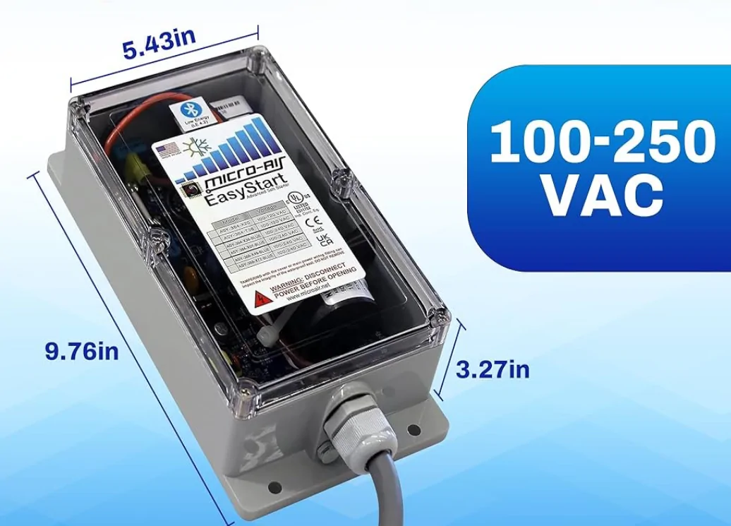

Does your a/c unit have a soft start installed?
Not sure, how would I find out? And if not is that something that can be installed?? Thanks man I appreciate your response, trying to get this all ready before we get hit by a hurricane this year!

Every AC compressor has a LRU rating, which is the peak amperage at startup. The limit for PowerShare is LRU 110, I believe.
Even though I was just under this limit, I self-installed this "soft start" anyway. It reduced the measured startup current to about 30A, which helps with voltage sags or possible overloading of the 11kW PowerShare limit. Theoretically, it also reduces strain on the AC unit.
Tesla Cybertruck Instead of PowerShare, I installed an interlock and 50amp receptacle... IMG_1336
I’m sure there are similar units.
Some modern A/C units may have this integrated, but then they would have a low LRU.
Have you ever noticed any lights or appliances dimming or struggling momentarily when you A/C kicks in? If so, you likely don't have one installed. They are generally around $200ish and can be DIY installed if you are handy. Tons of Youtube videos out there that will get you going.
