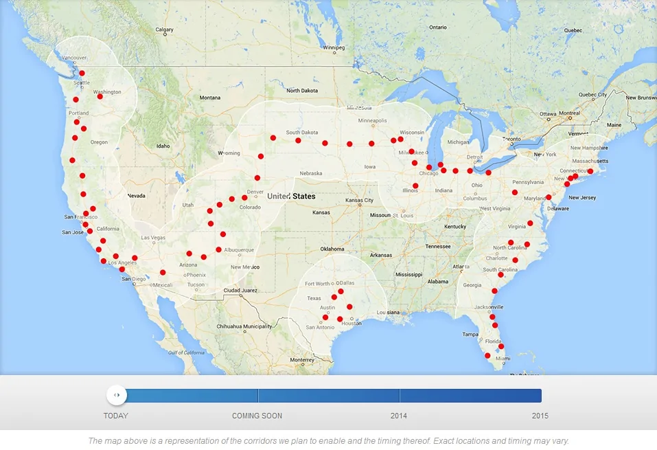

The 30 amp adapter never hurts. Sometimes the 50's are limited. 2014 was so cool driving from campground to campground across the USA.
