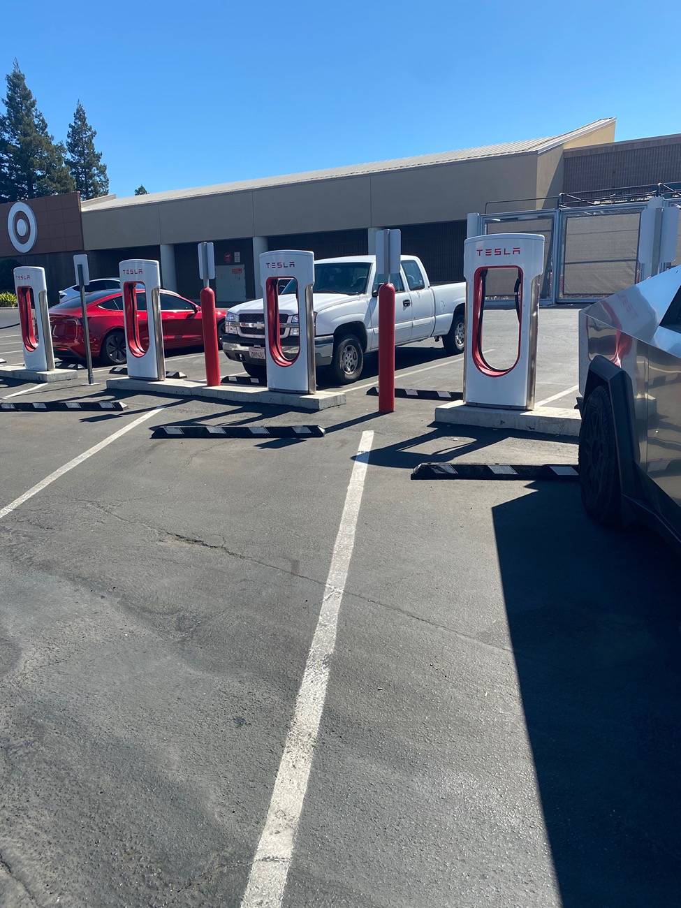

Do you man your Cybertruck which appears to be on the wrong side of the Superchargers? i.e. signs facing the other direction?
Well I guess I can add you to that jackass list lol. No I am not on the “ wrong side” just the other side since at the time the connector would not reach my charge port due the placement on the truck and the other cars that were there.
Sorry I did not snap a “ before “ pic of the situation.
So a closer look indicates that you are on the wrong side and you are straddling a line.
Yep, you didn't block a parking space.

As so many of the "look at the idiot blocking the Supercharger" pictures are:
