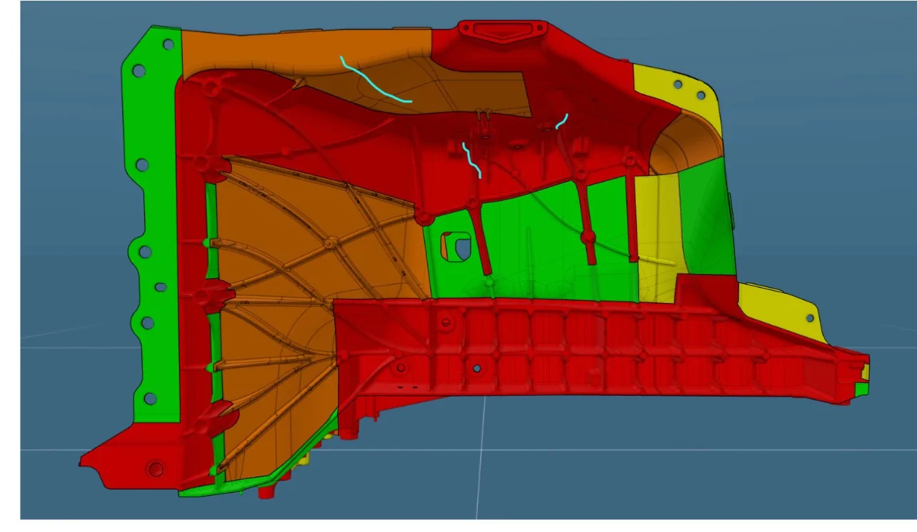

gigacast is ment to fracture in spots, they can cut affected spots out and bolt on replacements.. maybe you get lucky and get it totaled would be my hope.
I think that's only in the front and rear crumple zones. That was a pretty good sideways impact directly to the front wheel into the heart of the front frame.

I added blue lines where I can see cracked areas. I really would wish they could just replace that giga cast wheel area entirely and at a rate insurance will not total
I really worked hard for my CyberTruck, waited the 5 years and by a miracle was actually able to make it happen. I’ve lost my career since and things have been hard, I’m using the truck to make my income daily not commuting but apps and gigs. I don’t know if I could get financed again my credit is about 630 vs 700 when I got the cyber in 2024. This is my most loved vehicle and I really am at a heart loss.

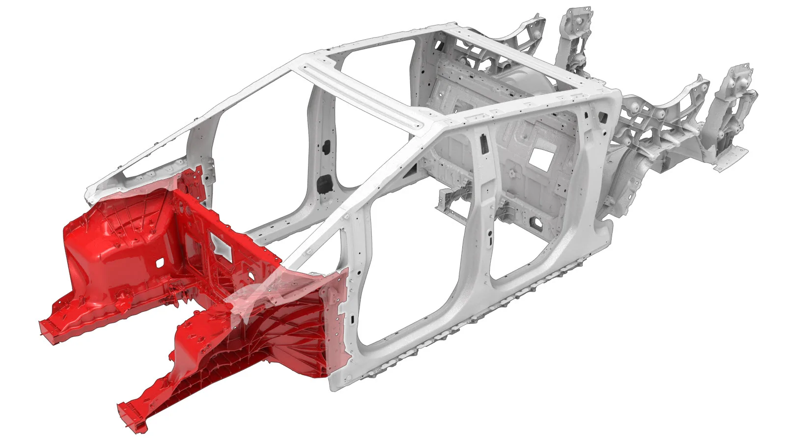

The gigacast assembly for both sides is only 2k, and it can be delivered in 10 days.... insurance better not drop the ball on this, thats a no brainer replace it!

the documented Flat Rate Time (FRT) for the "Chassis Structure Assembly - Front (Remove and Install)" procedure is 2.10 hours (correction code 3001064012) and 2.46 hours (correction code 3001064011).
the documented Flat Rate Time (FRT) for HV Battery (AWD) (Remove and Install) on a fully assembled vehicle is 6.55 hours (correction code 16010201).
A separate "Remove and Replace" procedure (which includes additional steps such as flushing, detailed preparation for shipping/replacement, and related tasks) has an FRT of 8.30 hours (correction code 16010202).
ESTIMATED LABOR HOURS: 16-22

FRONT GIGA CASTING
$1,895.00
sold by Tesla; Requires VIN
