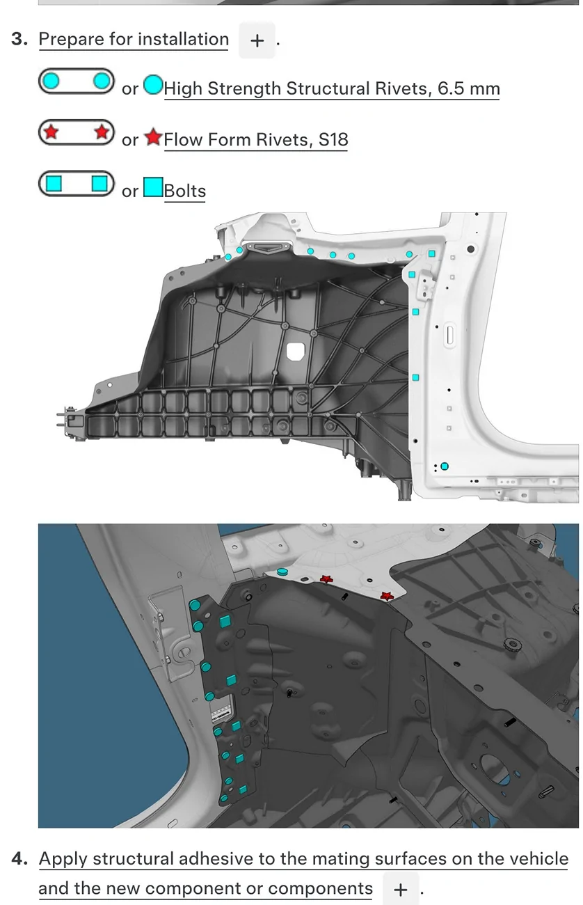

They’ll glue the cast
I doubt it. The repair with glue is to replace the area around the crush cans, but this collision damaged the area supporting the shock tower (and thus, supporting the weight of the vehicle). Replacement of the casting is the only real option.
In JerryRig's video, the shock tower supports were not damaged, making glue feasible.
A hack might try to weld small cracks, but cracking means the shape was deformed and the truck would never drive right with such a repair.
New casting gets rivets, bolts, and glue.
Of course. I meant they cannot "glue it back together" like your mom's broken vase when you were playing football in the house :LOL:
May 27, 2024
4,625
5,631
Well, yeah that wouldn't fix deformation, and @kpanda17 wasn't talking about that. They were referring to gluing in the new casting.
