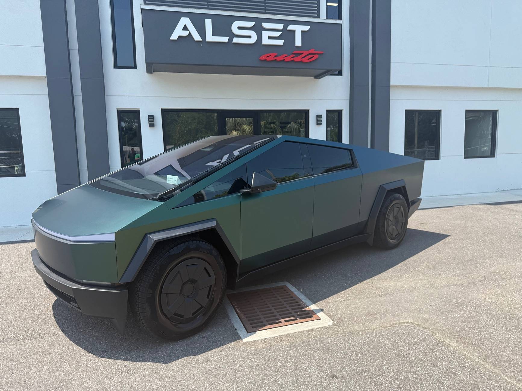

Got wrap done this week picked up today and left fender camera not working. I tried the hard reset and the secret menu and no luck. Not sure if there is an easy way to check if they left something unplugged. They are closed for the weekend. Any help and guidance would be appreciated.

You may just need to run the camera calibration. Mine stopped working after getting a wrap as well. They disconnect the cameras and when reconnected they have to be recalibrated.

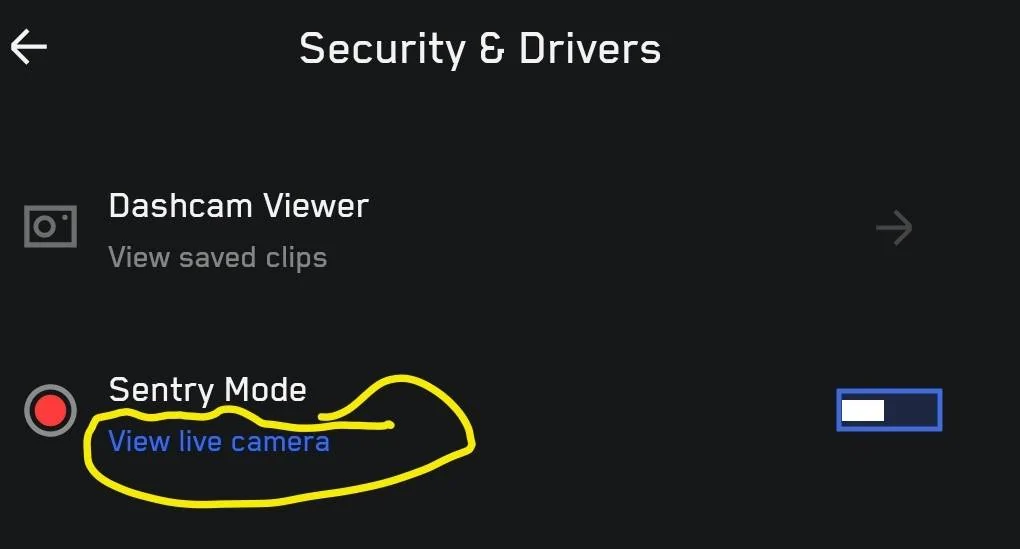

You can check the cameras in the app. They might not have plugged the fender camera back in when they removed the fender.
That’s my thoughts too it’s just showing up as a black screen.

Pop off. Reconnect. Etc. wouldn't hurt to also then go into service mode and rerun calibration for entire truck again.

The trim with camera removes easily. It just snaps off!
