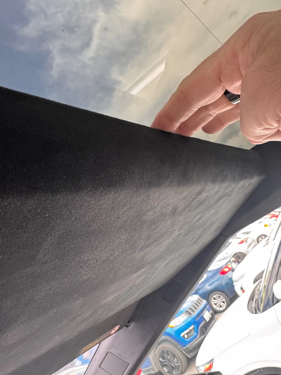

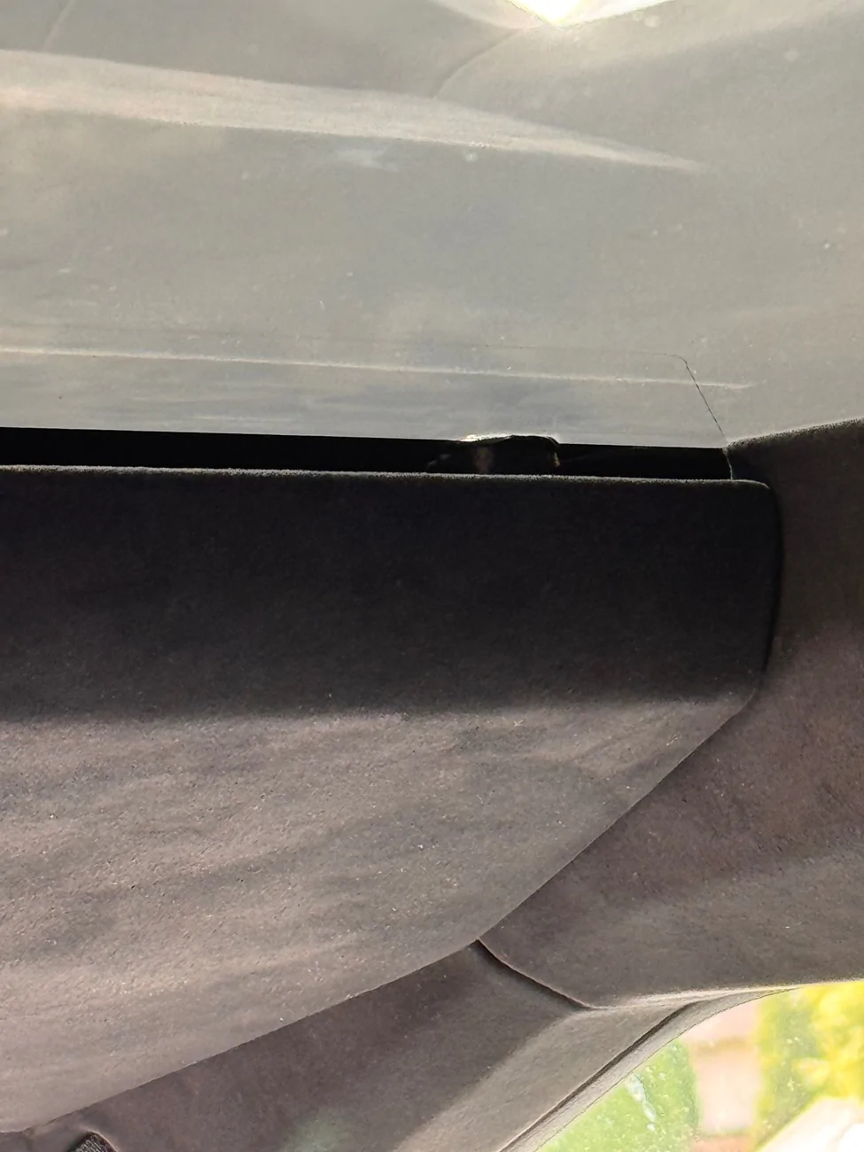

Has anyone else had any issues with there headliner coming unclipped ??
I can push it up and hear it clip in but it lets go again within minutes.

It’s the white clips in the front that are most problematic. They are easily bent and have to be lined up with the big white saucer looking things.
Recommend pulling it down a little further so you can see them all and straightening them out with your fingers and then lining it up and pressing up on the cover one clip at a time.
