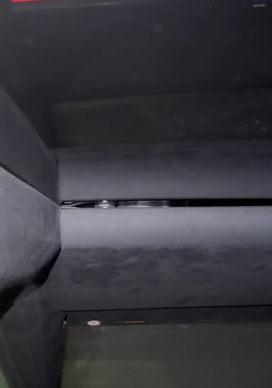

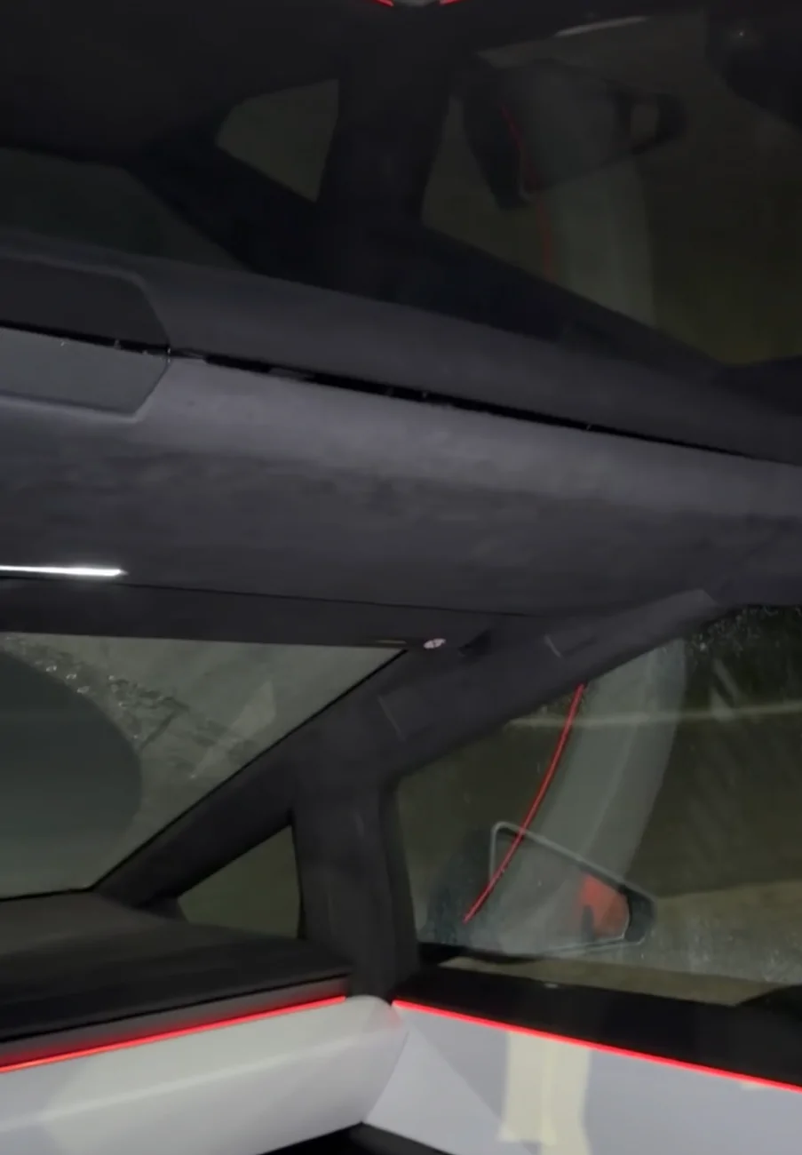

I have a Cyberbeast Foundation Series early 30k VIN. I don't recall how many times I've been to the SC for so many issues, mostly small defects and damage caused by the service centers while fixing other things, which is super annoying. You take it in for one thing, and they end up damaging your floor trim or something. But one issue that remains unresolved is the headliner.
The windshield was scratched during service at the Paramus, NJ, service center, and they agreed to replace it. After they replaced it, the cabin and wind noise increased dramatically, and the new windshield was all wobbly and distorted. I went to another SC in Totowa, NJ, and they replaced it again and fixed most of the issues from the first replacement. But the headliner still has a big gap in the middle, where the speaker is, and after 3 or 4 visits for it, it only gets worse. Last time, they said they tried something new from the service manual or something, but still nothing. Now even the left side has a gap from the roof glass, and there's also a high-pitched noise coming from time to time around the right side of the headliner.
Has anyone had this issue so far, or knows a fix to make it sit flush and not pop out on bumpy roads? I have seen many Cybertrucks. Not all are super flush, but at least they don't pop out on bumpy roads, which is super annoying. Here are a few pictures:

Yeah, got the message from the tech. They replaced the whole assembly/clips, etc., and it still hangs in the middle. Most likely, it's the mounting points glued to the roof glass that can't be adjusted. My only option now is to find a 3rd-party tech to maybe swap out the clip for a closer fit.
