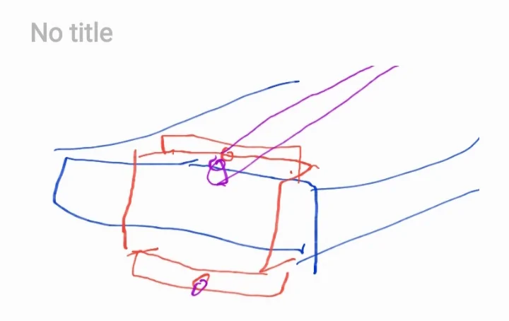

And for the mount, I dont know the issue and exactly why they did what they did but I was thinking something even like 2 all thread bolts the length of the case above and below with a u shaped metal end cap with rubber between it and the condensor. Simple easy does the same as the strap albeit with a bit more work but you can torque it to a spec and easily remove tighten, loosen etc, like a part should be.
Blue is condensor orange is u shaped end cap, purple is 1 of 2 all.thread bolts other 1 on bottom

Long bolts? Instead of a strap? Why?
And you still needed the spreader anyhow, so that design doesn't solve the hodge-podge problem while being more expensive and bringing new points of failure (bolts through a plate don't move as one like a strap would).
The vibrations will wear away at the plastic creating small gaps. When you lose any tension even a minute amount the gaps from the plastic spacer thing wearing will allow the condensor to bounce and move a bit, furthering the issue.
The straps will allow vibrations and bouncing.
A solid bolt will firmly hold the condensor tightly against the firewall. REGARDLESS of the vibrations. And wont lose tension over time, heat cycles, etc.

Cars have straps in them all over. Straps do compression and vibration very well, so they're used to hold hoses and cables and your design with the long bolts is basically that tho more expensive and less good in a non-vertical orientation.
They obviously needed more compression, and found a quick and cheap and reliable solution. That's good, not bad.
Since they want to make cars cheaply, they'll be working to eliminate this labor-intensive fix, and I bet cars coming out now or in another month will have a different solution. Certainly the ones using the new casting will have a fix.
