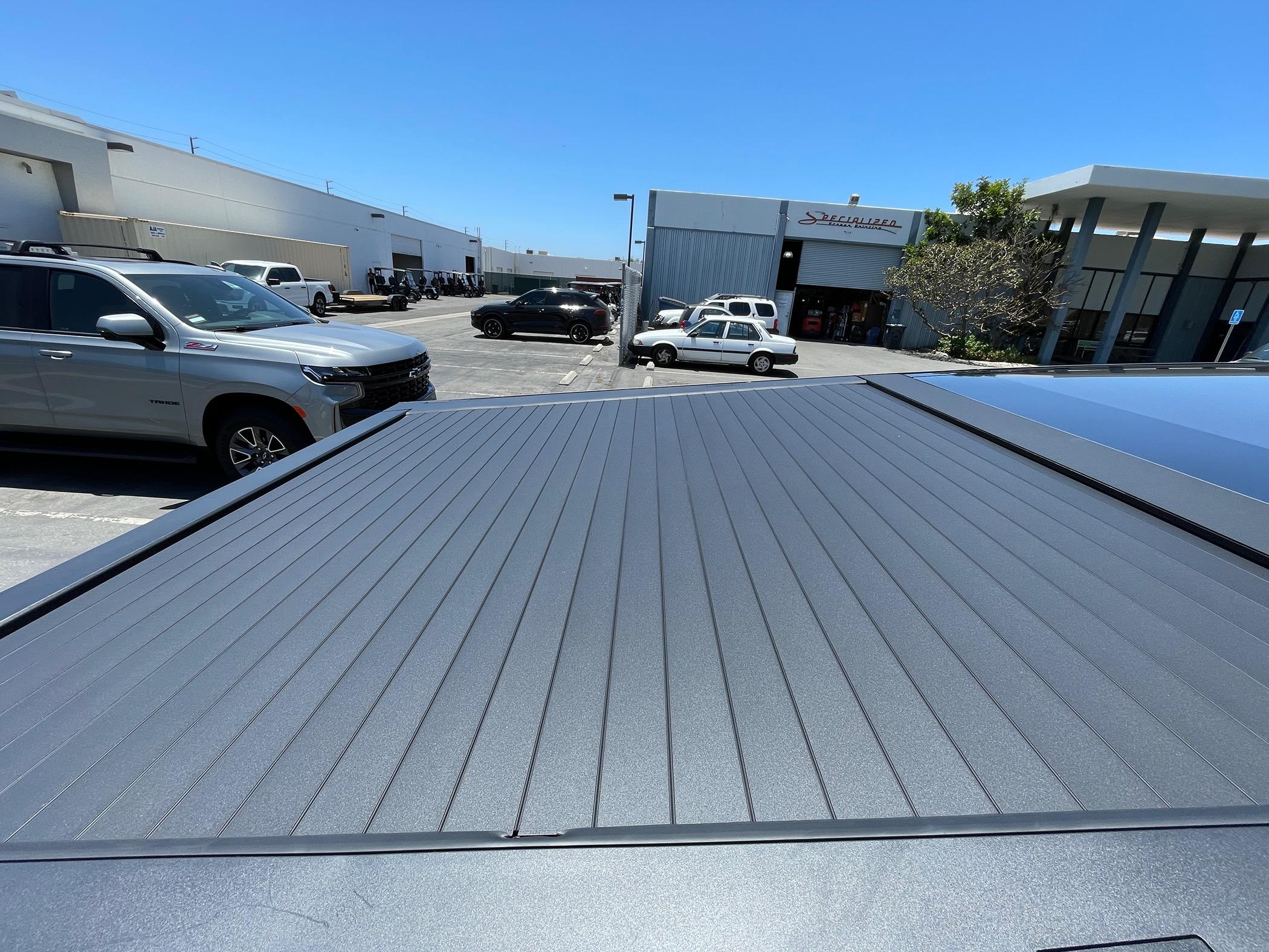

How many slats does your tonneau cover have?

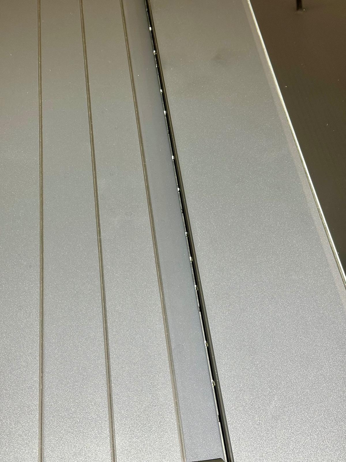

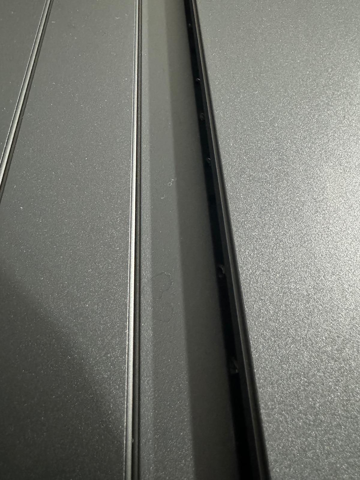

I talked to service about this and they said they hadn't heard about any issues with the tonneau covers.
I'm surprised by that because of how many people have talked about this problem on the forums and how many of us see the bracket holes.j
They also told me they wouldn't just add a slat but would replace the whole thing.
