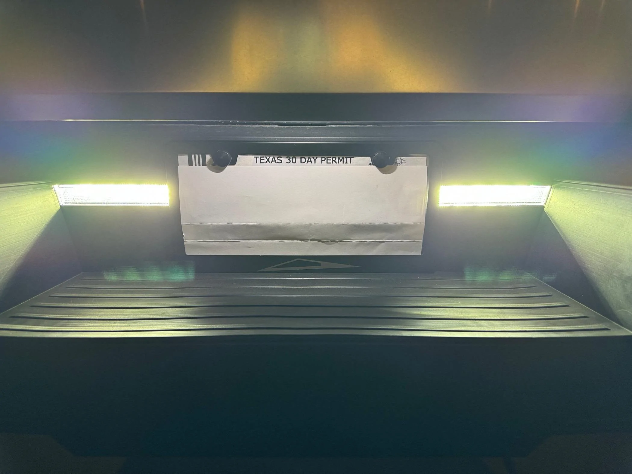

Tesla does not provide a rear plate holder. You can use the same self tapping screws for your plate. Mine came with the temporary plate attached to the rear at delivery but it’s the same screws as the front ones.

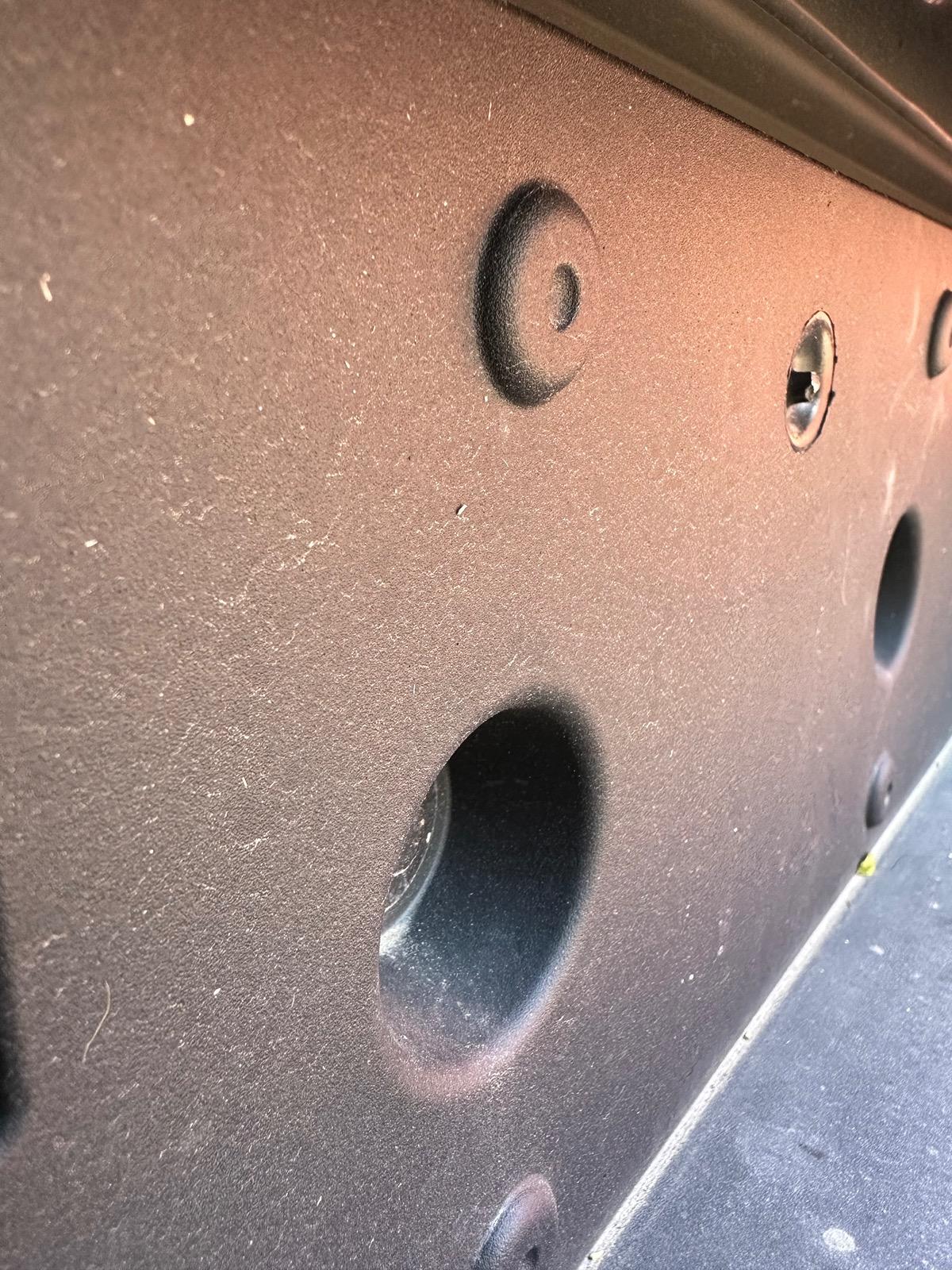

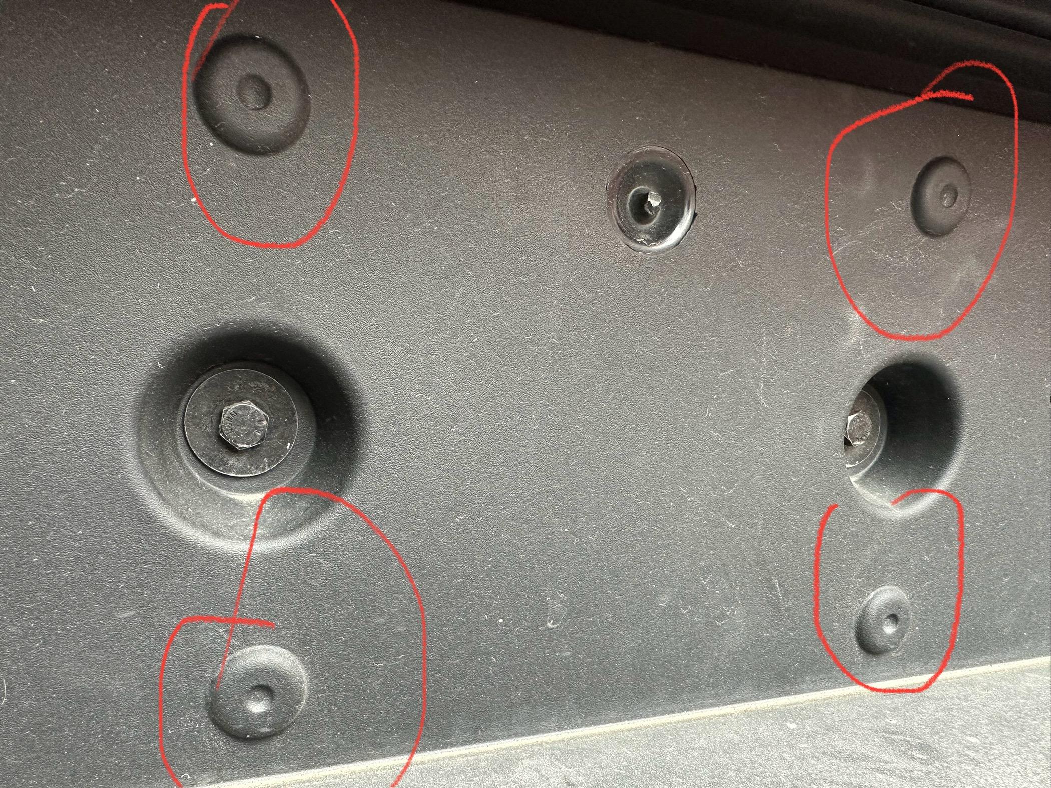

Hi how exactly were you able to put the 4 screws into the blunt plastic on the rear license plate area? Do you need to drill into them to make the holes first?
Thanks.

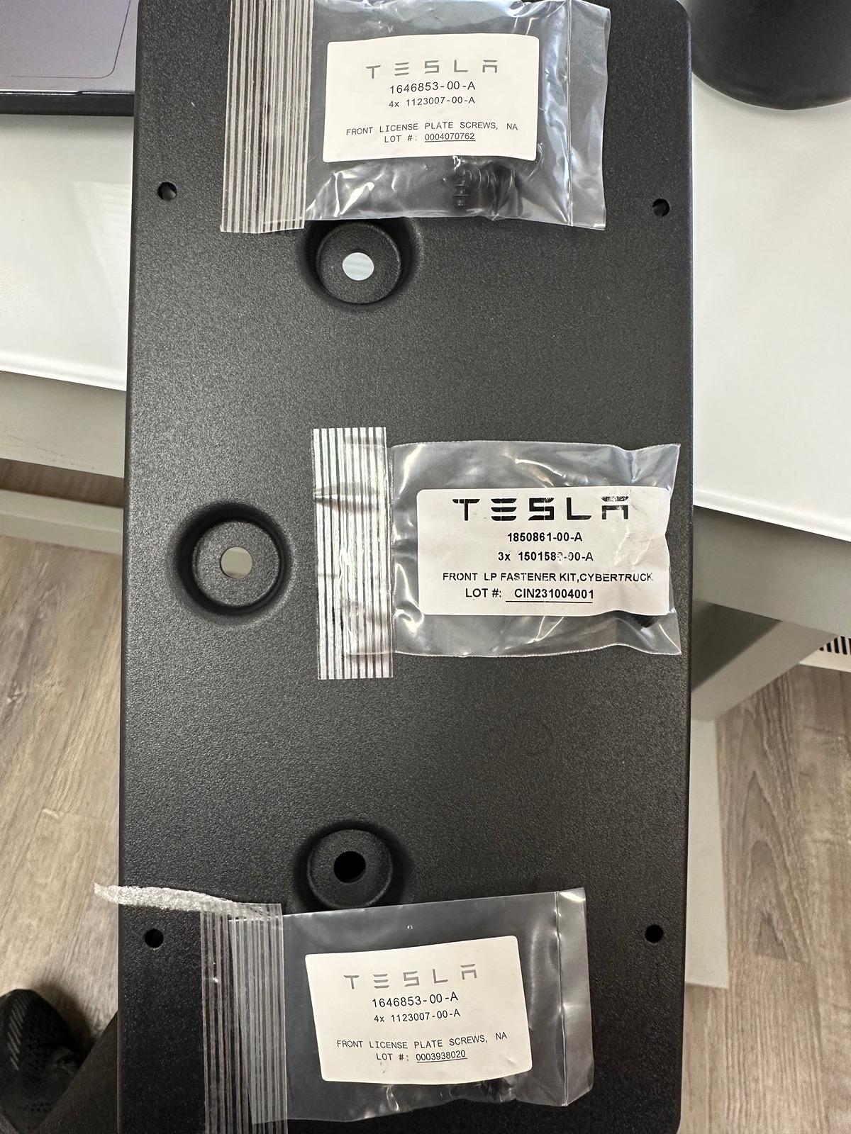

I know I'm not the most handy guy on the planet, but how do I attach the rear license plate? Do I use some of the screws that say front? Are they self tapping?
I appreciate any help on this topic.
Thank you.

Self-tapping, just start them with a screwdriver. If you drill a hole, there's nothing left to grab onto.
