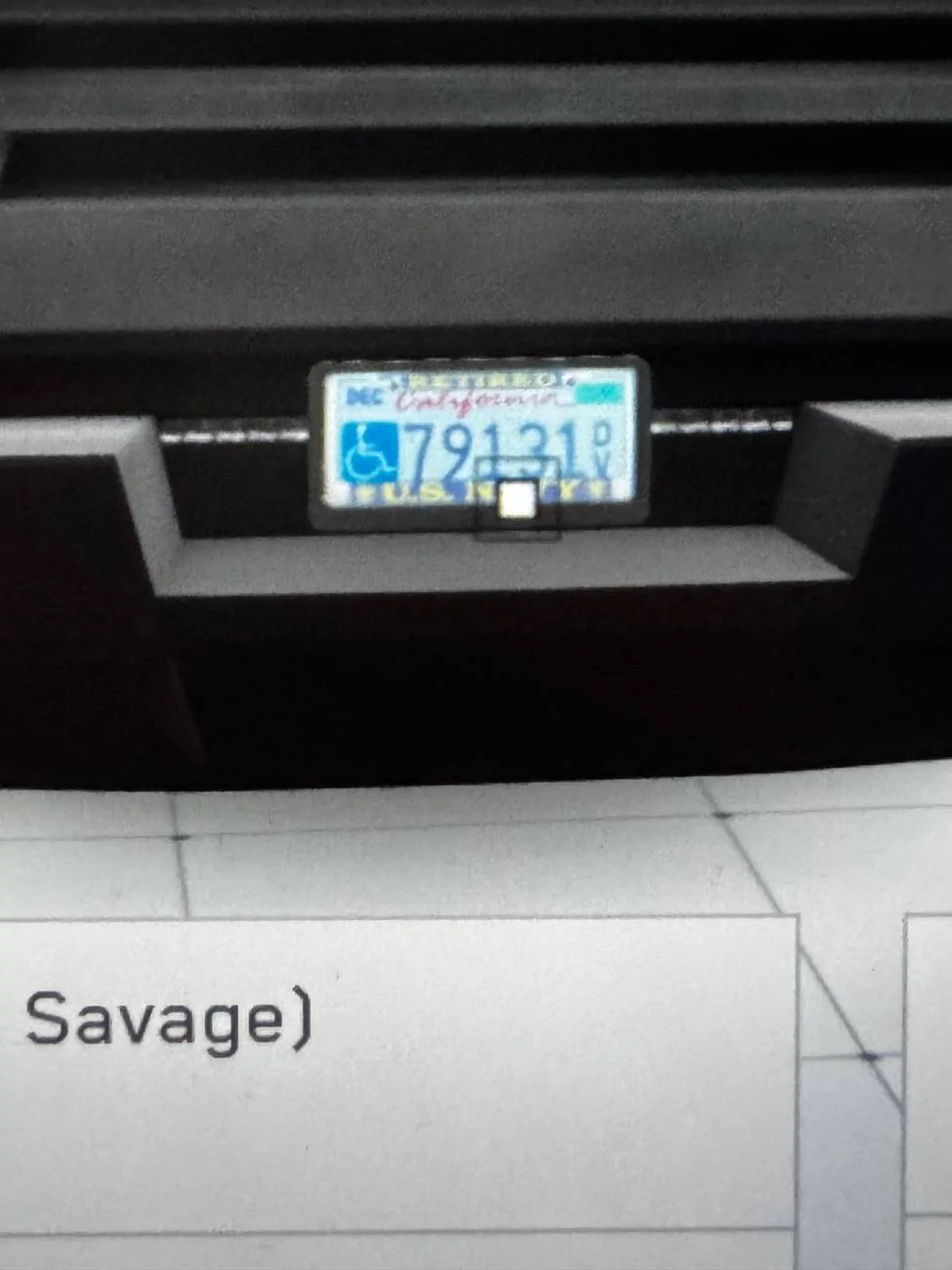

Help please. I don’t know what I’m doing wrong. Has anyone figured out how to get his to work? Pretty sure I’m following all of the steps…

Yup, followed same directions as above.
OK gotcha. I guess my next question is did you use a separate USB drive or did you use the same one that you use for the Tesla cam and or boombox? Or custom lock sound?

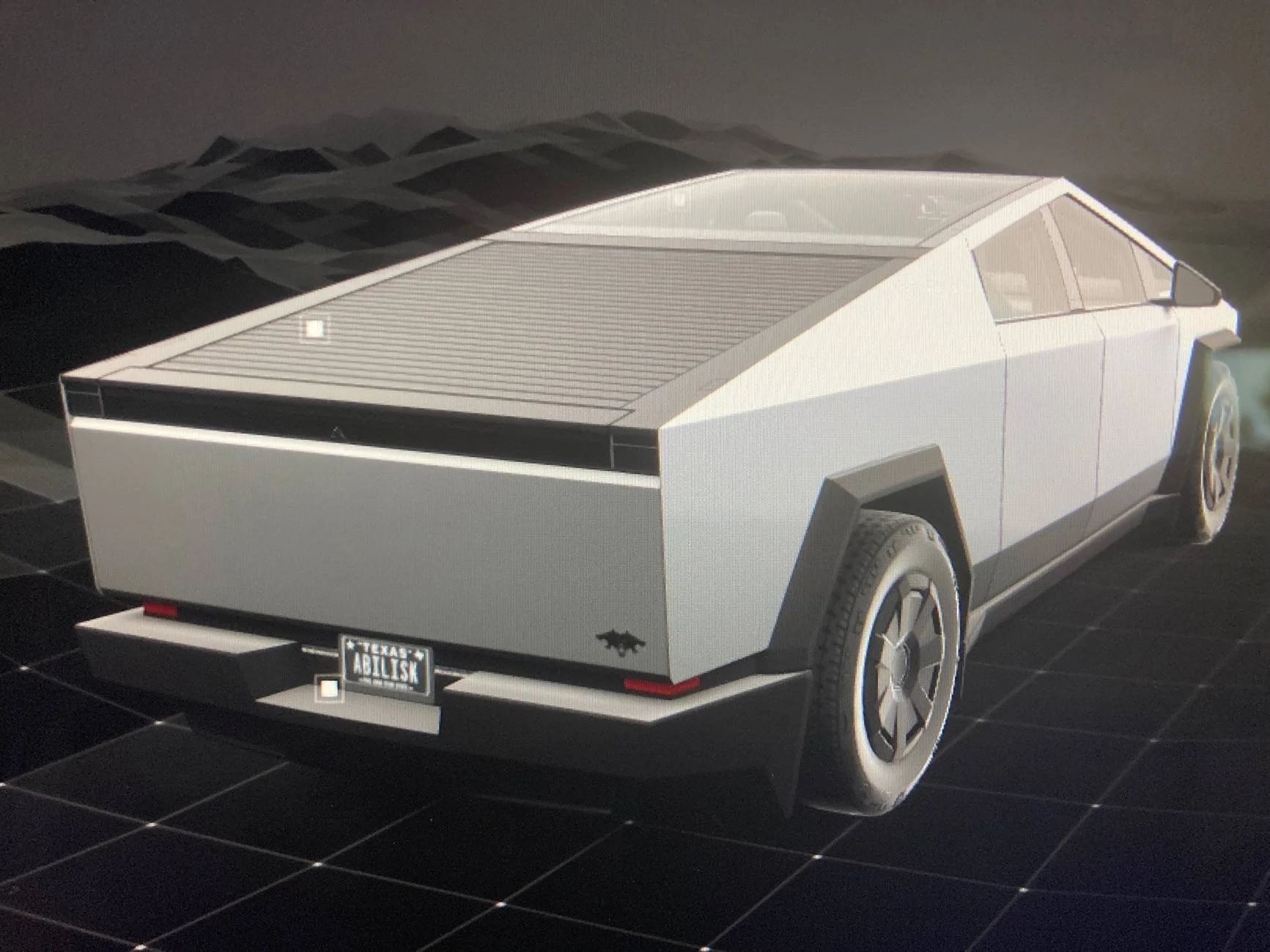

It won’t work if you put the LicensePlate folder in another folder. Just add it to the flash drive’s “Home Screen” if you will. One folder exists from the factory. Add a second one, name it LicensePlate, and put your image in there.

I’m not sure what partitioning is, so that may be the root of the problem, but try adding a folder to same side as the Tesla cam one if you haven’t yet.
