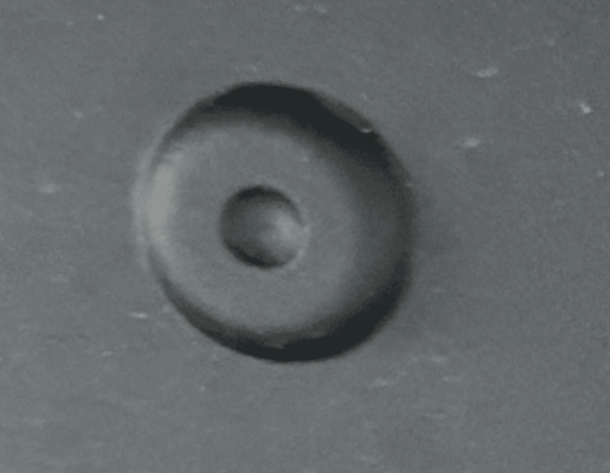

Did you have to drill the holes for the rear plate? My truck seems to have a slot for the screws for the rear, but it looks like they aren't threaded.

IIRC, the screws for the rear plate are self-tapping.
If so, they’ll just thread right into those indentations.

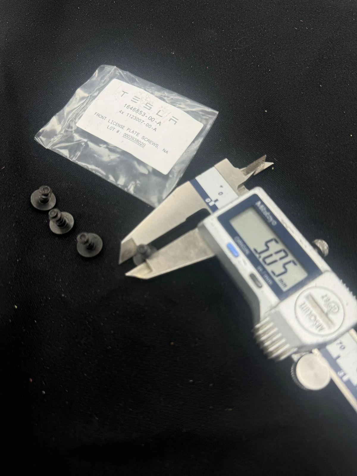

Here's a photo of what came for my plates, 2 sets of these. They are Truss head self tapping screws. 5mm diameter x 9mm long. For plastic, with very sharp threads, widely spaced, cross-head drive. Not stainless. Sorry for the focus.
