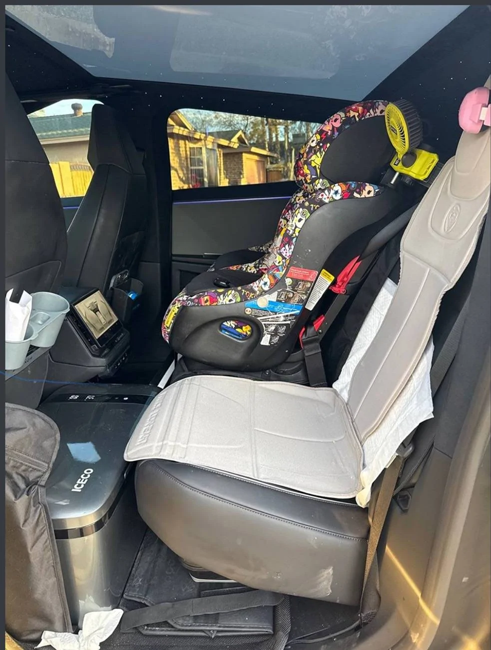

Not to belabor this point but a cabin fridge has many advantages beyond just being able to reach for a drink while driving.
Sorry for the messy pic but I keep one right in front of our rear facing car seat. Also have one on order from cybergearco which will likely replace it if you can’t spare the floor space like I can.
You’re running cabin overheat protection anyway and burning energy to do that whereas the vault at least in Arizona gets scalding hot. It’s just more efficient to put the fridge in that space.
I have both a cabin and vault fridge and use them on different occasions. By far prefer the cabin fridge.
Also, another useful tip, since my kids climb in and out using the fridge as a step sometimes, I put a piece of clear ppf on the top of it. Works like magic. Not a scratch.
