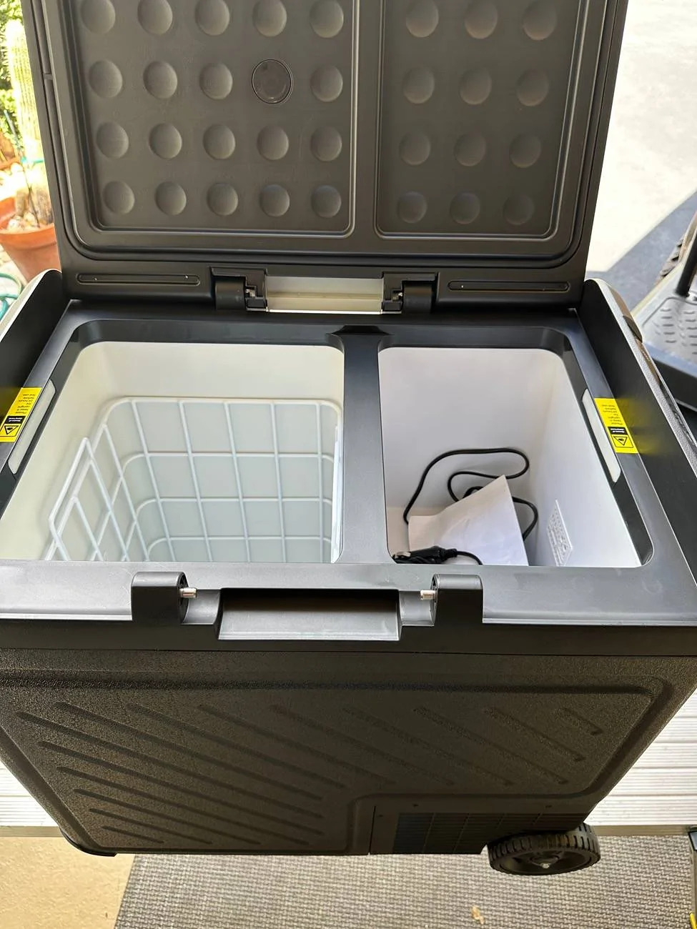

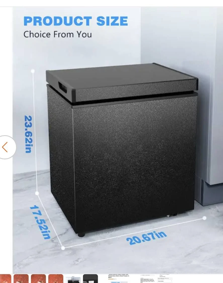

I decided to go with a vault set up since the inside space would be awkward for passengers that I take with me. In the vault, I’m using a small chest freezer and a 59 quart combination fridge freezer. I installed both on a watt meter in the fridge freezer combination average is 40 W And the actual freezer runs about 30 on the hottest days and highest use. It’s a combination of 100 W on hottest days peak power draw. What I’ve done was to plug in both into one plug of the watt meter then into the 110v Since the plugs will only stay on for 12 hours when I’m home I just unplug it and put it in an extension cord that was suggested here several weeks ago to me and it’s worked good for me now, however as someone stated here the vault when closed gets quite hot so the efficiency is not as good as if you crack the vault open a foot. I’m going to try and get a deep cycle 12 V marine battery and use a small trickle charger that would be plugged into the vault outlet and continuously charge the marine battery and use the 12 V connections to power directly from that I did not know there’s so many options on the market. I wonder if the 12 V supplied by the trailer plug stays on all the time or does it too turn off? The chest freezer I can consistently keep the temperature below zero, the fridge freezer combination the fridge part when it set at 32°F never gets above 40 on the hottest day but the freezer part comes closer to 20°F when it’s set for 10 below zero. It was suggested to me on this form to try one of the Jackery devices when I looked at the cost to supply 12 hours for the fridge freezer set up I would’ve had to go with a $700 unit so for me that was cost prohibitive since that’s the only thing I would ever use it for I think everyone’s going to have to have a different set up because many people are going to need access to the fridge while they’re in the cab and people like me stop every hour or two anyway so going to get a drink out of the back or something frozen is no big deal Hopefully someone will come up with a workaround to solve this problem for the cyber trucks.

Don’t forget truck turns outlets off after 12 hours and that is a pain!

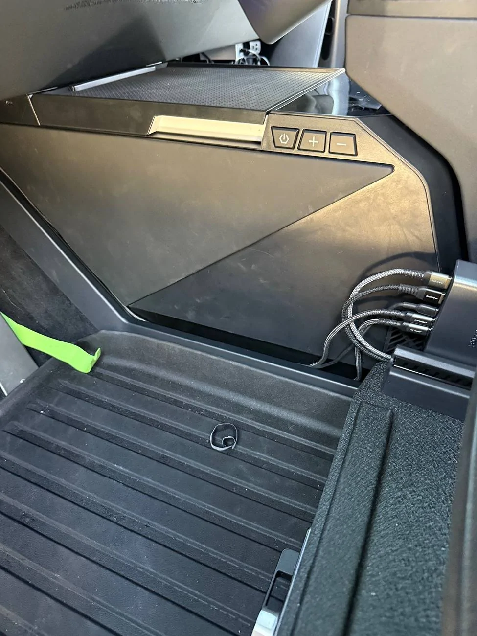

Posted on another thread but there is my new cabin setup that doesn’t take leg room installed today. Still runs on the power station which is charged by the frunk outlet.

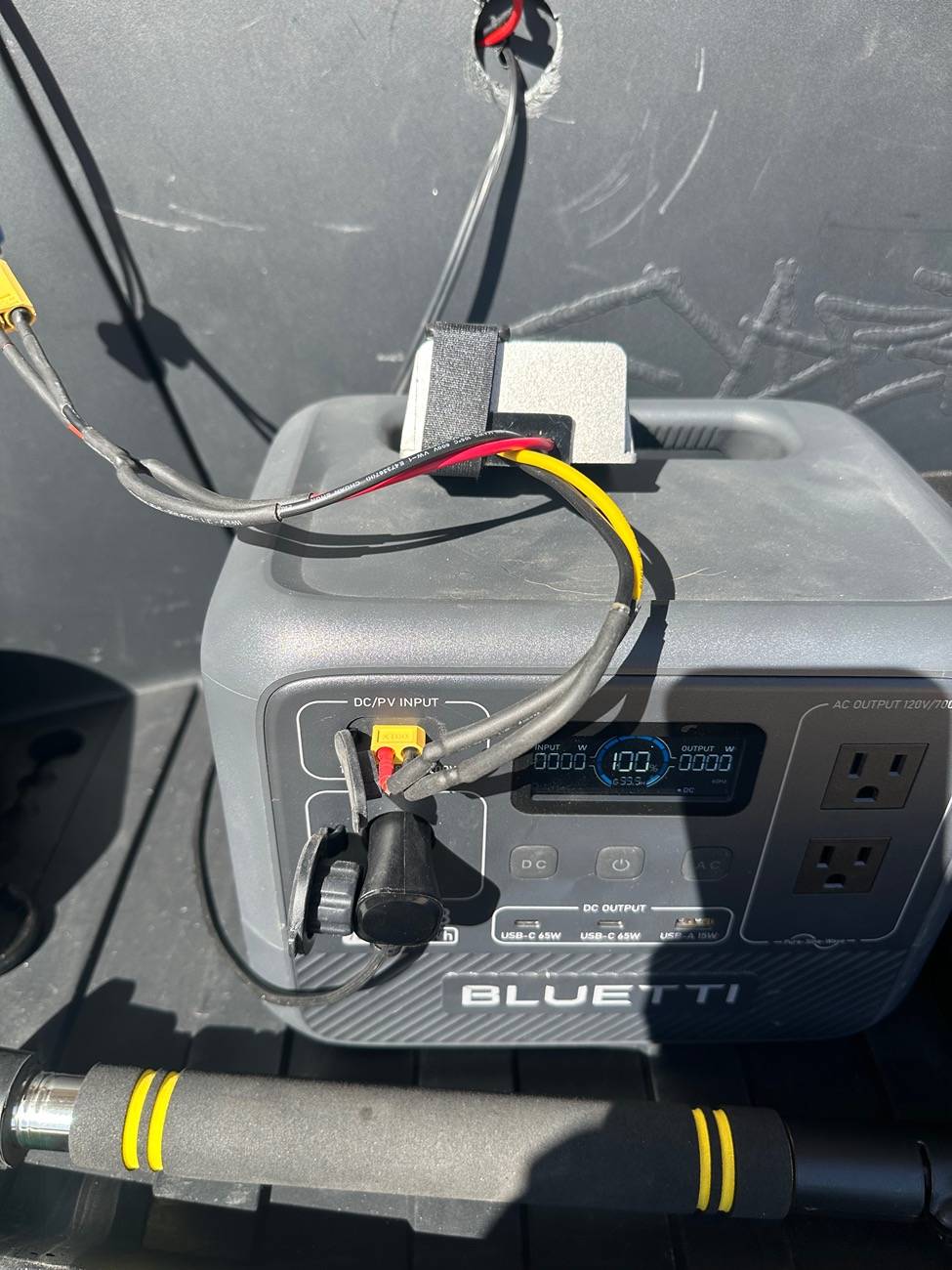

My understanding is that anytime an AC cable is connected to the truck, the cybertruck shuts off its AC power.
I get around this by using the 48 volt accessory feeds. One is to the frunk and the other is to the roof. I ran the roof accessory feed to the truck bed.
In either or both of the frunk or trunk I power a Bluetti solar battery/converter (I really don’t know why these things are called “solar generators” as they are really just batteries with cool inverters).
But I power a Bluetti using the accessory feed(s) and then use the Bluetti to power a fridge or fridges.
Or I skip the Bluetti and then use a Buck converter to power a fridge from the 48 volt accessory feeds.
But the Bluettis ensure that my fridge(s) keep(s) running whenever I want them (it) to be running, regardless of the CT’s connection to a charging cable or not.
How did you connect the Bluetti to the accessory feed? I have an Anker solix c1000 and a Jackery, both with 200w solar panels, thinking maybe I can connect one of those? Is it easy to disconnect if you want to use the battery elsewhere while camping let’s say?

Extremely easy and yes, easy to disconnect. Most solar generators, whether Bluetti or Anker or Jackery have an xt connector input or another form of dc-solar input. My little Bluetti is limited to a 24 volt input so I use a 48 volt to 12 volt Buck converter and input that from the 48 volt Cat accessory feed into the Buck converter and then I2 volts into the Bluetti at about 100 watts. This keeps the Bluetti charging. Output to the fridge is only about 35-50 watts. A picture is worth a 1,000 words. Here ya go!

Hey….nice strut.?

Amazing thank you! I’ll definitely be doing this soon to take advantage of the tap in the frunk. Nice!
