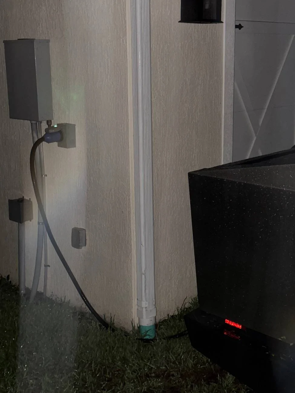

I had a generator interlock installed. This is what prevents you from back-feeding into the grid. Google will show you pictures of one. Then, you run a massive cord from the 240 in the truck to your panel. I tested mine today and it worked great and cost me less than $2000. You need absolutely nothing from Tesla in order to do this.
Sirkevin
Jun 13, 2024
121
77
I am running my house off the 240 in the truck to the generator input point the same way I would plug a generator into the house. It is currently working
