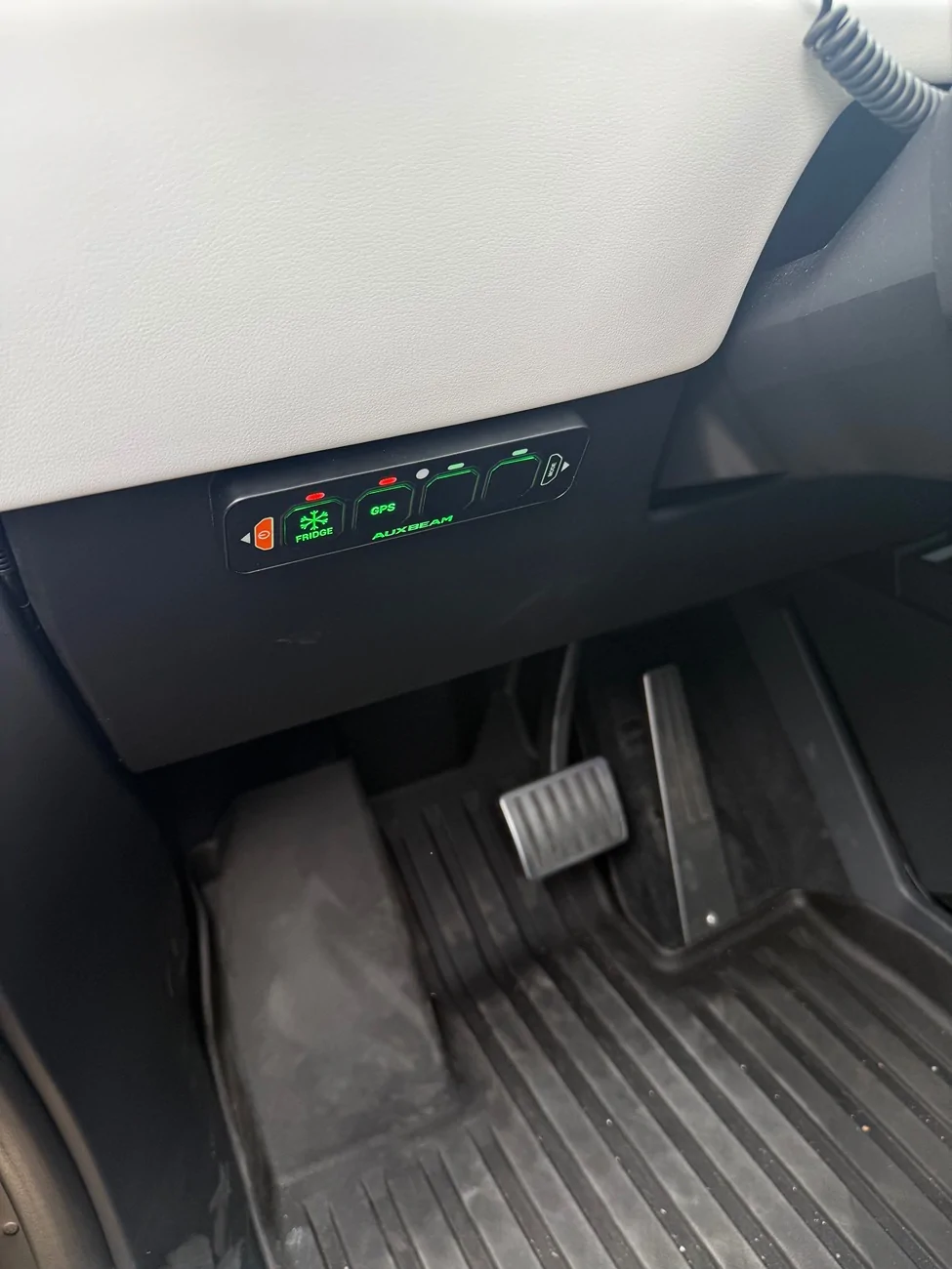

I just installed a 12v auxbeam switch to power some of my accessories. Would like that to include my subtrunk fridge.
Lots of different paths I can think of for this that’s I’ve done variations of but I’ve never run a wire INTO the vault or subtrunk.
Considering the bottom edge of the tailgate, the drain hole that functions as the vent, vault floor where it meets the side walls and so forth.
What do you guys think is the best (least painful to install also) path for this?
Remove passenger side frame slider or plastic cover and run along the door sir, easy access, no drilling required...
Or driver, your pick
Not sure I fully understand. So once you are back to aeroflap level or back of the cantrail level, how do you actually get IN the vault or smugglers bay?
You said front switch right? run along the bottom of the truck into the wheel well and then through the bottom drain hole, or put anew hole in the bin.
Brilliant

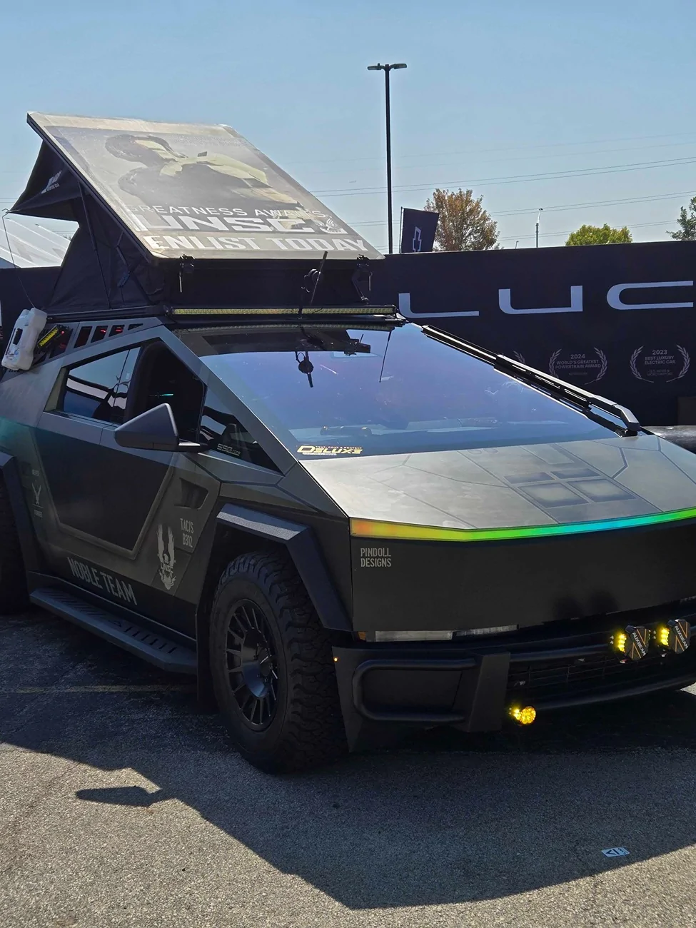

Same as you, just yellow. I've an aftermarket DRL installed from SWLights.
What made you choose that over the boring one? I had looked at both and couldn’t quite decide.
It's pretty amazing, once I saw the "Knight Rider" light DRL....it was installed lol.
