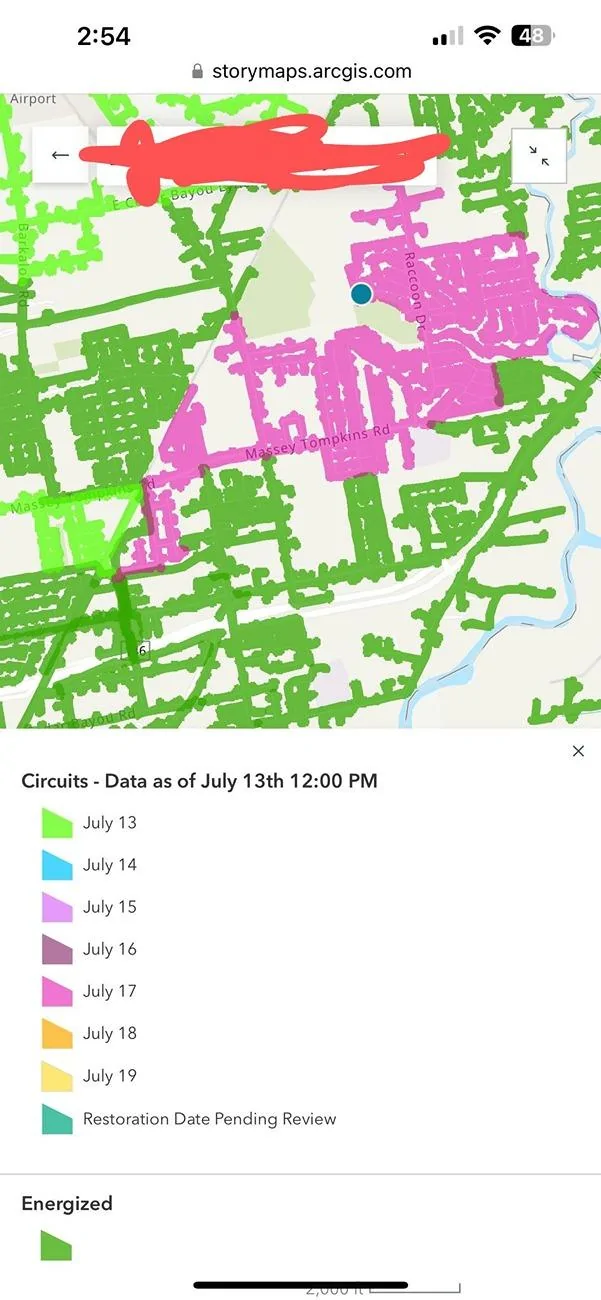

In case people are wondering the timeline....
Power went out 3 nights ago(jul 8) it's now day 4(jul 11). I can see that the trees on the powerlines are still not cleared and are still blocking the roads so I expect repair in my area has not even begun and it will still be days. The last time I was hit with a hurricane(Ike in 2008) it took 9 days to restore, the damage in my area seems at least double what Ike was so my expectations are low.
UPDATE : Day 5(7/12)
Still no power at my house although Houston proper is now down to less than 1M without power. I tried the Screen Reboot again, I also tried it with the brake engaged although I am not sure that did anything different. No joy!
UPDATE : Day 6(7/13)
No power, no internet, no hope...
Just got the word it's another 4 days estimated. I'm looking forward to Monday when it's headed for upper 90s and a feels like in the 110 area.
I spoke to my installer and they have several people in the Houston Area that in the same position I am, all equipment ready no option to enable. At least I have company in my misery.
