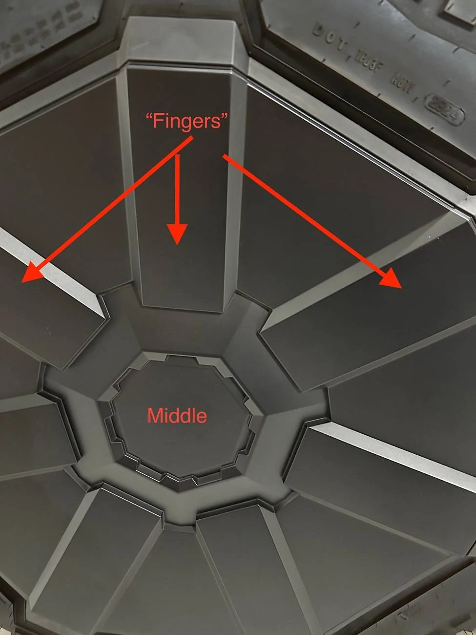

Haha. Its ok OP. Very easy to take off, adjust correctly. If you want to make it easy to separate the two parts, wear gloves because new ones are a little tight. Once separated, the ring part goes on first. And then the actual cover, you pop the middle in first. When middle of the actual cover is on, you can still rotate it slowly to match it exactly to the tire. Then hit each part of the aero cover "fingers" to pop them in securely.
Obviously, each wheel cover is specific to that tire. So if you want to swap it all around, you have to redo this process. Which is not hard. But if you keep track of which tire it is "set" to. You can remove and put it back and it will be aligned.

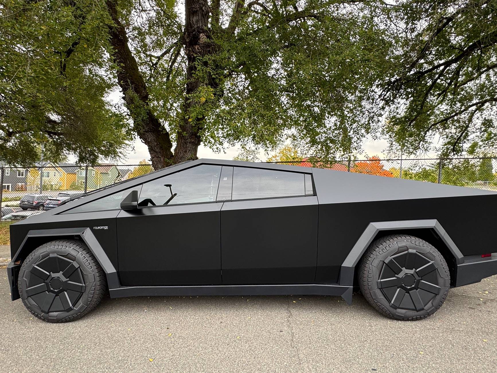

So I put in a service order to have Tesla Service to bring out and install my wheel covers. The service was quick but when the tech had finished I went out to look at it and the covers don't line up with the tire inlays. The tech said the only way to fix this is to make another service appointment and have them realign the tire on the actual mag itself and then have them put the covers on. I love my truck but I'm not impressed with the look... it looks pretty tacky.
Word of advice, If they want to roll a tech out instead of doing it in the service center, ask politely to have it done there instead. Chances are your tires aren't aligned with the wheel correctly either.
Mongo Replied to this below and set me straight. Basically the tech doesn't know wtf he's talking about or doing.
It takes 5 minutes to remove each hubcap, align, and install. You don't need a service appt for this.
