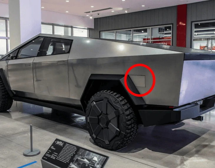

Ideas where the charge port will be on the Cybertruck?
