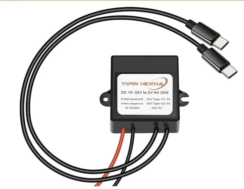

I found this. https://www.amazon.com/gp/product/B08P8CSJZB/ref=ppx_yo_dt_b_search_asin_title?ie=UTF8&psc=1
If it tapped into the headliner internal radar (which claims its 12v) on the tesla schematic, its long enough to reach the rearview mirror.
So that would be used to wire in a radar detector that has a USB C power cord? My detector is older and has one of those rj45 style phone jack plugs for power, which I think is represented in the earlier video above, or were you trying to depict something different and I'm just confused as to what you mean by the use of this part?

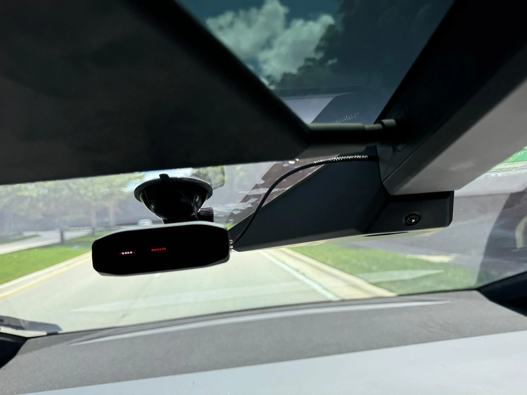

I had trouble trying to figure out a place where I could place the radar detector up top. The Sunvisor six make it difficult to situate a radar detector. I guess the best alternative is to replace the rear view mirror. But I like a more stealthy install.
Instead, I made a mount that would hide the radar detector behind the screen. It attaches to the vent and you could slide it left to right.

I followed the instructions and parts described in @edc's video. Tapped into the white connector as @edc recommended. I did not test the voltage, but Escort Redline 360c works with this connection point. I did have to set the detector to auto-off after 1 hour (lowest setting) otherwise it does not go off if sentry mode is turned on. Then it will turn on again automatically when I return to vehicle. I'm ok with it being hidden behind the visor.

Just installed it today and seems fine. Turn on soon as truck is on. FSD at night is fine. So glad it’s done. Removed that mirror too. Very clean looking. Refreshing.
