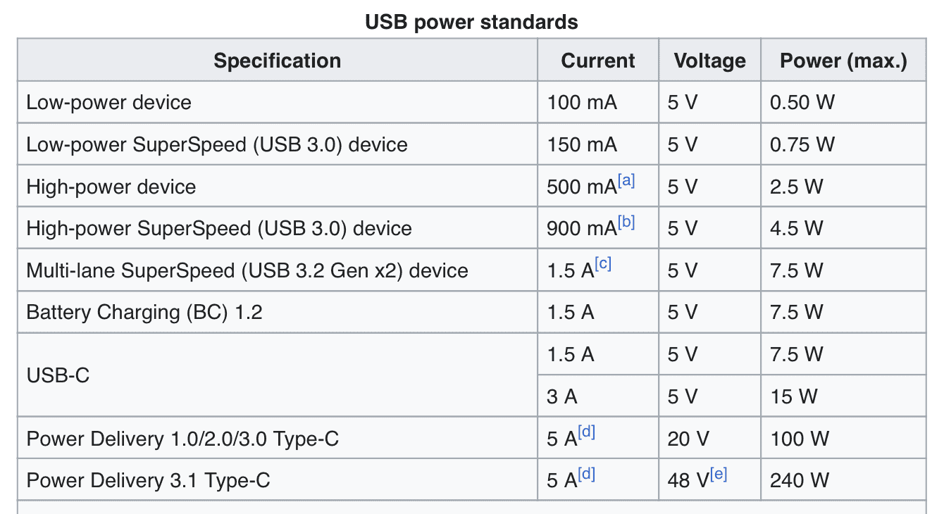

Sees to me the standard is obvious. Look at the last row in this table.

You can deliver 48v over USB C just fine.

Agree. They can just standardize on USB-C most places which has a 48v mode already and is a good connector. If people want 12v they can get an adaptor for converting USB-C to the old school adaptor.
