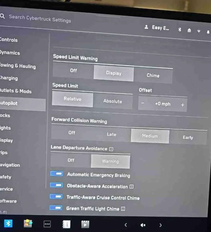

My Cyberbeast is on Software V12 (2024.20.9). Some other owners have mentioned they HAVE lane departure assist working on their trucks. I only have the option to either turn OFF or select Warning. In either case, I don't receive any warning (aural ) or assist (nudge on the wheel). The only indication I see visually on the screen is that the adjacent lane turns BLUE as I drift into a marked lane.

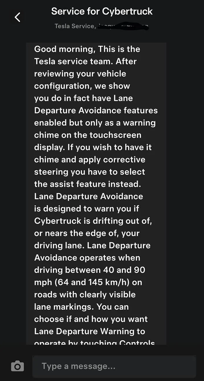

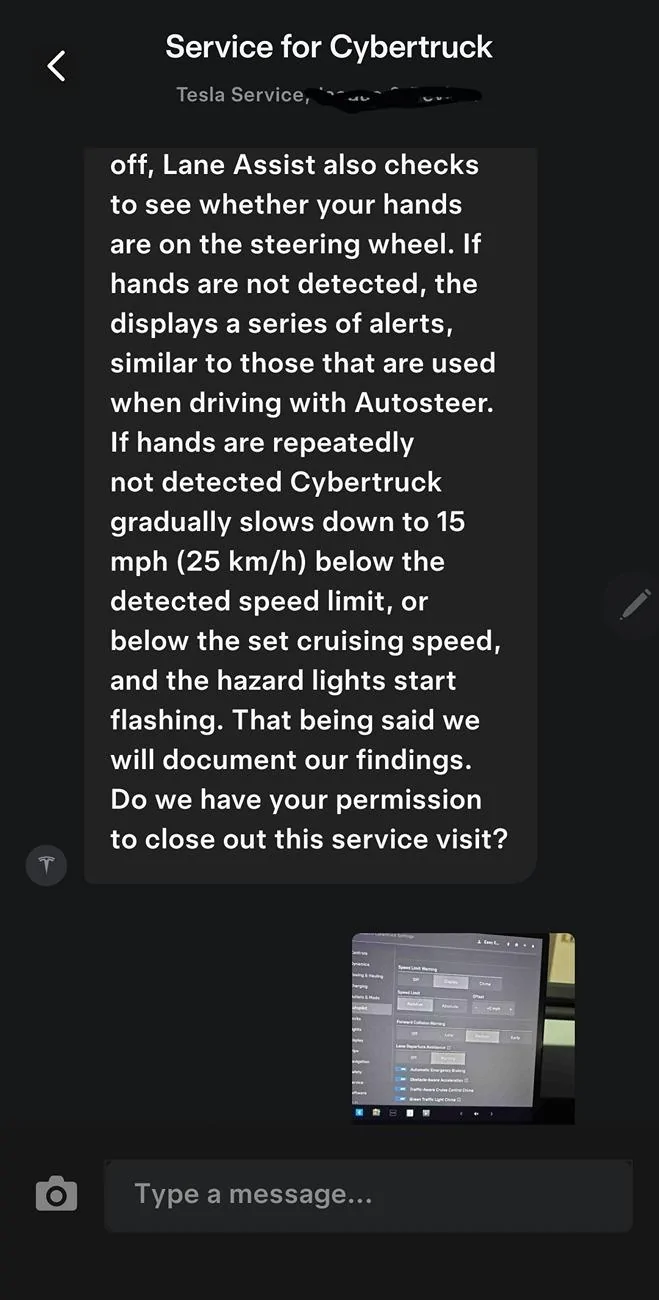

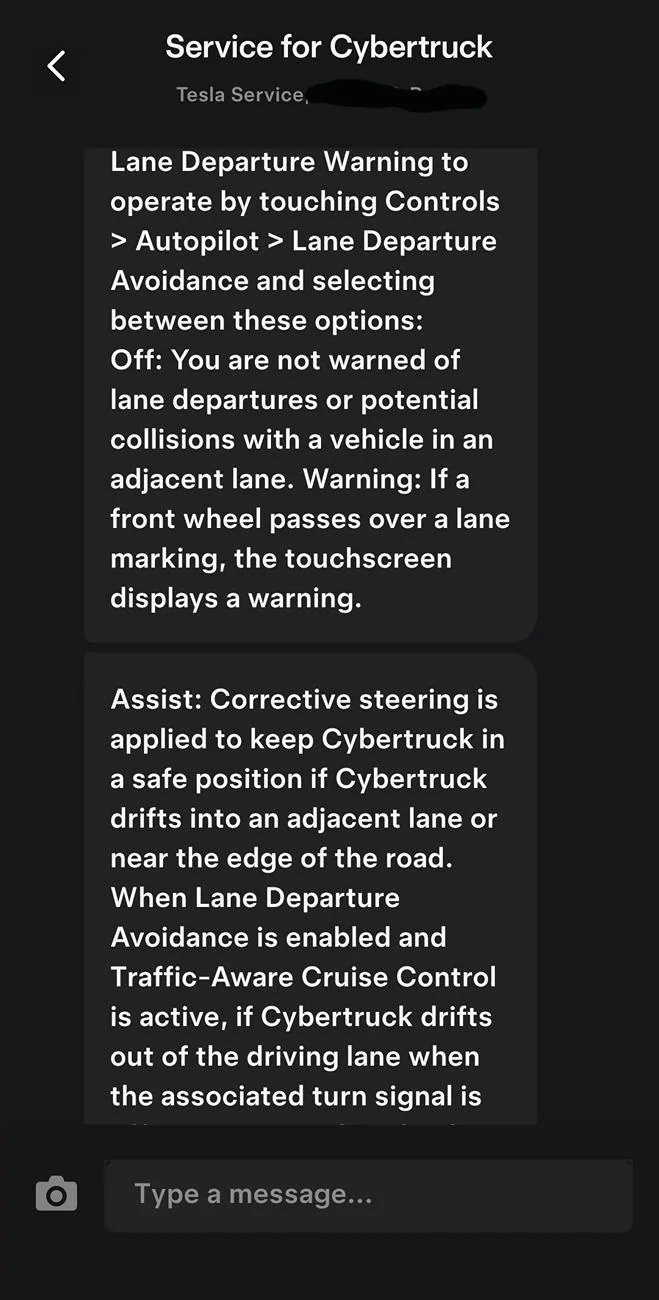

Well, looks like TESLA service is confused also, becasue this is what they texted me..
Also, others here have said they do in fact HAVE Lane Departure working.
