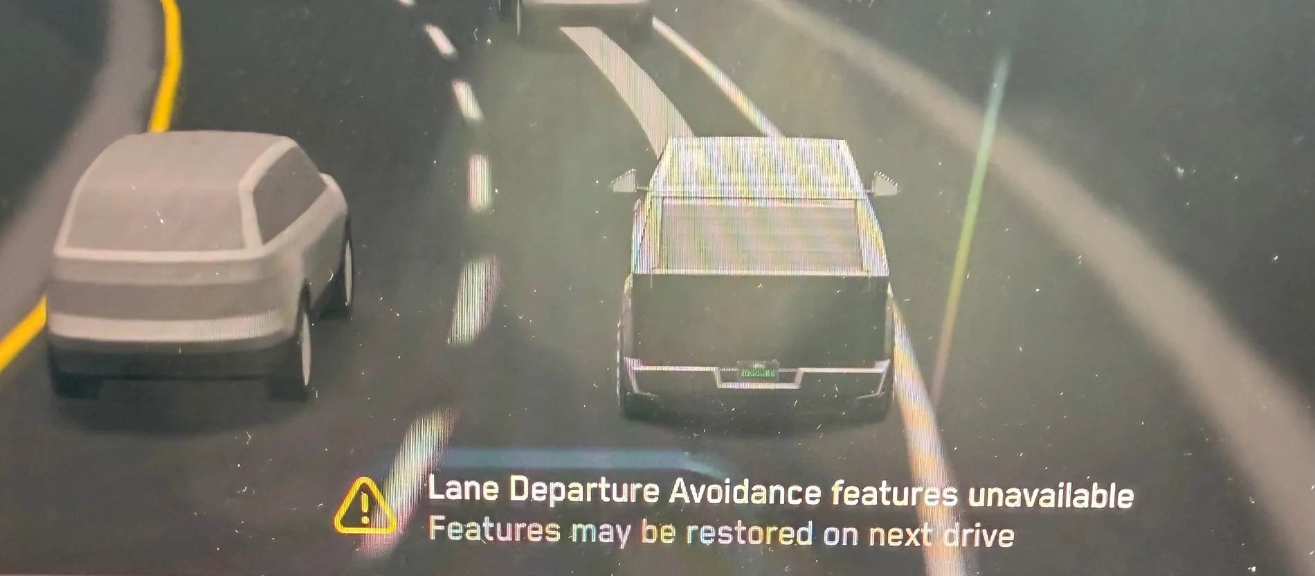

FSD unavailable - "Lane Departure Avoidance features unavailable. Features may be restored on next drive."

Not getting that error, but perhaps check the service mode alerts and see what’s in there.

"Features may be restored on next drive"

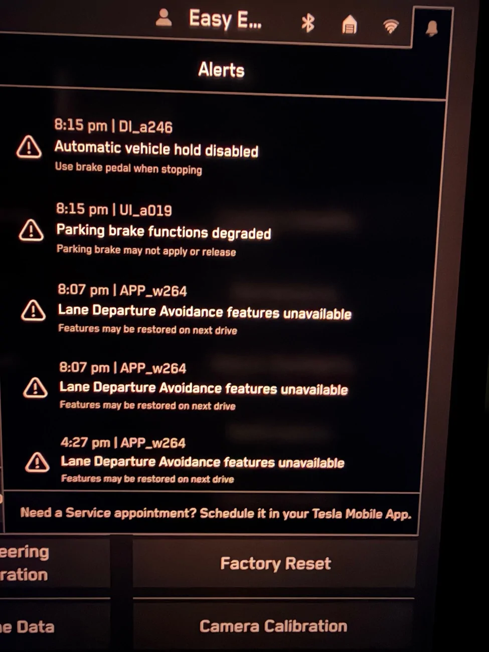

Even more alerts now. Cameras are all clean and working fine.

Service mode will give you more information on those alerts. The two button solute will reboot the computer.

For a real power-off, you can disconnect the MV battery. Requires some light disassembly.
However, I've not seen any reports of such a hard-reset resolving this issue. Instead, it's been suggested that re-calibrating the cameras could help.
After clearing the camera calibration, you won't have any Vision-AI features (FSD, blind-spot, auto turn-signal, etc.) until the re-calibration in complete. But there's good news: the fix is to take a nice long drive in your Cybertruck :love:

Go cameras on the UI. Make sure all are visible. If they are, go into service mode and clear camera calibration
