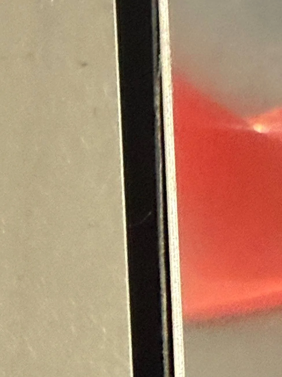

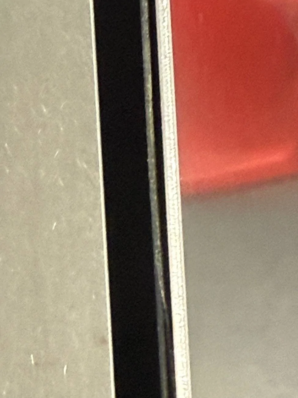

I recently noticed what looks like a panel misalignment where the front fender meets the hood on my Cybertruck. It’s not something you catch at a quick glance, but once you see it, you can’t unsee it. There’s a clear separation and it feels like something that shouldn’t be there on a brand-new vehicle. I’ve attached a close-up photo for reference.
On top of that, I’m also getting noticeable wind noise from the windshield area, especially once I hit around 45–50 mph and up. It sounds like wind shear or air getting caught somewhere it shouldn’t, and it really takes away from the cabin experience.
Has anyone else run into either of these issues? If so, did Tesla service take care of it quickly, or did it take some back and forth? I’ve submitted a request through the app, but I’d appreciate any insight from those who’ve been through something similar.

Is it around the door seals? Where the glass in the door meets the weatherstripping? Had this on mine. I thought it was a bad or leaking cantrail seal. Turns out the door seal was overlapped wrong preventing it from contacting the glass. Took seconds to fix once I noticed.

Can you post a pic that’s zoomed out so we can more clearly see where you’re referring to?
The gap between my frunk/hood and the left and right side panels are not that big.

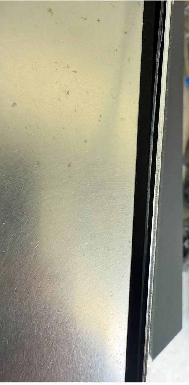

Here is a photo I took before I took it in for service. This is the front driver side fender where it lines up with the frunk.

Is the gap the same on the passenger side?
I can try to take a pic of mine tomorrow so you can compare.

Vehicle Wrapper & Content Creator
Your fender glue is failing, mine had the same issue and they replaced both fenders, tesla found the glue to be faulty in mid march after the cantrail recall was made, take a video and see if it separates anymore than it already has, most likely air gets in there and makes a ton of noise
