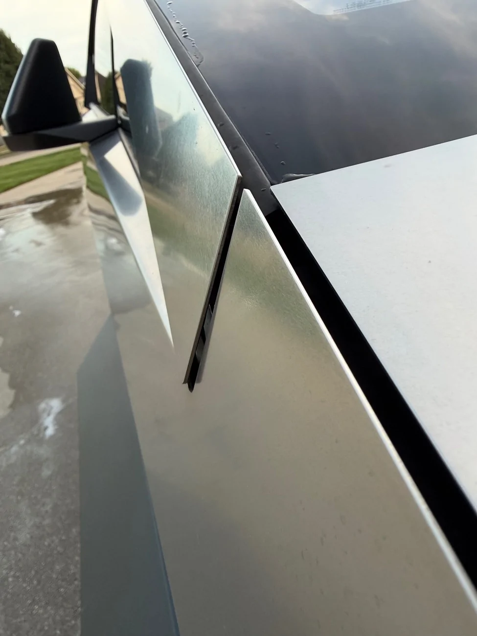

Mine were fine and I had them replaced when I got the letter and parts were available. The new one started to come off so they replaced the passenger side again.
Thats almost exactly how mine looked, but I attempted to fix it myself and made it a measure better.
Tesla Cybertruck Anyone else holding off on the Cantrail recall? 1760567252066-qu
The mobile tech came out and told me "defective, schedule another". But I was able to loosen some Torx and I could pull it down where if I had a tail or a friend I think we had a chance at getting it flush. I got more mad when I got into the frunk though and spotted my wiper appliqué had the weather stripping busted off, the cover had a plastic pin bent and the wiper filler area you could see thru like something was missing. I just took it all apart but that wiper appliqué rubber stripping is held on with double tape it looks like.
I also went a bit deeper.. .I looked at the frunk and most of it didn't even contact the windshield rubber stripping. So no idea if that matters or not but why we have weather stripping in some spots and not around the edges of the frunk is a head scratcher.
To be clear - not negative Tesla. This to me seems more like a skillset/training issues that can be solved. Similar stuff I run into at body shops, tire shops etc, which is why I do 99% of it myself.

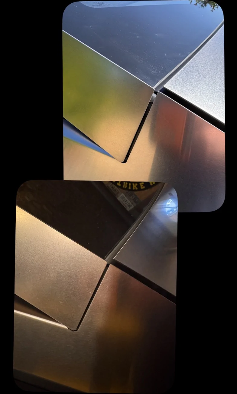

Add me to the list that should have waited. Tesla Palo Alto service center lived up to its reputation.
The cantrails have a visible divet and discoloration on each side at the front, they are slightly twisted upward on both sides, and don't fit flush at the back (larger gap on one side vs the other.)
They also did the "precision glass cleaning" and a tire rotation. What I got was grease all over the windscreen inside and out, glue residue all over the cantrails, some which I can remove -- which includes palm prints of the tech. On the door too. The interior he did a number on, leaving mud or excessive dusty boot marks all over the floor front and back. And some extra palm prints for measure on the white interior panels.
I sent a note to the regional manager which naturally went into "let me know if you hear dialtone" bucket. The service writer called but when she realized a free tire rotation wouldn't make me happy she seemed to lose interest.
They asked me to return which I will, but only because I want these fixed. I spent over an hour cleaning as much of their crap and shoddy workmanship up.
The tire rotation also was messed up. They incorrectly reinstalled 3 of the 4 wheel covers. Fixed that too.

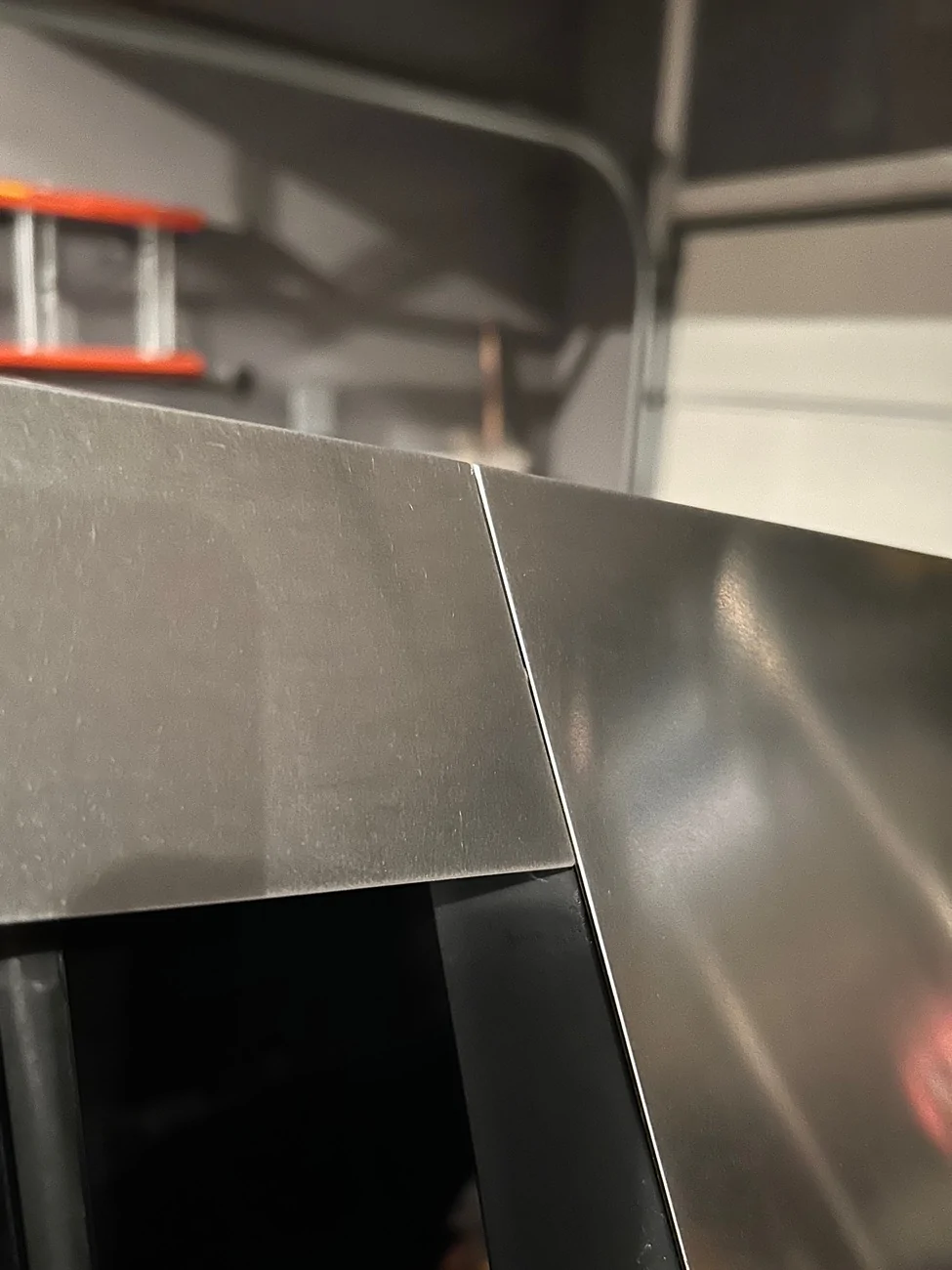

I had been holding off on replacing mine on my 37xxx VIN. The factory ones were almost perfect. Took the truck to the Council Bluffs, IA service center for a few error codes (DI_a015, UI_a019, parking brake related) that would randomly appear and eventually disappear. Reluctantly let them replace my cantrails. The new rails look great, just as good as the factory ones. ...oh, and they replaced the left rear brake caliper which was supposedly causing the error codes.
This is my first service center experience. I'm completely satisfied with their work. Sooo much better than any of my experiences with legacy auto service. No greasy hand prints on the steering wheel or gunk on the floor mats. Gave me a Model 3 Performance as a loaner, which was a lot of fun to drive.

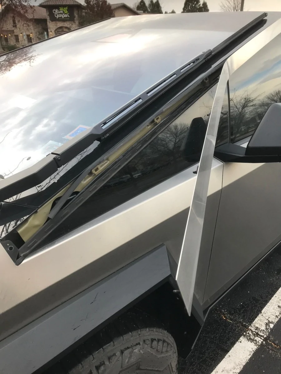

I've been holding off on this recall, and my driver's side cantrail failed on the highway. So my PSA is don't wait too long.
That's not even the issue this recall is for. Yours didn't de-laminate, the nut that holds the backing on at the front came loose. That's supposed to be secured with thread lock.
