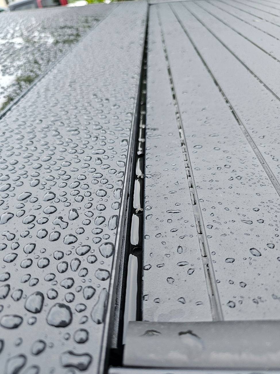

Hi all has anybody went in for service for a leaking bed the cover does an ok job but the back left and right corners get pretty wet
Has anyone else experienced this?
Can Tesla address this?
Much appreciated
The 'leaking' bed is a problem. First check that Tesla factory installed the 'first slat' of the bed cover - which is missing in early production. Mine was. You can tell when you look at the gap between the roof and slat [when the slats are closed over the bed]
If you see a track channel with spaced holes - You're MISSING the last slat. Tesla has a service bulletin to replace this.
If you do have the slat. IMO: The bed 'leak' is tragic. It does not leak - the water is CHANNELED into the front of the bed from the roof. Even when parked in rain, the water egress into the bed is horrible, no corner is safe.
This is compounded that water in front pools on the plastic bed deck and sloshes around wetting everything.
The water also gets into the back where the gate meetings the slat cover and wets anything set at the end of the bed.
'The bed is not waterproof' is a bullshit statement. A car sunroof is not 'waterproof' but it IS RAIN and WATER ENCURSION proof. Sunroofs have a channel to direct water around the cabin seal and out of the vehicle thru a drain channel to the ground. It does not let water flow into the roof/cabin layer and find whatever path to settle into.
The CT slat system seems to have *some* gutter water channel elements - but is it not fully vetted and does not work. It is a first iteration - that needs update.
It should not at least not wet anything in the bed in rain, I can understand the seal to the tailgate allowed to leak down, however there are no provisions for that water to go out anywhere but back into the bed and slosh around.
Also, 90% of the time my CT is backed into my sloped driveway - so the water incursion is worse and the bed slope is offset by the driveway slope. [Cause Tesla put the charge point on the rear end of the CT].

Please stop reiterating the missing slat as the cause of water leaks. It’s not. It’s the seal where the tonneau appliqué meets the roof glass.
True. I fixed it in 20 minutes soon after delivery and my bed has been dry through 18 months of parking outside in the PNW rain. I've had a bed full of hand tools, corded tools, and cordless Milwaukee power tools for the last 6 weeks of rain. No issues.

By making sure the seal @koolio referred to was continuous. The foam strip had two gaps in it that I plugged with a little unused foam material from either end.
No more leaks.
