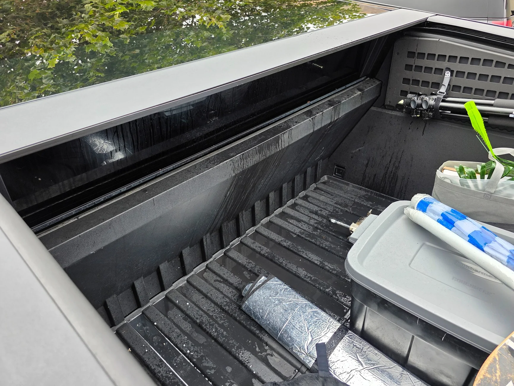

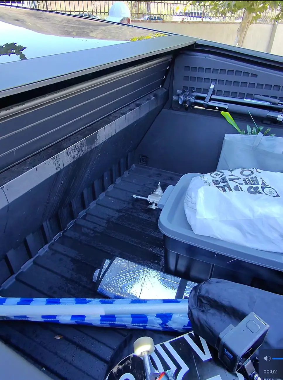

Update: Went to Thousand Oaks service center again to fix the leaking and get the missing slat installed (2 visits, 4 hours of driving + 7 days total in the shop for this issue), after going back and forth with multiple people via chat before the service and even showing the service advisor where the issue was at the applique seal, I received my car back. Unfortunately they did not address the applique seal like I had requested multiple times even though they told me they did a "hose test" and "only a couple of drops got in". On the plus side - the slat install seems to have mitigated water ingress by about 30%. See photos.
I've also linked to gopro videos of my car going through the wash before and after slat install.
Pre Slat install:
Tesla Cybertruck Leaking in the bed ….. cyberleak-pre-slat
Post Slat:
Tesla Cybertruck Leaking in the bed ….. Screenshot 2025-08-30 at 10.12.18 AM

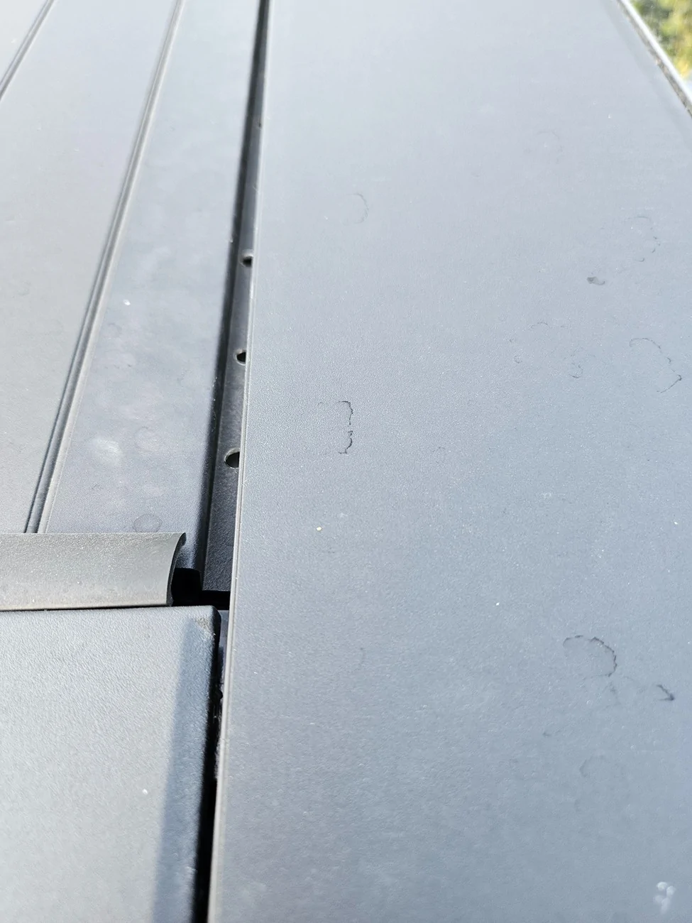

Interesting thread. Today, going 65-70mph on a freeway, I heard a loud bang; followed shortly after by another, possibly louder bang. Pulled off the freeway and discovered I am missing a slat. I can only assume it came off due to wind forces and fasteners working loose. I'll schedule with my SC to get it replaced. I have just over 5k miles on my truck, over a 10 month period. Here's a picture when I pulled over.

I don't think anything like this possible, need more details
Sterling Shadow
Aug 4, 2025
182
323
Cybertruck 25', Model Y 26'
That looks exactly how my truck came, it was missing that slat as well. I’m wondering if maybe the noise was something else but you just now noticed the missing slat. Originally I didn’t see it, someone here explained how to look for it.

When I first heard the noise, I feared it was one of the cantrails. But they were fine. Is it possible it was always missing? Not likely. I never had any leaking problems. I have not tried to hose it down since this happened. I just happened 3 hours ago. I test it with water and post my results. If correct, there could be a scenario where the slat was on when delivered, than came off.

Update on my situation as well - it took two visits - slat install, post install leaking continued, then emphasizing the applique seal in between glass and tonneau being the major culprit (with video I shot in the bed while going through car wash), and they finally fixed the foam stripping in the applique. Now it is bone dry in the back!
