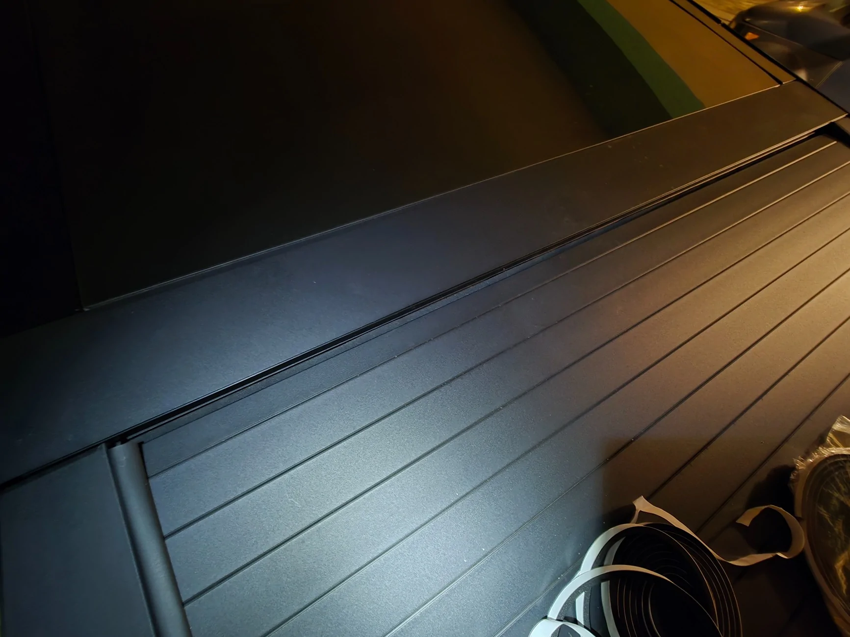

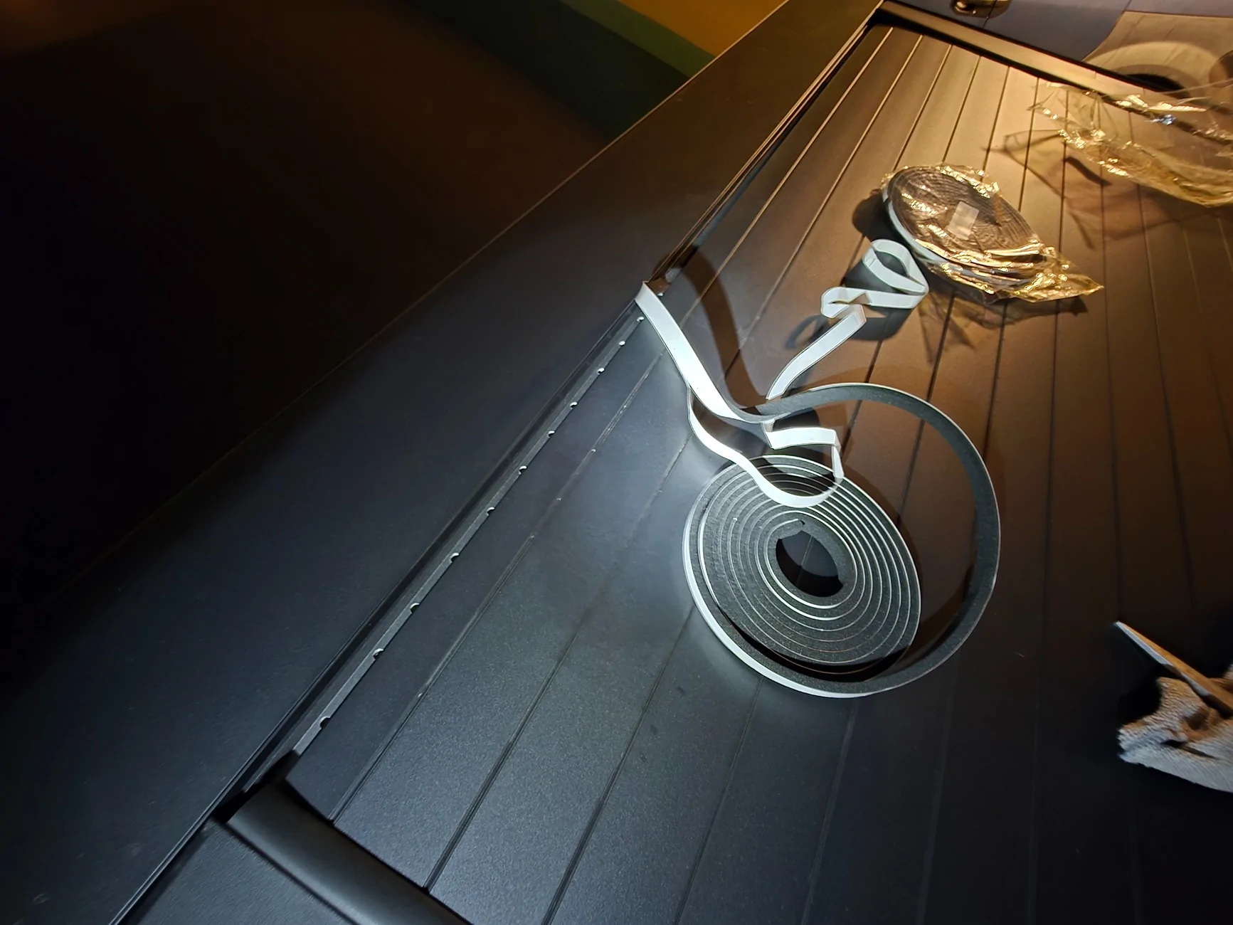

So far two storms and one very high pressure car wash and I see no water even in the corners. I suspect if there were water in the corners it would be the foam seal along the side of the applique not properly mounted as seen in the one Amazon seal replacement. I am not touching mine for now and will bring updates back to this thread.
Id like to see a photo of your tonneau and its seals if possible. I just did the 1/2 inch weather strip fix after the service center didn't fix the issue due to a damaged part/ slat (they ordered a replacement but im not in a rush to drive an hour each way to get it fixed just yet).
Will wash it tomorrow and see how it holds up (still need to address the applique leak down the back window).
About to do this myself. Hope it works for both of us.🤞
I have not pulled off the applique yet, but no water from storms and only had some water once from a high pressure car wash. I have gone through the car wash 4x since Tesla fixed my leak. Do you want pictures of it from the top and bottom with the applique in place or are you waiting for me to pull it. I will probably pull it off in the next couple of weeks.
Top and bottom works as is! Thank you!

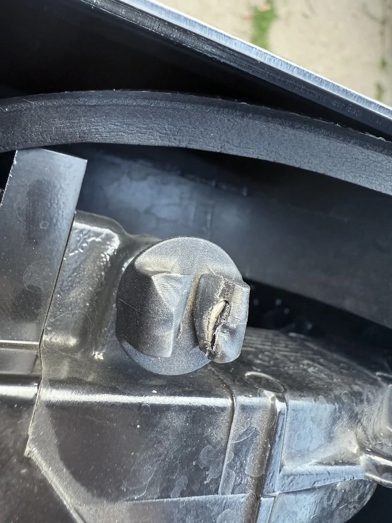

I recently took my Cyberbeast in for service, and one of the things I asked them to fix was the leaky tonneau cover. I had performed the seal between applique and sunroof, but it still was leaking. I was apparently missing a slat, so they replaced it, but it's still leaking just as much as before. So that extra slat was not the issue either.
So I removed the applique to discover that Tesla service personnel had mangled my applique screw/clamps and didn't say anything about it. The original clamps that came with the truck were larger, and required them to be rotated vertically. The ones that some with the tent are smaller, and require a horizontal placement. I know they were perfect because I removed my tent prior to bringing it in for service and they were perfect. I've requested they send me two new ones.
But that got me thinking - these can be rotated down to various levels, and will cause the applique to make a better seal against the tonneau. Tighten them too much, and the tonneau will actually hit the underside of the applique, but just enough and you get a tight seal. I think I have it in the sweet spot, so will test it at the car wash later today...

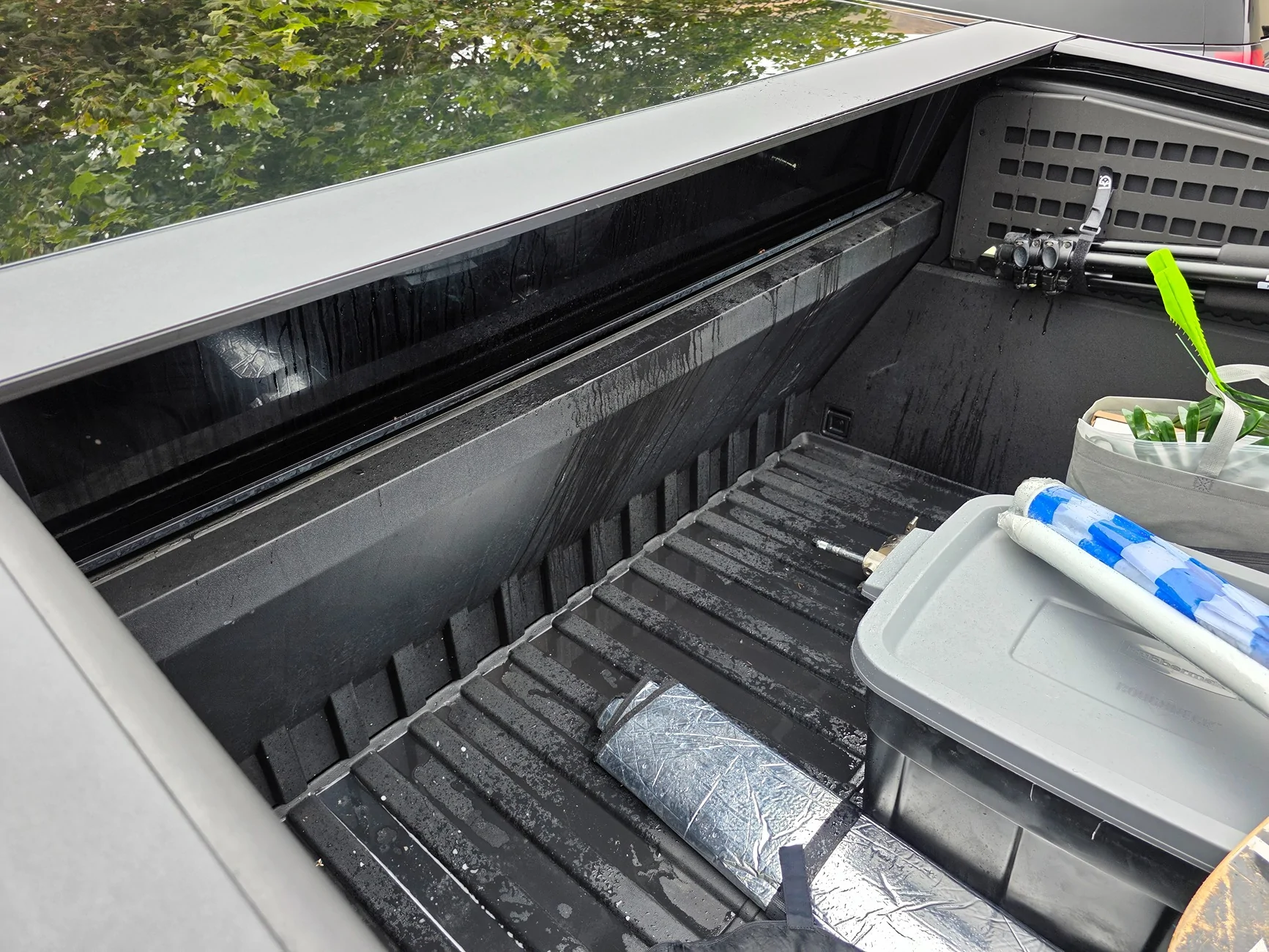

Update: The weather sealing over the top missing slat technique did NOT work. It gets as soaked as ever which is very confusing. I'm going to setup a camera in the vault next time I take it through a wash. The applique is another point that needs addressing as well.
Not on the slat. The tiny gap where the glass meets the aero cover. That’s where it gets in, the slat is different
I tested the missing slat area before hand and water pours in. I may have to reapply the weather seal there, on top of addressing the applique seal (which I noted for service department to do). At this point I have another service visit to address this next week so I will hold out in hopes they fix it with all the notes and diagrams I gave them 😂
