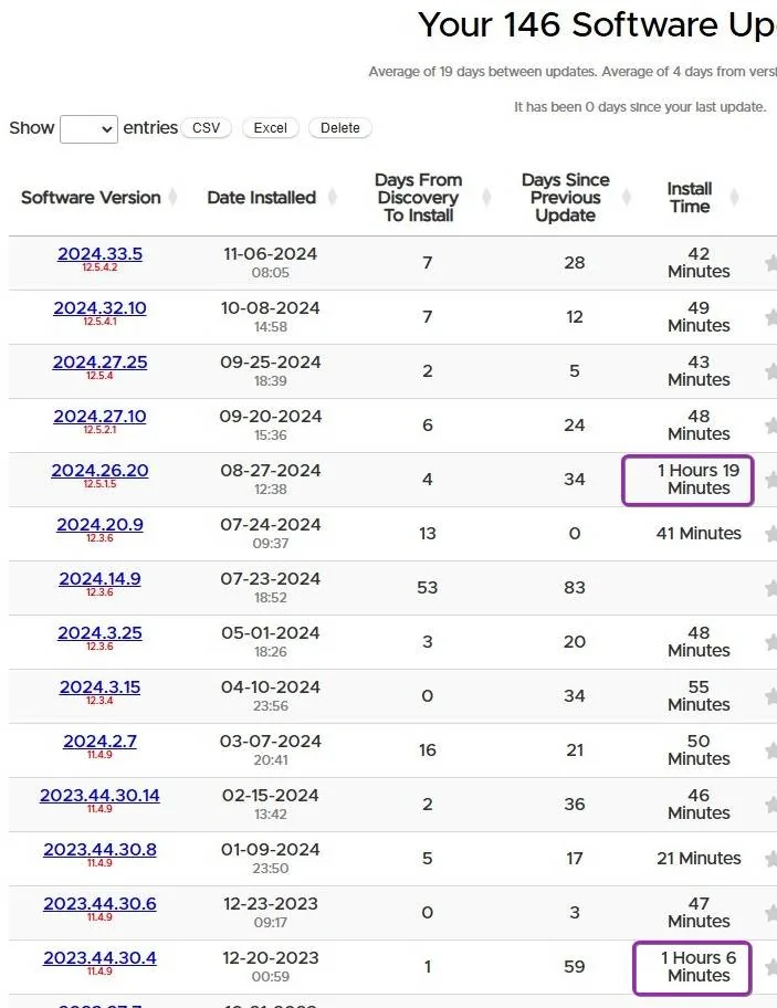

scottf200
Jul 31, 2021
53
2,221
3,241
Western NC
X; immed family 3 & Y
Thanks…yes I’m going to chill I’m sure it’ll be fine…Forgot it wasn’t that uncommon to run into hour long updates every once in a while. I’ll give her 3 hours before I worry. Thanks for reinforcement!
In my Tesla Model X, a couple of 'recent' ones took just over an hour. Generally less than an hour.
