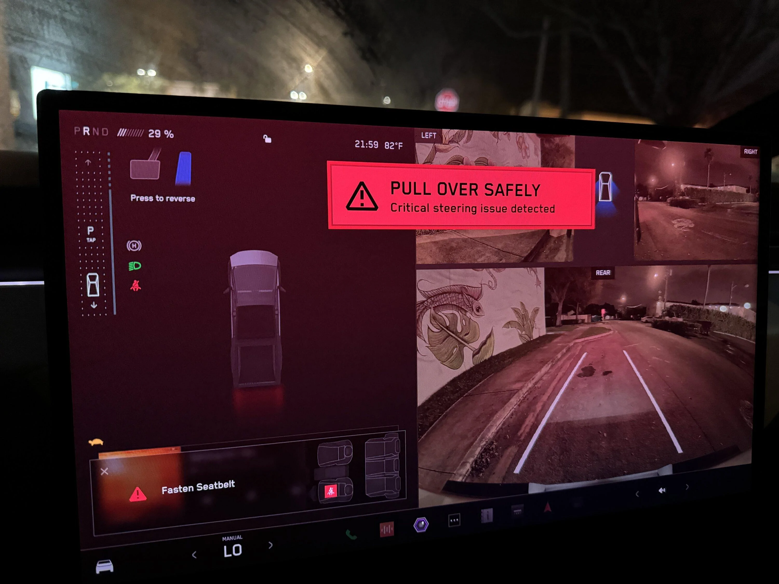

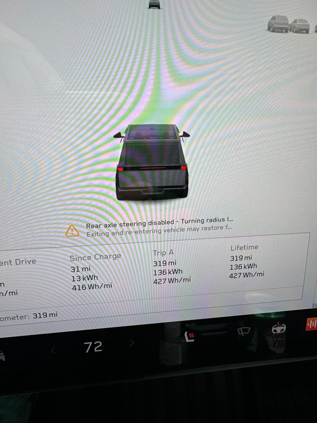

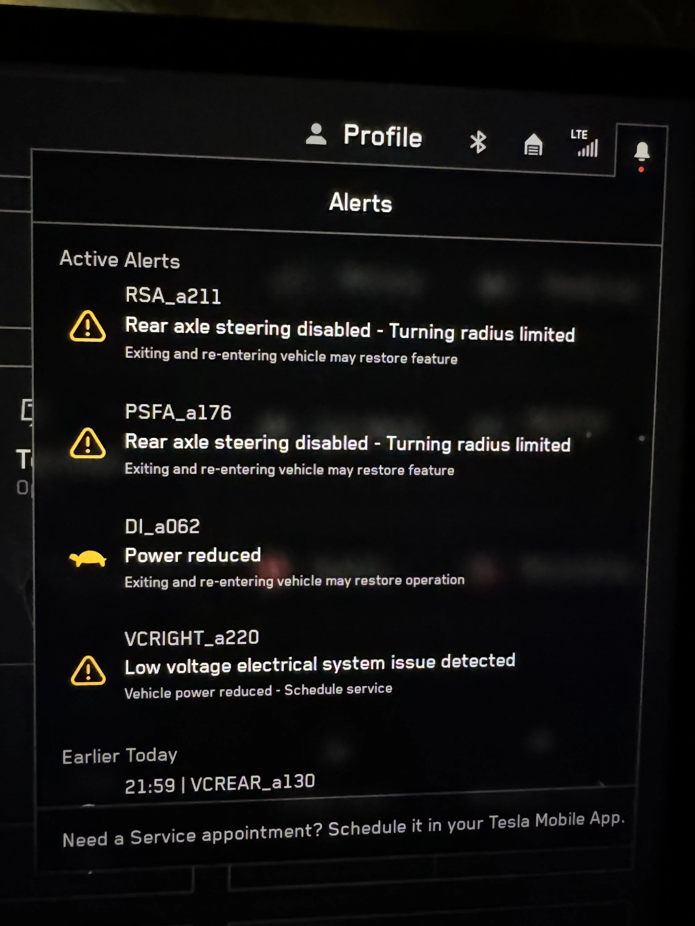

I got this error today while driving down to Florida from Pennsylvania, unfortunately it happened right as I was getting on the highway. I was able to pull to the side of the road safely and exit walk around the car and get back in. The notification went away upon doing that. I also got the error with the rear axle and turtle mode. Everything cleared after Reese entering the car I did a screen restart as well just to be safe, it seems to be OK right now. I called Tesla emergency hotline and they told me if it happens again. I can just pull into a service center driving down south. I had my Starlink refrigerator and a wheelchair charger in the trunk all plugged in so I unplugged a couple things. I wonder if it’s that.
Here’s what service mode showed
If your loads were on the bed outlets, they should not have triggered LV errors. 48V powered accessories might, but the vehicle should theoretically drop those if power generation is limited.
It may be that one of the two DCDC converters that turn the HV into 48V had a momentarily issue.
