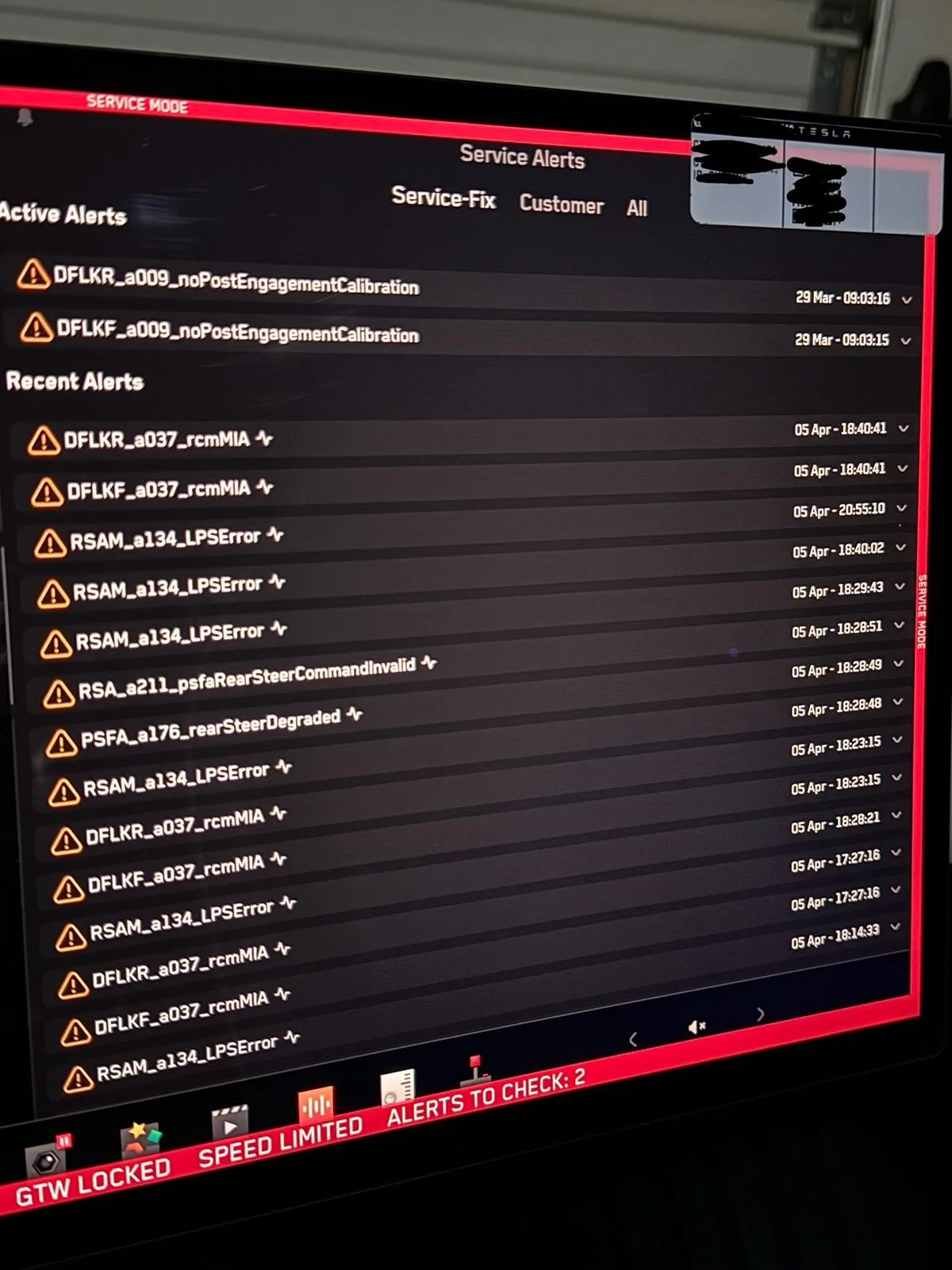

you are correct. there are lots of other errors triggered today. most have to do with sensors and the failure of them not talking to other components.

See above. I initially looked at the notifications, but then went into service mode and saw the others. lol!

oh jesus lol. I would ping tesla with all of those errors. At least if they aren't something to worry about they can tell you that. I don't see anything specifically worrying in there but that's a lot

A service representative called me this afternoon and told me that majority of the errors are just phantom mis-signals nothing to be concerned with since it’s a new vehicle and they are monitoring this.
The rear steering air error is a concern, but he said mine was because there is a check prior to that command and that it did not initiate prior. However when I closed the door and reopened it cleared and is fine.
He told me it’s something to keep an eye on, but nothing I need to take the truck in for yet.
He also confirmed that they are just monitoring all these issues/mis-fires and will address with firmware updates.

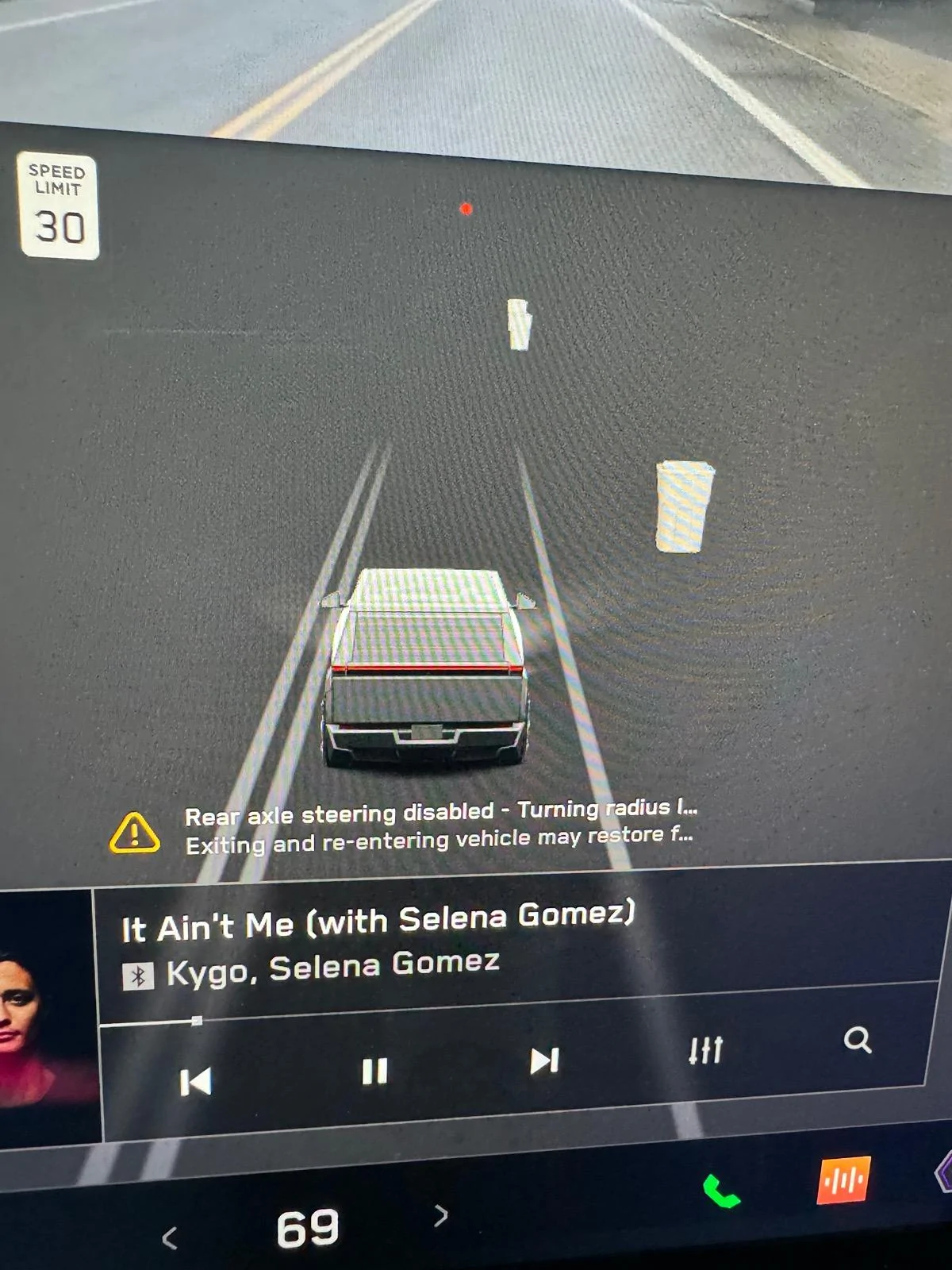

Ive got the same error on my 2nd day of owning truck. Seems to only happen when I accelerate fast, but doesn't reset until next trip. I have a narrow driveway, so not a fan of losing my rear steering unless I drive like and old man.
