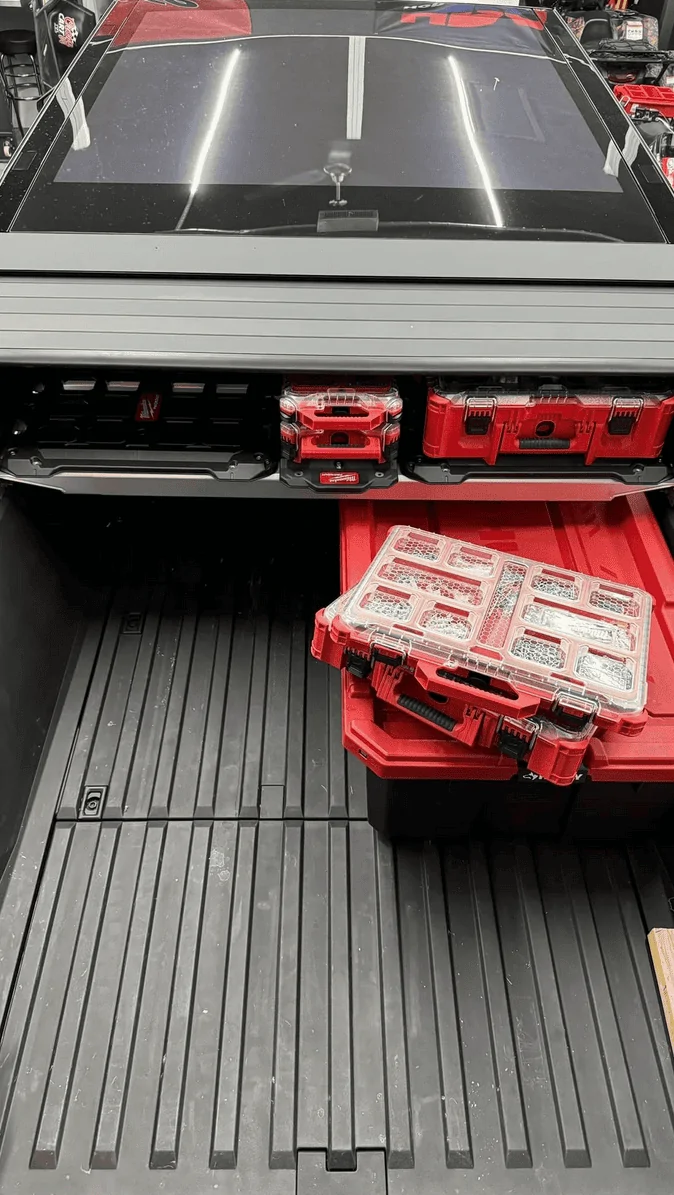

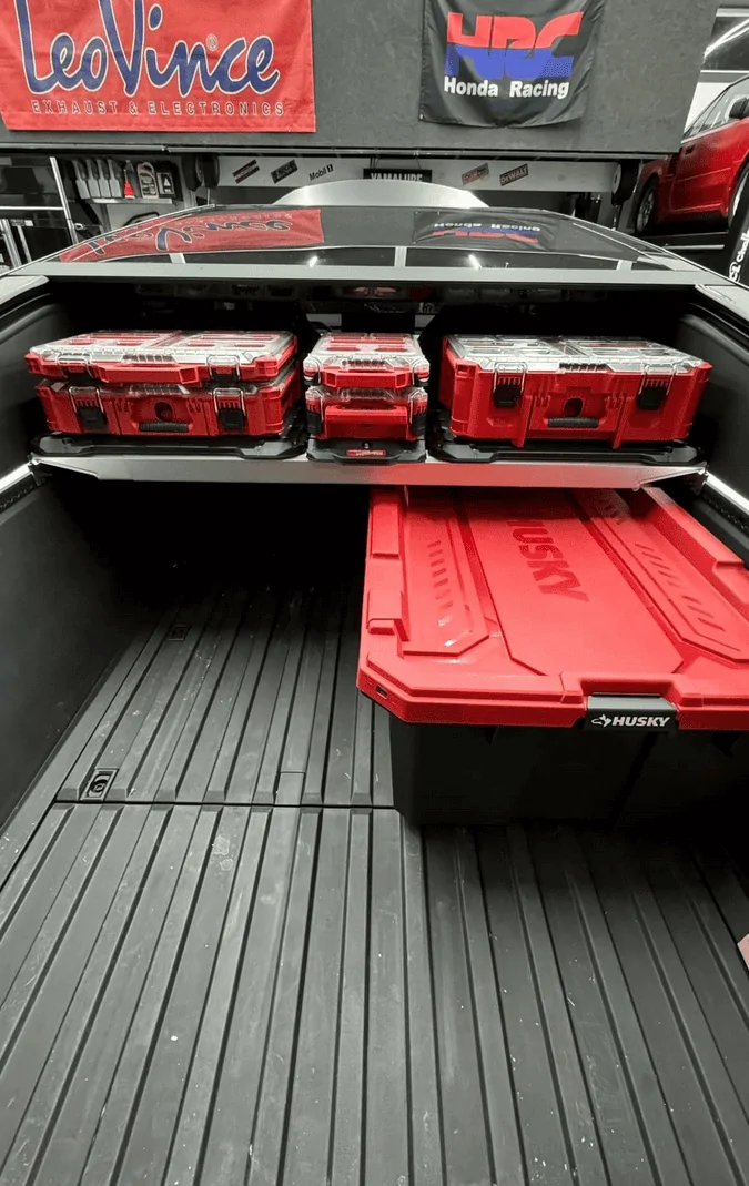

This guy did an amazing Milwaukee packout rack build for his bed, completed with a shelf.
"Off the shelf parts just bolted together...All can be found locally as well at IKEA and Home Depot other than the L-Track studs.

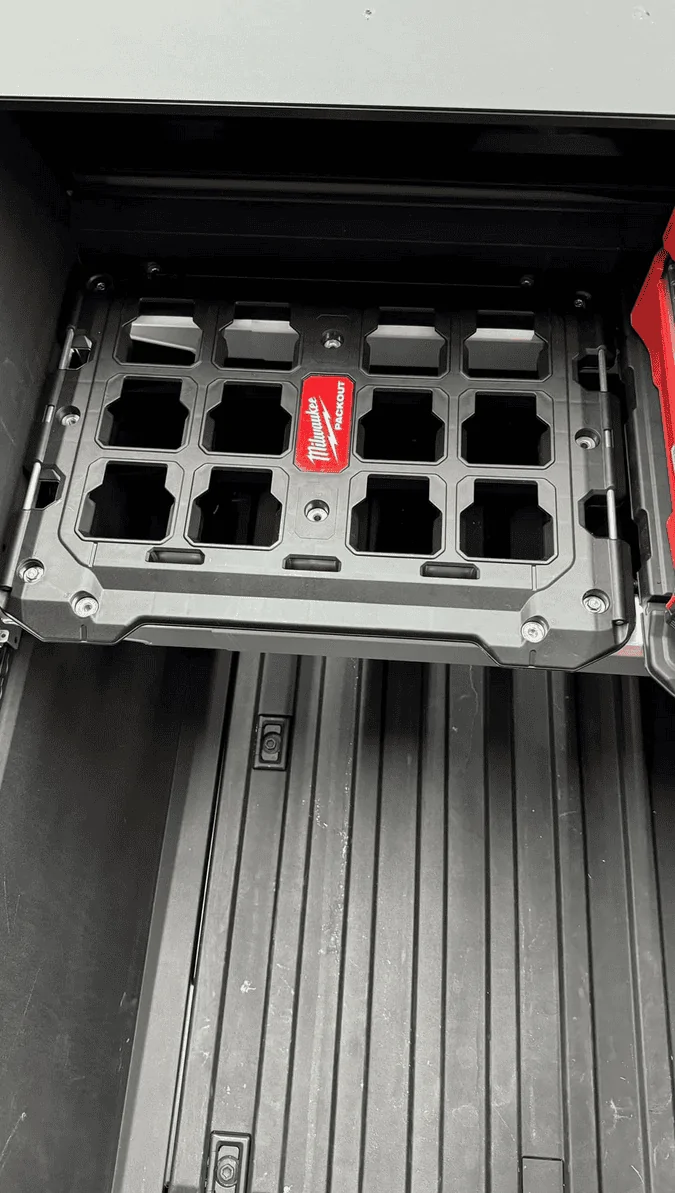

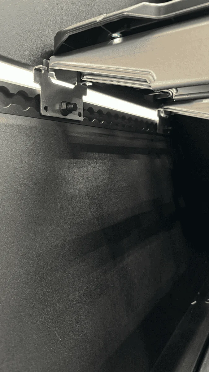

IKEA Bed support beams, brackets and some L-Track Studs. Just had to drill out the holes in the bed rail brackets to be big enough for the studs. Then mounted the Packout plates with some nuts and bolts.
You can just lift it out if you need the bed space and the brackets will stay on the sides."

Great use of the space, love this!

This idea is EXACTLY what I’ve been looking for. Thanks for the post and parts list !

I just bungee my Packout but it doesn't get me any more space back. That looks great.

This is pretty cool. If there was a way to make a sliding rail so you could pull it to the end that would be very cool. There's probably a better option but maybe a garage door rail? I have the Stack tech system. I thought these systems were goofy when I first saw them. I was wrong, they're very useful.

Have you tried putting the standard size packouts in the frunk.

Did you ever try standard size packouts in the funk? Looks like you might be able to fit two side by side up there.
