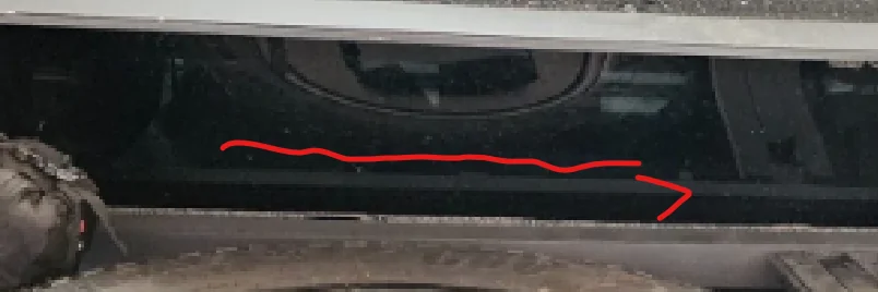

seems minimal, but OP please provide a level photo showing the obstruction

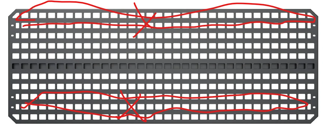

again, cheap shelves with no max weight spec, i'd avoid

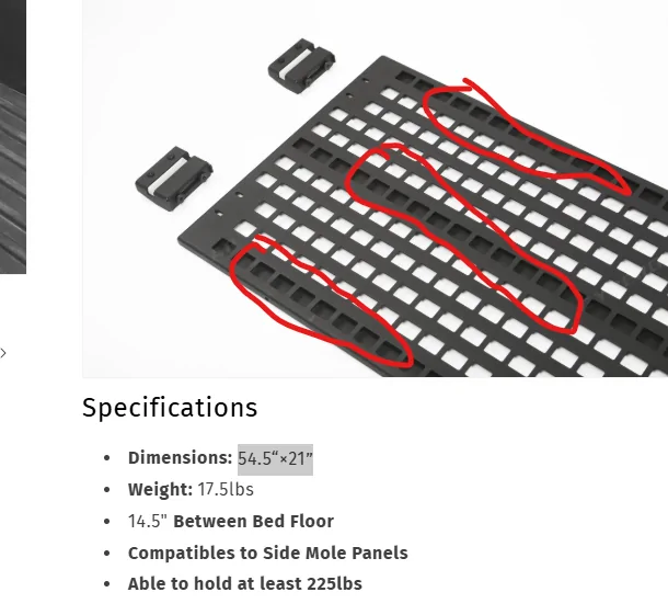

then the main sellers of Cybertruck items $500+
and then cybergearco with 225 lb spec and a unique design of an underframe
at $319 seems to be the best choice

That looks like the shelf I used.
Def need the three bars underneath
Considering these are only 22” deep with a 35” tire, 6.5” overhang on each side creates edge torque

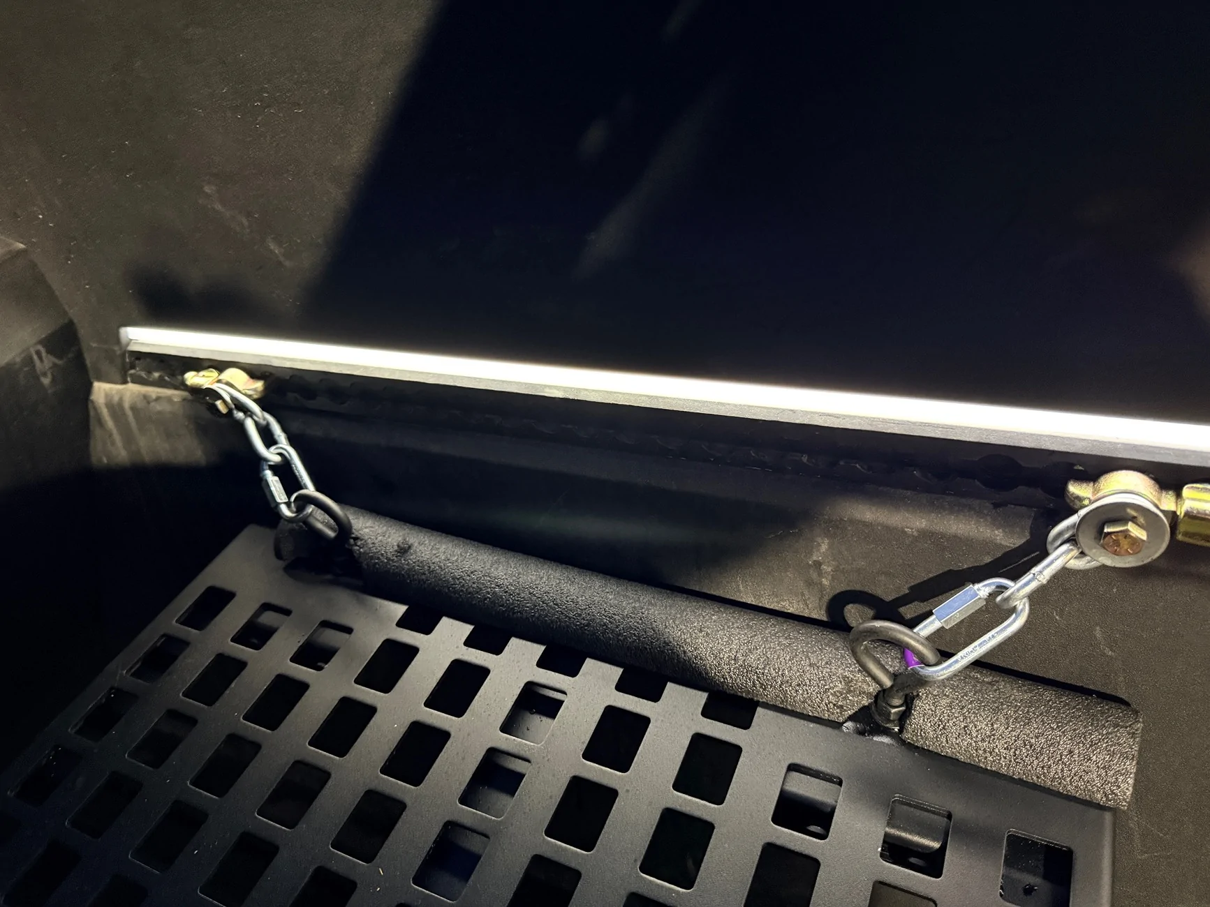

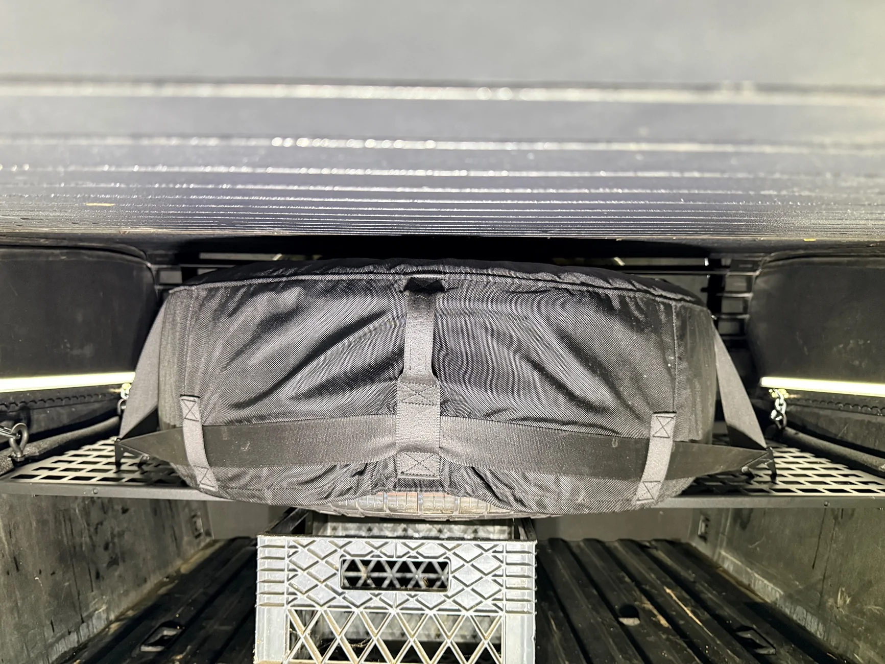

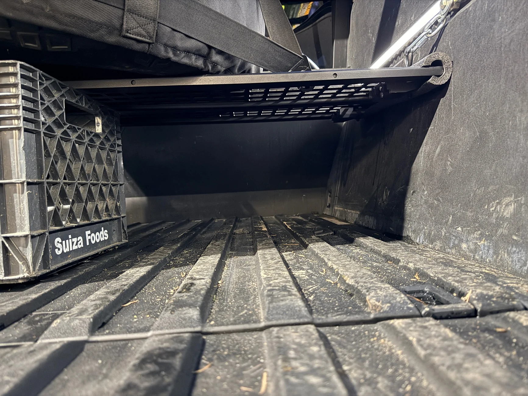

My take on this idea. I used L track fittings that had a threaded boss (3/8 fine thread), some chain, eye bolts and the molle shelf off Amazon. It has 11 inches under the rack and I put pipe insulation on the sided to prevent scraping. It does not swing. L track amazon link.
For the eye bolts to add extra strength, I mounted the attach brackets that come with the molle panei to the under side and drilled through both and tapped the hole to 3/8 -16. Worse case scenario is the eye bolts bend and the rack drops slightly. @Fabville provided the color commentary to encourage the upgrade from my original less appealing prototype.
