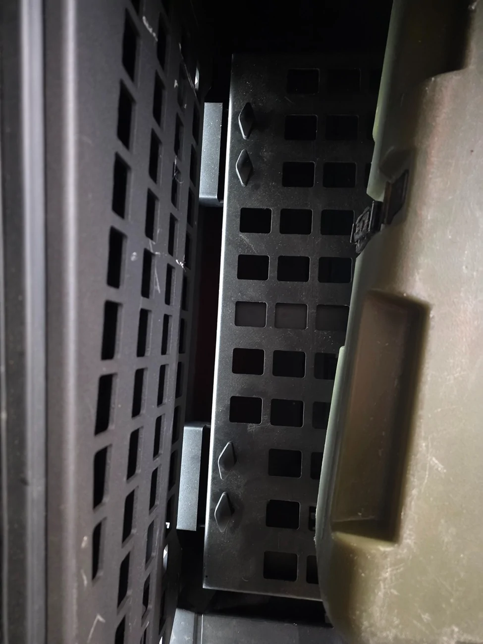

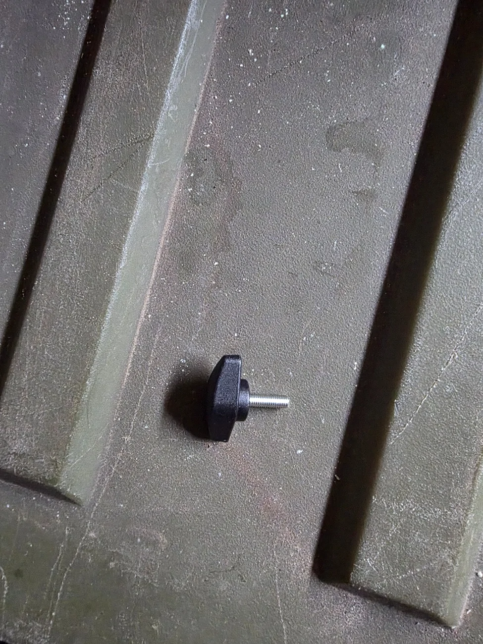

I got one of the horizontal molle shelves but hated that it was held on with 8 star bolts. If I needed the whole bed for something big, I had to find the tool in my tool kit and then get the stupid things out.
I found M5 X 16mm tee bolts on Amazon and no longer need a tool to take the shelf out if I need the whole bed to haul something. These come out in a minute with no tools, and I can remove the shelf.

I’m looking to do same thing - link please 🙏

I got the last of them from Amazon haul, but they are M5 tee bolts, 16mm long. That is exactly the length of the bolts the shelf came with.

LOL, I just bought bags and bags of those off Amazon for an equipment racking project. So useful. I laughed when I saw the was a business named Thumb Screw Depot Store. Hard to find in local stores around here or a super expensive per piece.

I bought 2 bags of the wrong size there for a penny each bag. One was too big, the other too long but none will be wasted.
