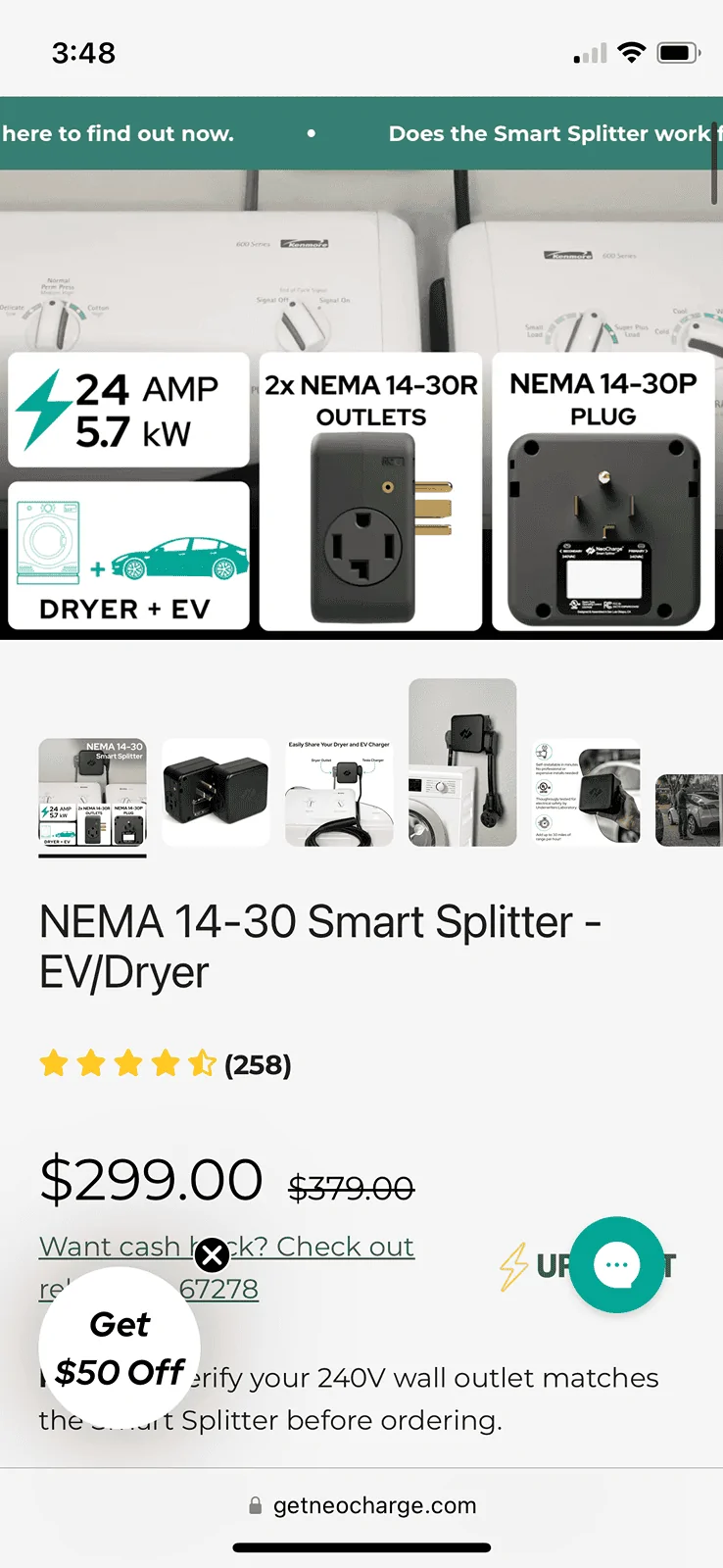

Do you have and electric clothes dryer hat a cord can reach?
No its a 6-50 that was used by the previous owner for a Kiln. I was looking at piecing together a franken extension with converters etc, but the big cost is the 14-50 (or 6-50) extension which run in the $300-$500 range. Pricey indeed.
