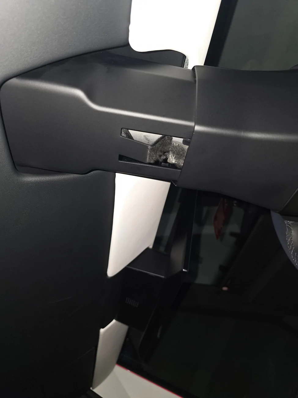

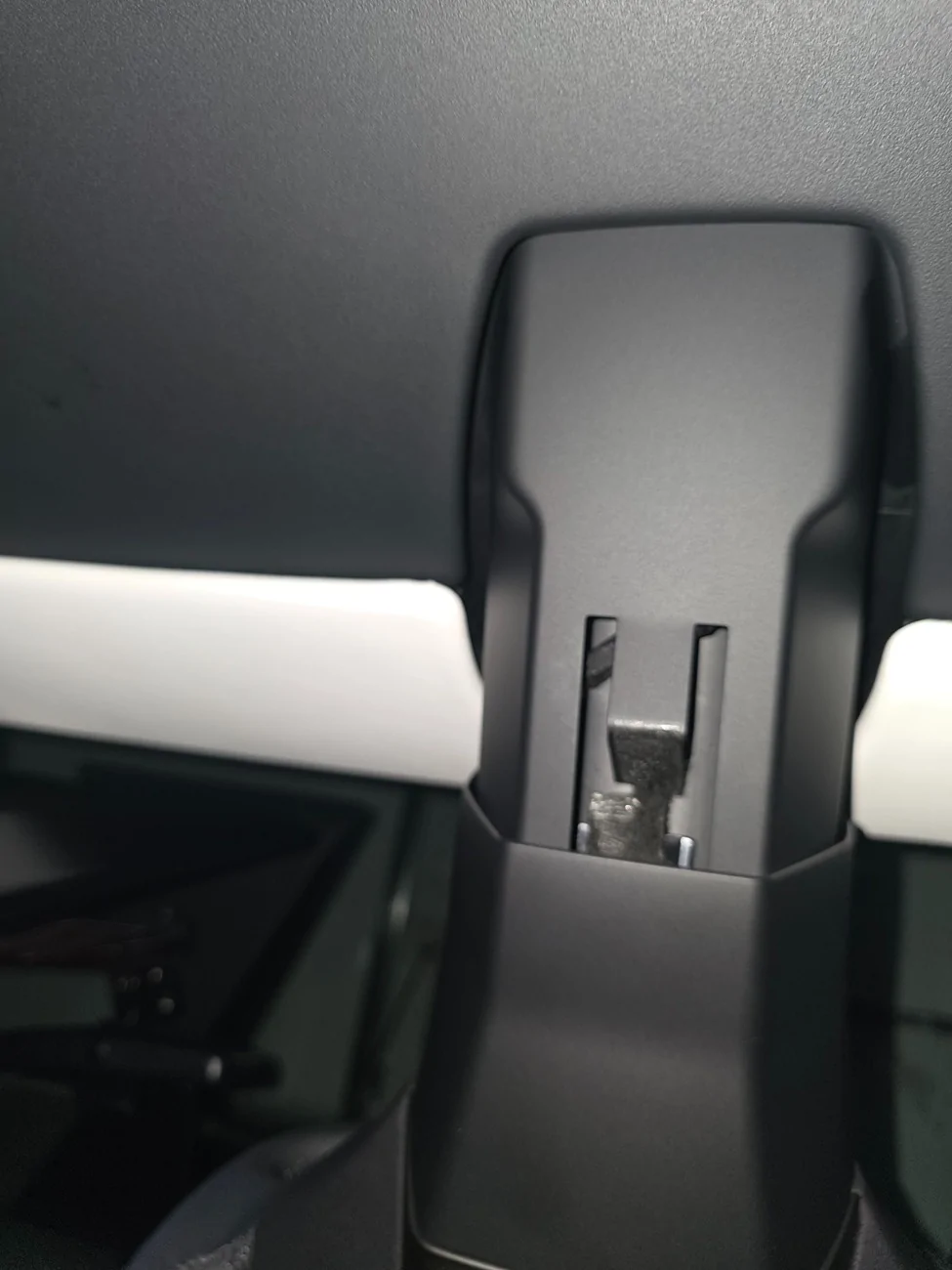

Only problem I noticed is that the steering wheel makes a click when passing 10 or so degrees past center. Sounds like plastic trim or flash that's snagging. If anyone has insight, please comment to save me the SC visit.

I had similar noise. Turned out to be a piece of plastic underneath the steering column. It was out of place and made a terrible cracking/plastic breaking noise when adjusting steering in, mostly, or out. I took it in for a service visit. They basically pushed the plastic piece further in out of the way and called it a day. Stopped the noise.

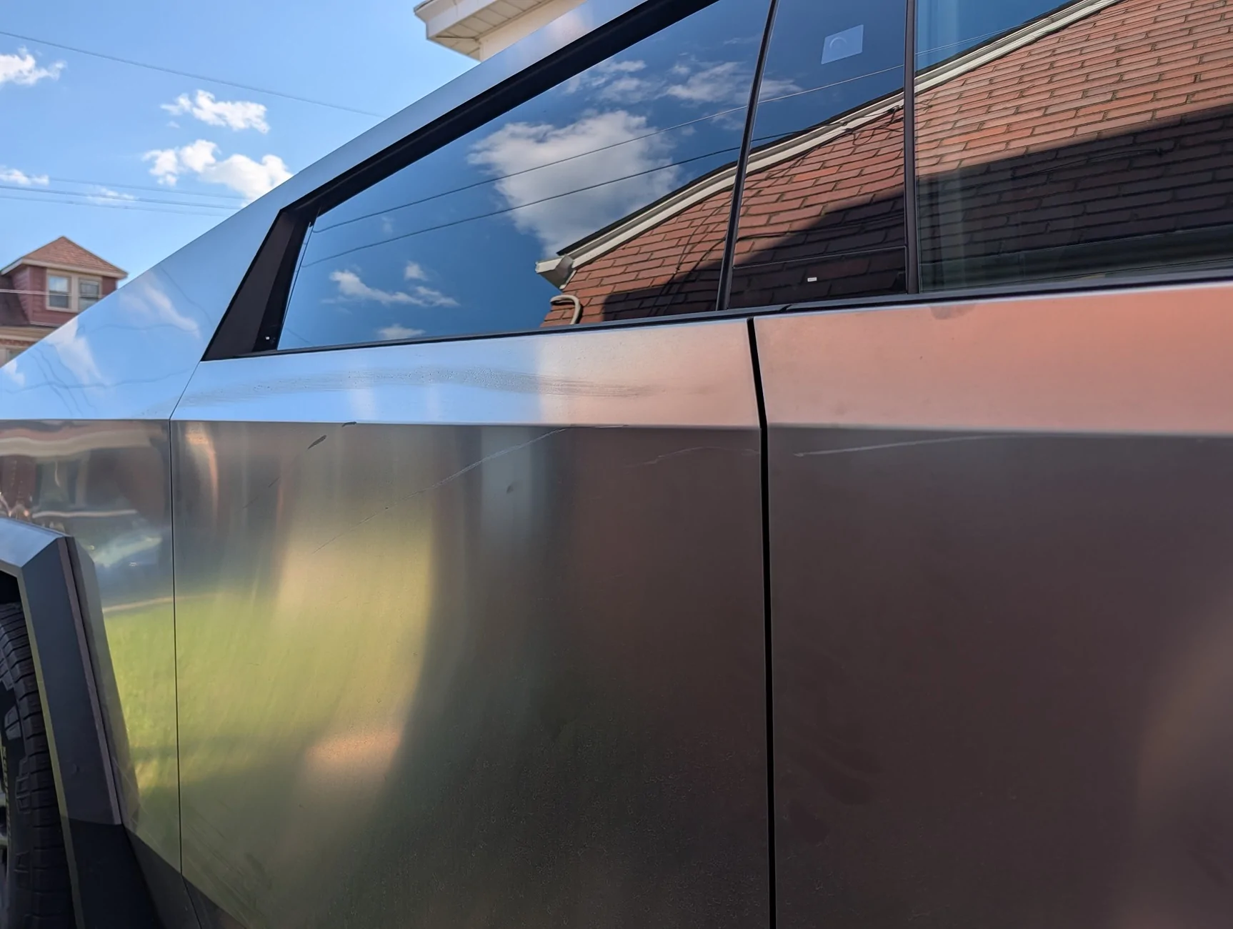

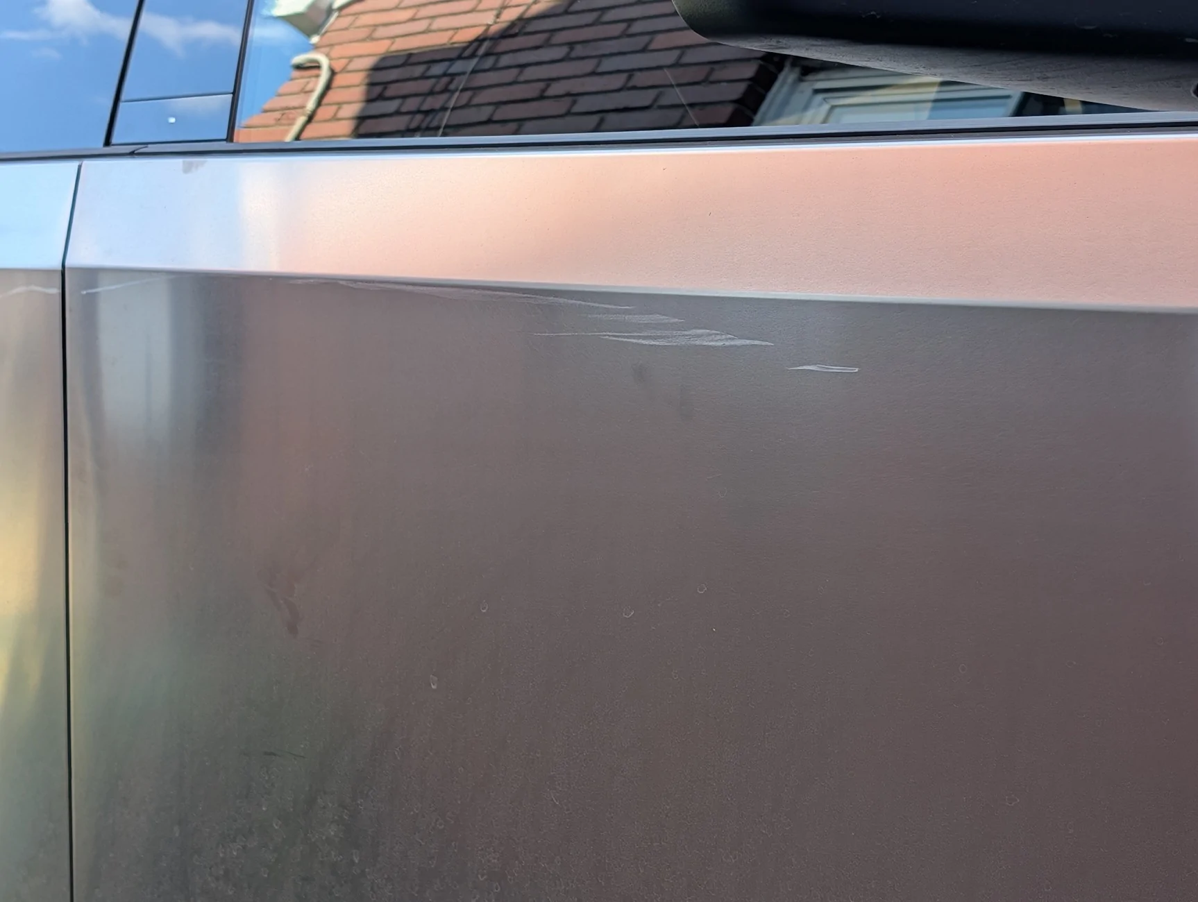

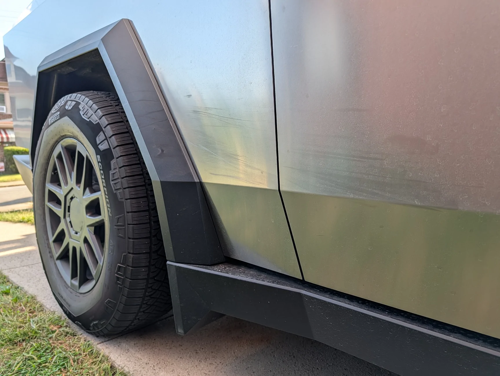

Welp, it couldn't stay factory fresh forever. Earlier today I had an aloof motorcyclist merge into the side of my CT while I was passing slower traffic (him included). I feel terrible that he got pretty banged up (luckily sub 20mph speed). I was very thankful that I had the composure to record the dashcam footage leading up to the crash. Also very thankful to have the stainless exterior, since even his metal grip guard barely left a scratch down the side of the truck (couldn't feel it with my fingernail). If I had gone with the Lightning I was originally eyeing I'd have no surround footage of the accident and thousands in paint repair that would never be factory quality. Hoping he has a speedy recovery and wears a helmet/leathers/boots in the future. Could have seriously reduced his injuries :confused:.

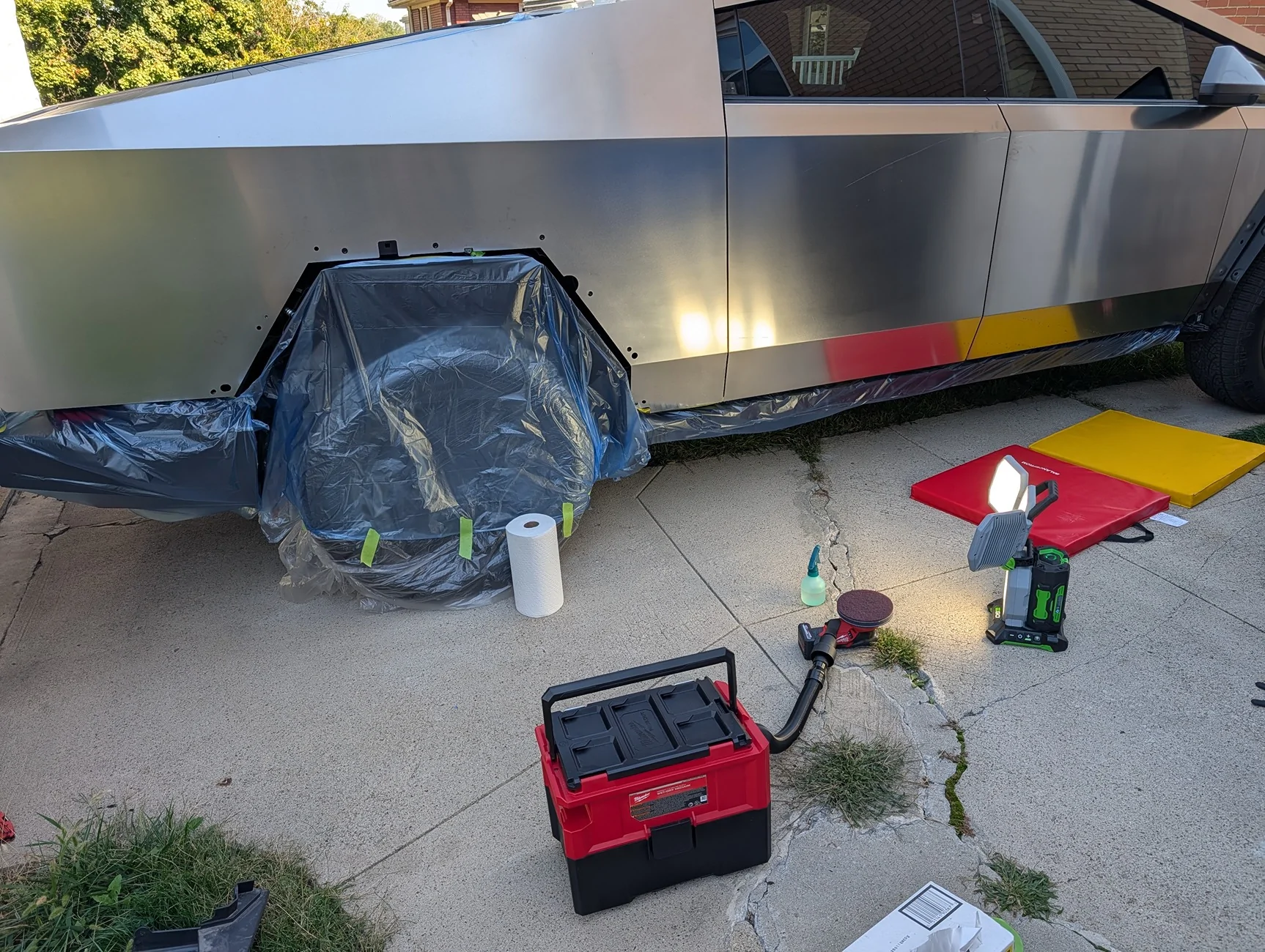

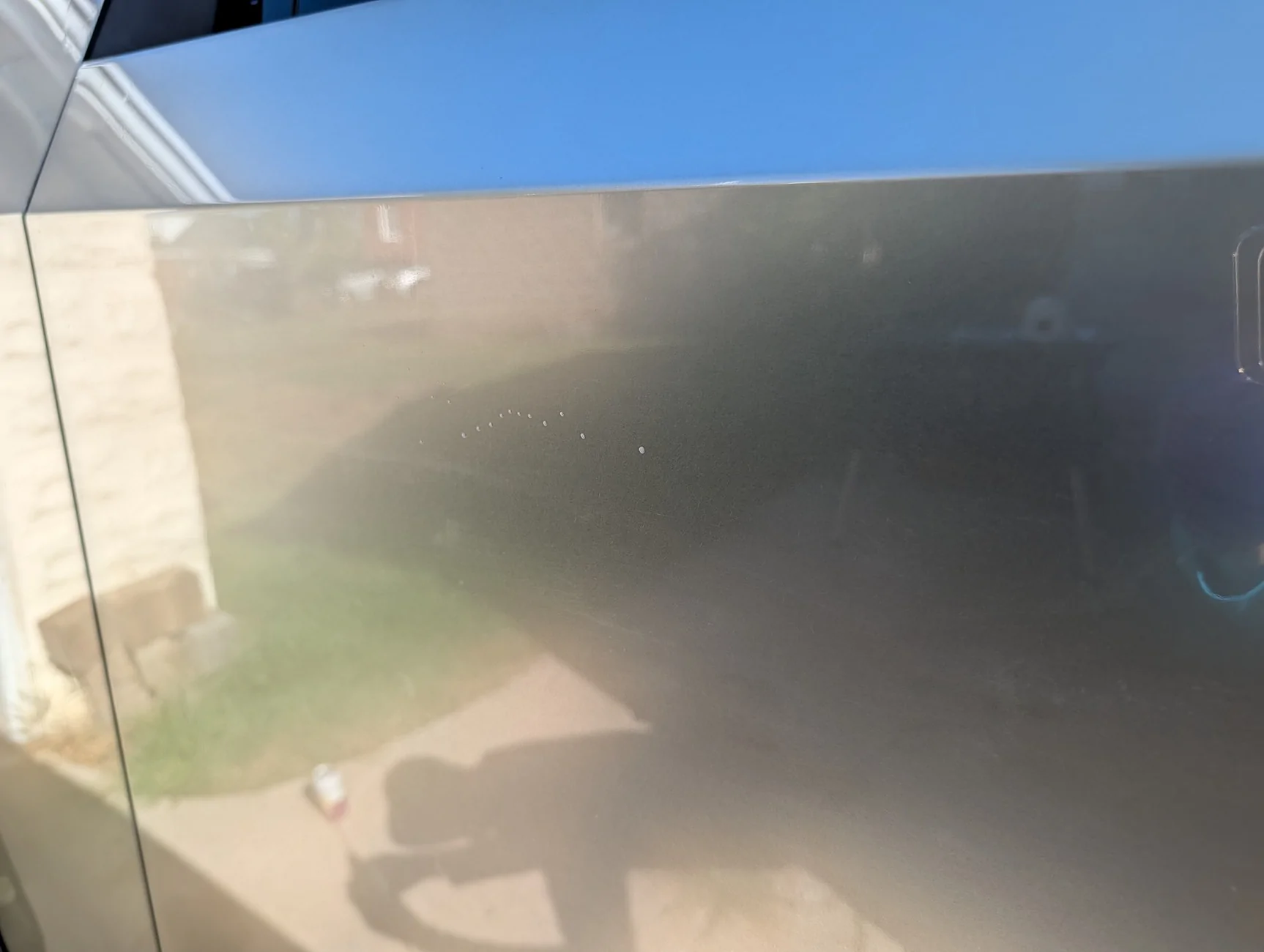

Decided to avoid using insurance since the local body shop that is "Tesla Approved" seems to be very hit or miss. Tesla spec'd refinishing discs, Milwaukee M12 6" RO Sander, 3M Soft Interface Pad, passenger mirror cover, and rear passenger fender flare are all coming by this weekend. I'll try to make a post and video of the refinishing process. From the looks of this video, though, I think I'll be fine. I've polished tarnished stainless to mirror and then brushed finish when refinishing our dining room chairs.
Video:
Tesla Refinishing Guide: https://service.tesla.com/docs/Cybe...UID-D33D78C9-9BCD-46CB-885C-52B4F482852C.html
Pics of Damage:

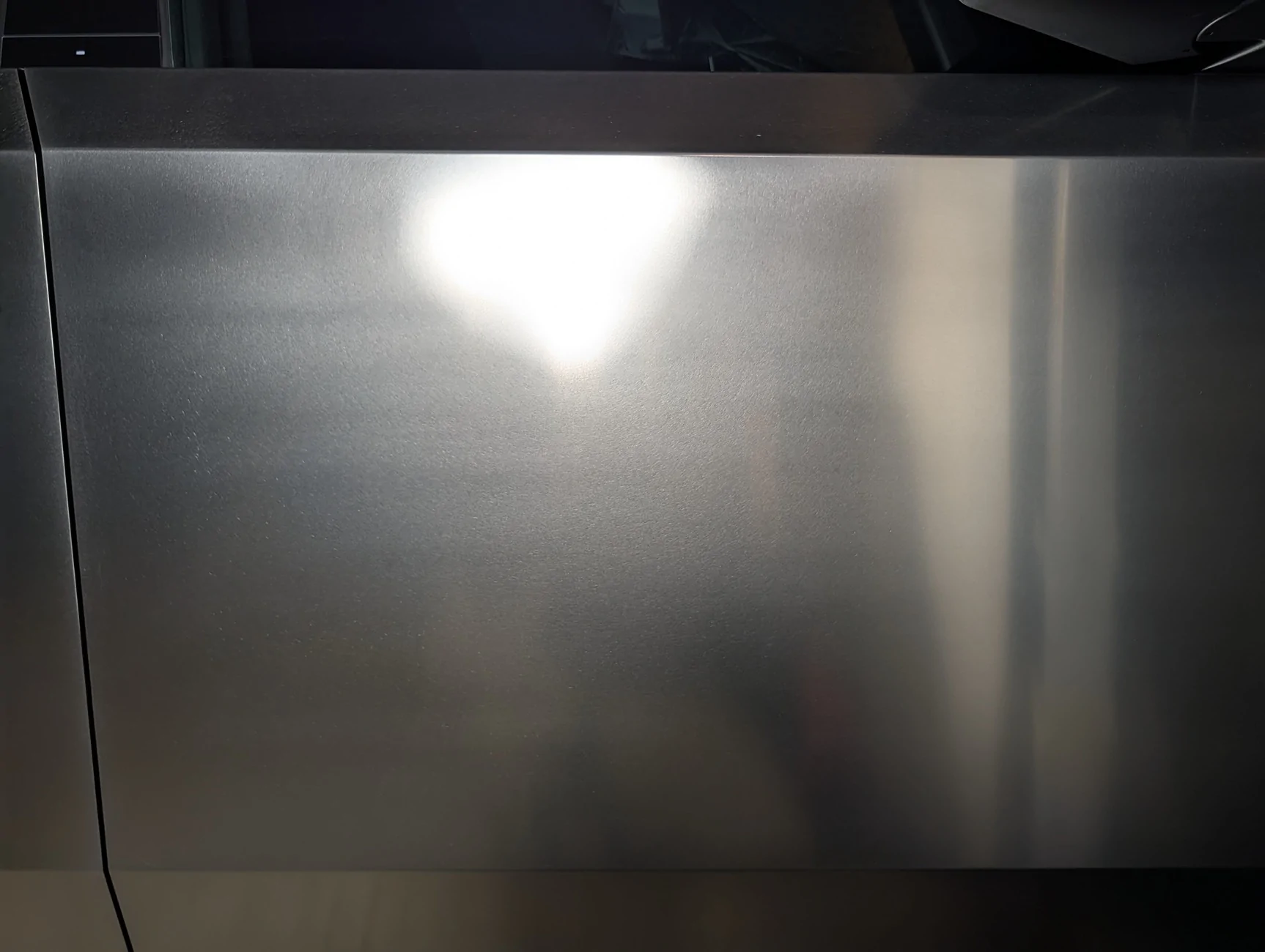

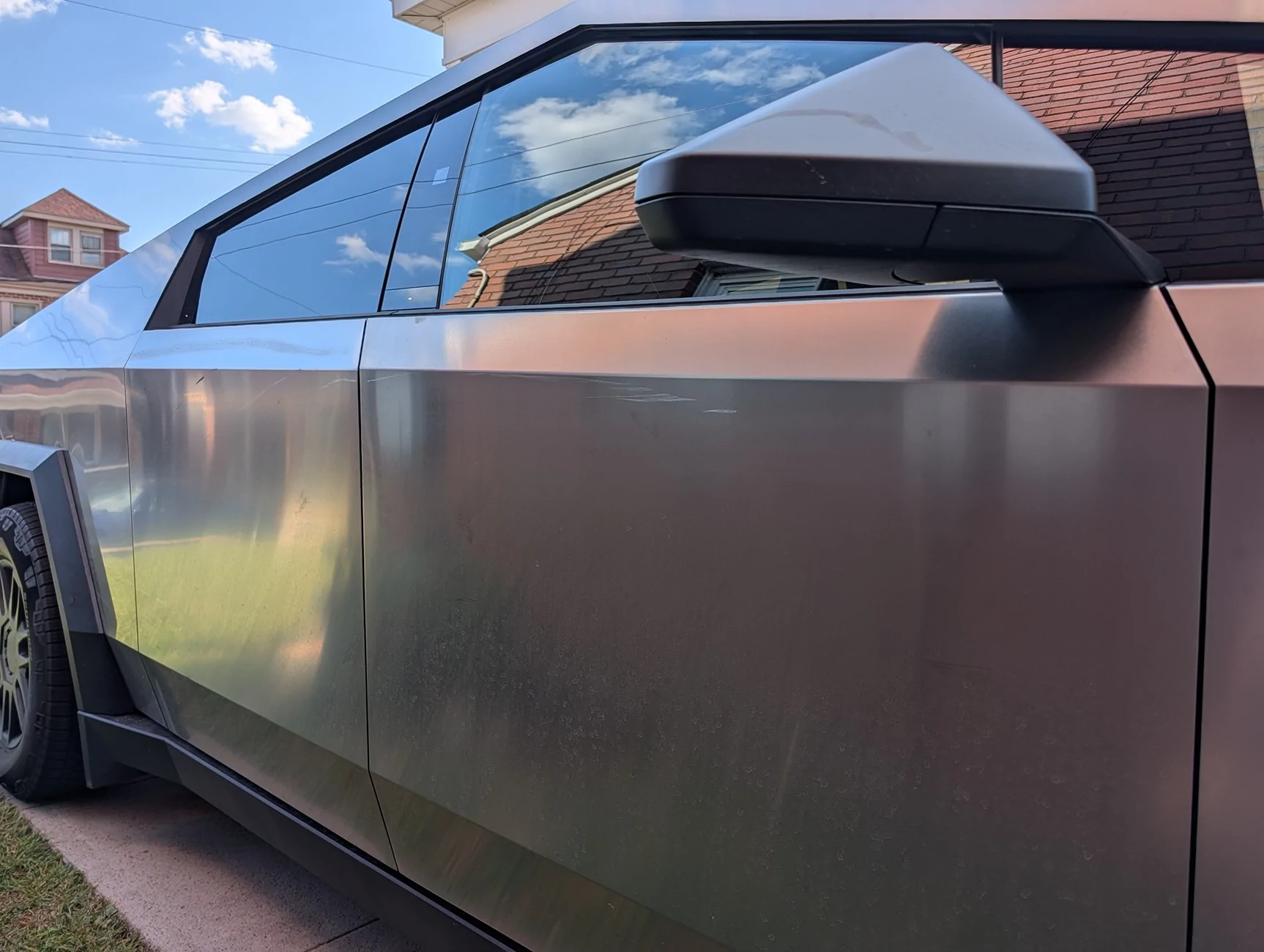

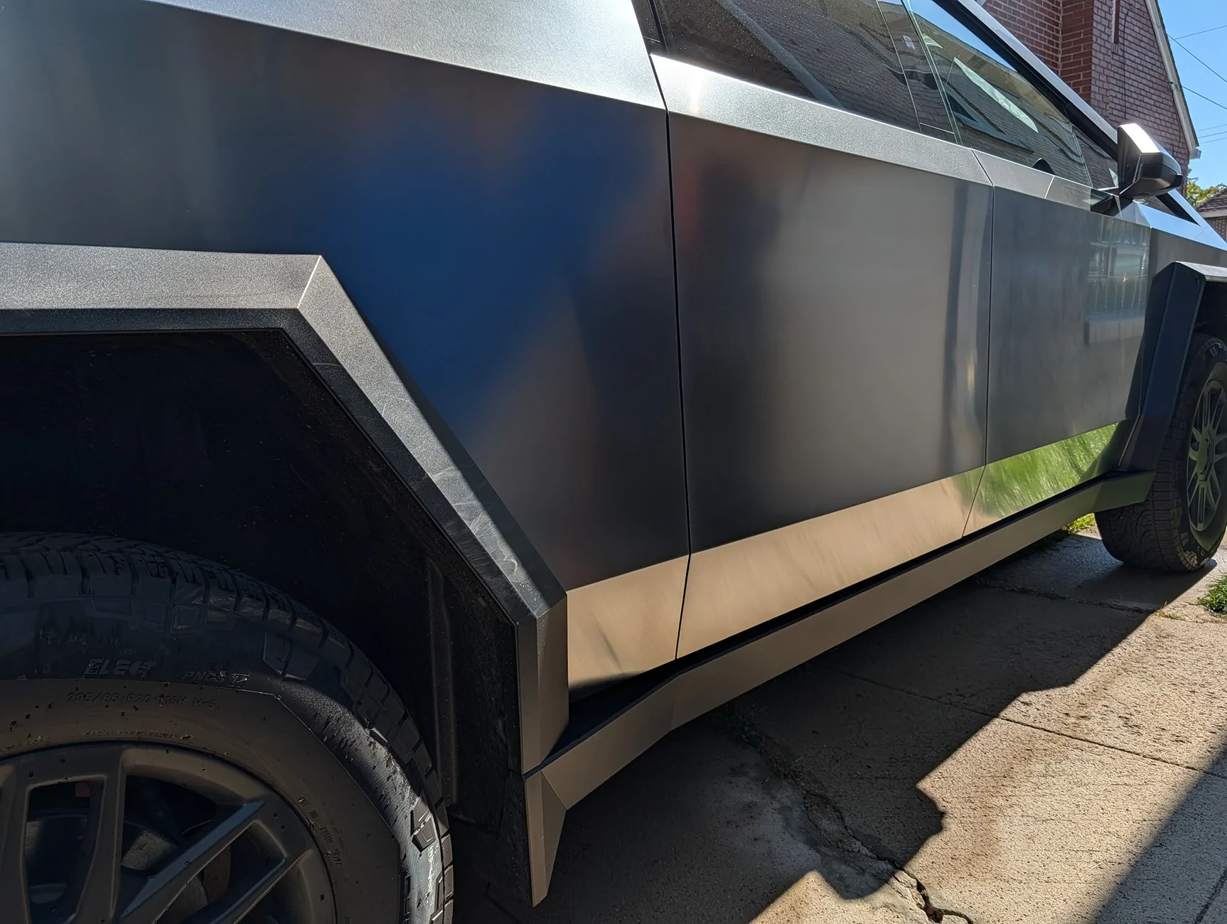

Took most of the day, but it's back to OEM, light tiger striping and all! Tomorrow I'll re-passivate the surface with CitriSurf77 and put the plastic back on. Mirror skull cap and rear fender flare shipped to my house for $150 and full manuals on how to do everything provided by Tesla without even a login requirement?!? It's a DIYer's wet dream.

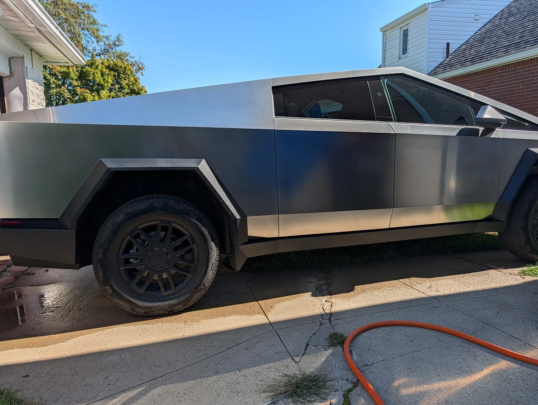

Passivated the affected panels with CitriSurf77. Kept the panels wet by basically perpetually applying another coat of the liquid with a microfiber applicator pad. Light pressure to reduce runs in case it affects the plastic trim. In hindsight, I should have degreased the surface a bit better since some fingerprints and other oils were causing the CS77 to not fully wet out in those areas. No biggie, there's always next time 😅

Just waiting on the new rear fender flare from Tesla EPS to come on Tuesday and it'll be good as new (maybe better given the finishing work I saw on other panels)

It's a bit tricky to answer. Initially all of the discs will have their maximum abrasion, but this also leads to most of the random pigtail swirls that you can see in the OEM finish sometimes. Over time, with heat/pressure/time they will begin to lose their cut and settle into a consistent finishing plateau. As long as you don't damage them by hitting irregularities or going over sharp corners, I think I could have gotten away with 1 of the fine/very fine discs and 2 of the mediums.
I think my mistake was using the medium ones for the deeper scratches where I should have used something like 800 grit sanding disc for more efficient material removal. So a 20 pack should be enough for a lifetime 🙃
