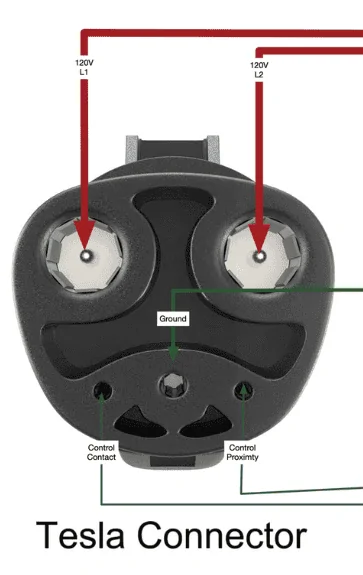

A long time ago, I asked if the car had any control over the power coming into the super charger connections. I assumed there was some disconnect, either mechanical contactor, or possibly semiconductor. People jumped all over me saying that such devices would be to expensive. Ok, fine, but if there isn't a disconnect between the battery and the supercharger connections, there is battery voltage at the charge port connection point at all times. I suppose, if water gets between battery + and - it won't be liquid water for very long. :)
Do we still believe there is no disconnect between battery and charge port? (I'm really asking, I do not know).
There is probably no "connect" at all. I would expect that the input voltage starts into a rectifier and control circuit, which then goes to the BMS. I don't believe there could ever be voltage out at the connector, that would be beyond insane. But, I will go test it myself if it stops raining here.
Electric bicycles do have direct connections, but many also have a disconnect function. It's not great, because some of the high-voltage ones like my 72V could easily kill a person. The "off" function requires you to do it manually in the BMS app. I believe that all of my lower-volt models have no disconnect ability at all.
For Level 1 and 2, yes, it would go through a rectifier. But how Superchargers (Level 3) charging works, I was under the impression the car talks to the charger and tells it how much voltage and/or current to provide, and the supercharger connection was a direct connection to the battery. Superchargers supply DC power. DC power does not need to go through a rectifier.

When you connect a Tesla to a generic charger, does it go through a rectifier? Do you have reason to believe there is a way for the car to choose the path? And if so, wouldn't that mean a "disconnect" has to be employed to switch? The most logical path is connector to charge management, and that should include rectification for protection no matter what. This is based on my electronics knowledge, not in-depth knowledge of Tesla's specific battery management.

Also, wouldn't the mobile connector be AC? The box seems way too small for anything really smart and it doesn't really heat up like a rectifier would.
Voltmeter will come out later if it stops raining. I bet neither have any voltage until BOTH talk to each other and negotiate the connection. I would also bet that the communications pins make connection last after power, and break first before power, so they can prevent arcing.

Ok, I've never taken a good look at a Tesla connector until now. I assumed there were multiple power connections, like the CCS connector. But there seems to be only two power connections (maybe three if they use the middle bottom connector as neutral).
Tesla Cybertruck New Cybertruck chargeport picture reveals special Tesla logo 1668031577749
So, yes, their isn't battery voltage at the plug. This makes more sense. The control wires must tell the car that it's connected to L1, L2 or a Supercharger and the car makes adjustments based on that.
I'll keep digging and see if anyone found specifically how.
