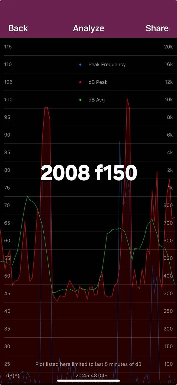

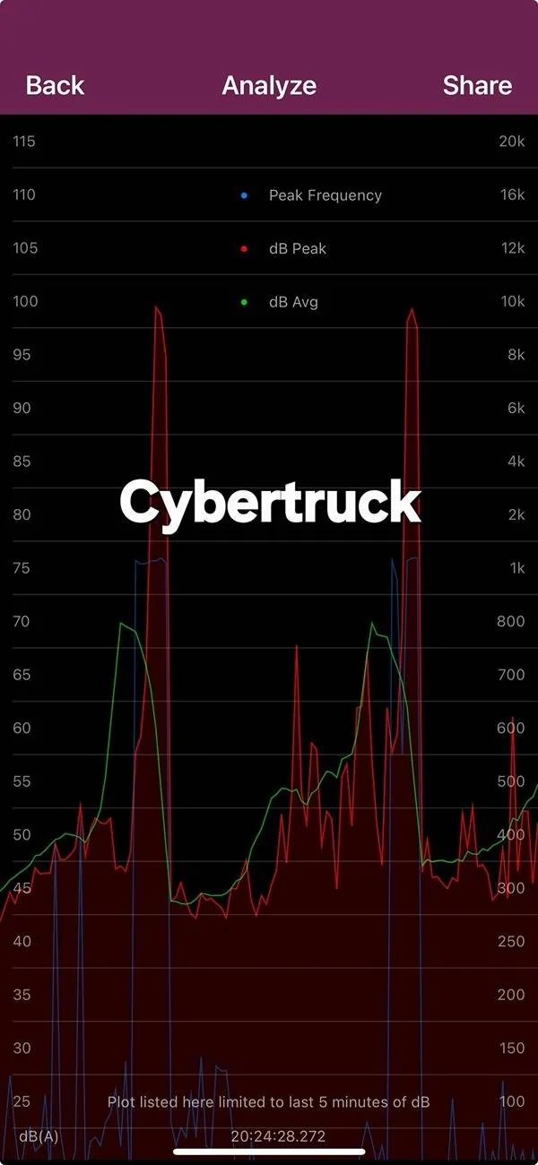

This was my mom's f150. I feel like my 2010 f150 horn is a little louder, so I'll check that later.
But these are pretty much the same decibel. My preliminary conclusion is that the lower pitch of the cybertruck horn might effect ability to hear when on the road, especially highway.

I think it's more that people aren't expecting that sound from a horn.

DarkEye measured 5 dB difference between the old and new horn.
To get an idea about how much louder that is, consider this: The sound power of three identical sound sources, heard simultaneously, is 4.8 dB louder than hearing only one sound source. Two sources is 3 dB louder.
But the new horn's frequency content and other characteristics are very different from the old one, so a simple power comparison is not directly equivalent to a subjective, "how does that compare?" aural test by a person.
