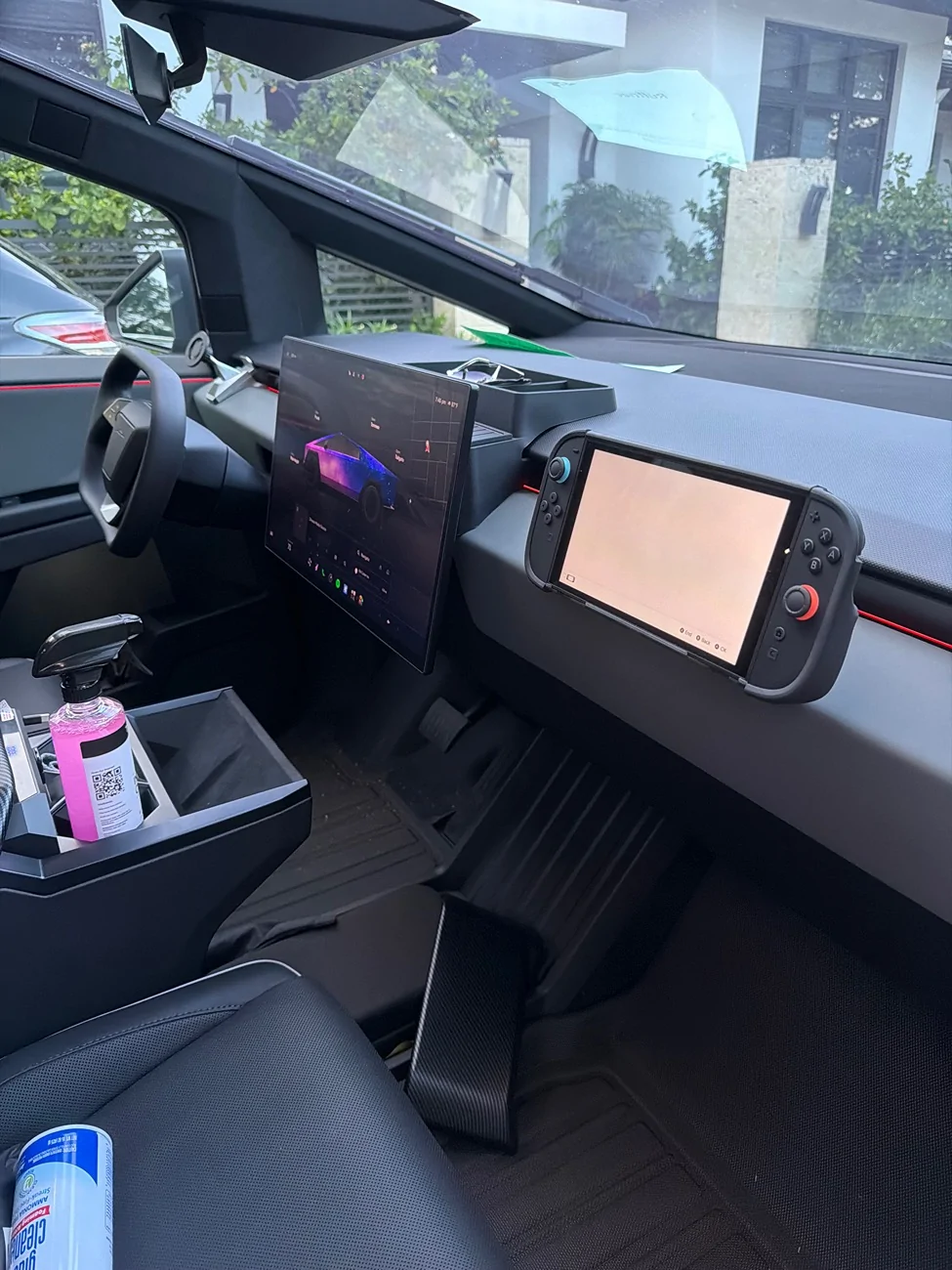

Nintendo Switch 2 on dashboard - is this unsafe?
Supernandez
May 10, 2026
Miami, FL
Cybertruck, Telluride
Tesla Cybertruck Nintendo Switch 2 on dashboard - is this unsafe? IMG_0602
I added a MagSafe phone holder so it’s just attached by a magnet. I worry this will interfere will airbag deployment though.
dpoll995
Mar 15, 2025
211
369
cybertruck
It probably won’t interfere with air bag deployment but it can turn into a flying projectile from the air bag knocking it off the magnetic mount.

Agree a bit, if ya don't mind a Wii flying at ya at 100mph in microseconds then it's fine. Kind of dangerous is think as never plan for accidents.

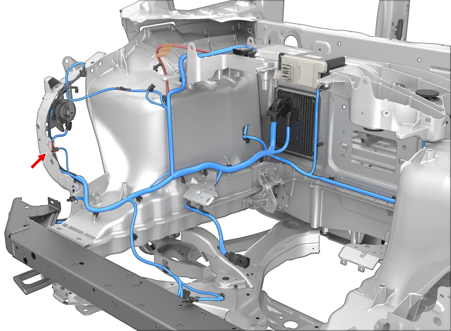

I have two iPads on the driver side(one behind the steering wheel) and a monitor on the passenger side. The airbags will make them projectiles but only if you're involved in a frontal crash that is severe enough to push the (radiator?)inwards. Steel bumpers can help prevent the radiator from hitting the trigger switch behind it in most cases.
May 27, 2024
4,521
5,499
While there are sensors in the front, they sense acceleration not direct contact with the sensor. The main airbag control module is mounted in the cabin and also reacts to acceleration events.
Radiator is not located in front of the sensors, it's below/ behind the cross beam.
A steel bumper may increase inital impact force and thus increase the likelihood of airbag triggering.

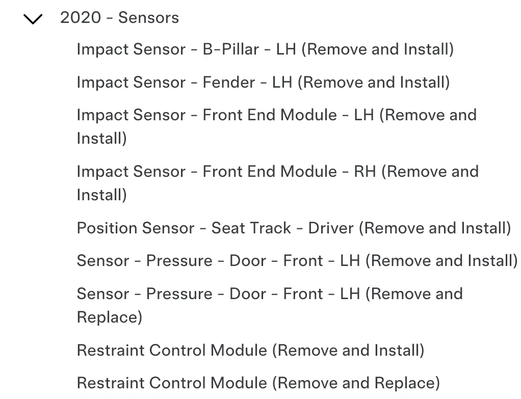

That's an interesting edge case. I have no insight into Tesla's internal software functionality, but it seems like the door pressure sensors would be drop immune. If you tipped into a rock though? 🤔
